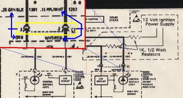

UPDATE- My Resistors go to my Bose head unit wires Orange and White/Red stripe...
Who would of thunk!
HOW-
I had Two Gry/Blk wires on same connectore- after the harness to bose h.u. 1 goes to orange, 1 to gray...
If you zoom in and look at the diagram given in the FAQ's you can see where the connectors go into the bose-
One says ORN (orange) -it goes out to a Gry/Blk wire!
(my other Gry/Blk wire goes to Gray- so i put the resistor on ORANGE.)
The other one said WHT/RED (White with Red stripe) - Goes to PPL/WHT (Purple/White!)
Since I had 2 Purple/Wht -I followed the one to WHT/RED and hooked up the resistor!
The only thing left is finding out which one has the switchable power...
I may just run a new wire from the fuse box for now- At least I'll know if it works, and if all this trouble was worth it!

Old 08-24-2009, 07:03 AM
jeffp1167
jeffp1167's Avatar
Member Since: Oct 2008
Location: Yucaipa CA
Posts: 4,689
Received 4 Likes on 4 Posts
here is all you need. this pigtail plugs into the cdm wires and bypasses the cdm completely without hacking any of the origuinal bose stuff.
This will get power and everything to a aftermarket radio. this was in my 1990. I think by going through the connectors you are you are still rlying on the problematic cdm.
