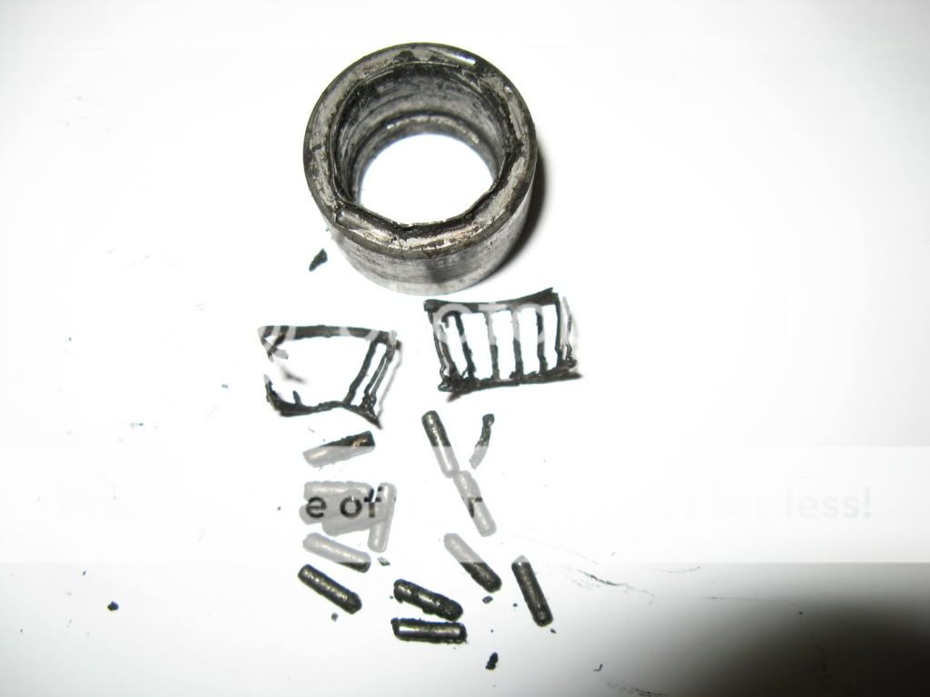

I went over a friend’s house today to install his flywheel and remove and install the pilot bushing.
This is what I removed from his crank. Lucky for him it did not tear up his input shaft.
This is why I only use a bronze bushing!

Can't argue with that picture. I've never used a roller bearing and never will. I see no advantage to them. Only dis-advantages.

When in doubt, do as the engineers did. They knew about pilot rollers when the C-2 was designed. They also knew, the C-2 design was a little too loose to use something as precise as the needle roller!
Nothing wrong with the right bushing!

Joe, that picture speaks volumes. I only use the solid bronze bearings, never had any problems ever with those.

Pretty substantial evidence to avoid roller pilot-shaft bearings. I tried one when I first reassembled my car and because I was having some transmission problems and had to remove it several times, I discovered I couldn't keep the bushing in the crankshaft - it was always loose. Finally gave up and went back to bronze before it could mess up.

And how many times in the past have I said that the above photos are why I do not and will not use the roller pilot bearing???????
Below is what can occur to the pilot of the input shaft when a roller bearing fails.

[QUOTE=Curious - Vet65te and Plaidside - did you both dial indicator check your bellhousings for radial runout as they suggest? My assumption is you probably did and it apparently makes no difference.[/QUOTE]
I took this out of my friends 69 Camaro. He had someone put an engine in his car over 15 years ago and he said they put in a new clutch at that time.
Funny thing, he had severe clutch chatter and a noise when the car was in neutral at idle that sounded like a bearing. It went away when he depressed the clutch.
From his description I thought it was a front transmission bearing. So while the trans was out he brought to me and when I disassembled it and I could not find the cause. I rebuilt it anyway just to be safe.
So I wonder if this bad pilot bearing could be the cause.
I will help him next weekend to install the transmission and see if his problems are solved.
I sell new clutch kits in my store and I notice they all now package only the needle pilot bearings. So I keep the bushings instock.
