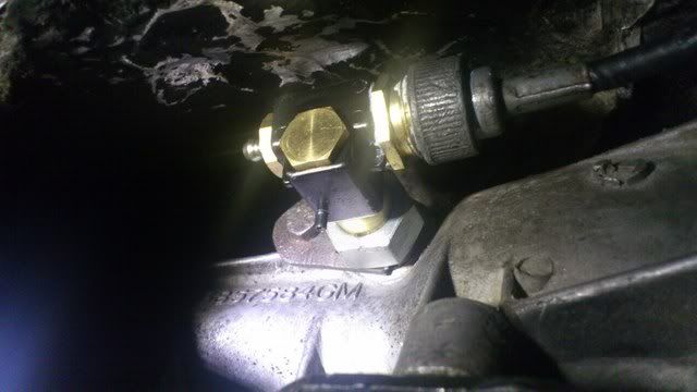

If you get a 90´ adapter on the tranny It's a piece of cake to lube the cable as mentioned earlier , no need to remove the cable from the cluster
Get a spare adapter for the tach when you lube that cable and remove it when your'e done.
I had a "whirring" sound and a jumping needle in my tach and 1 shot with a grease gun was enough.

Who sells that adapter?
I think most vendors have them but I got mine from here , more info here
