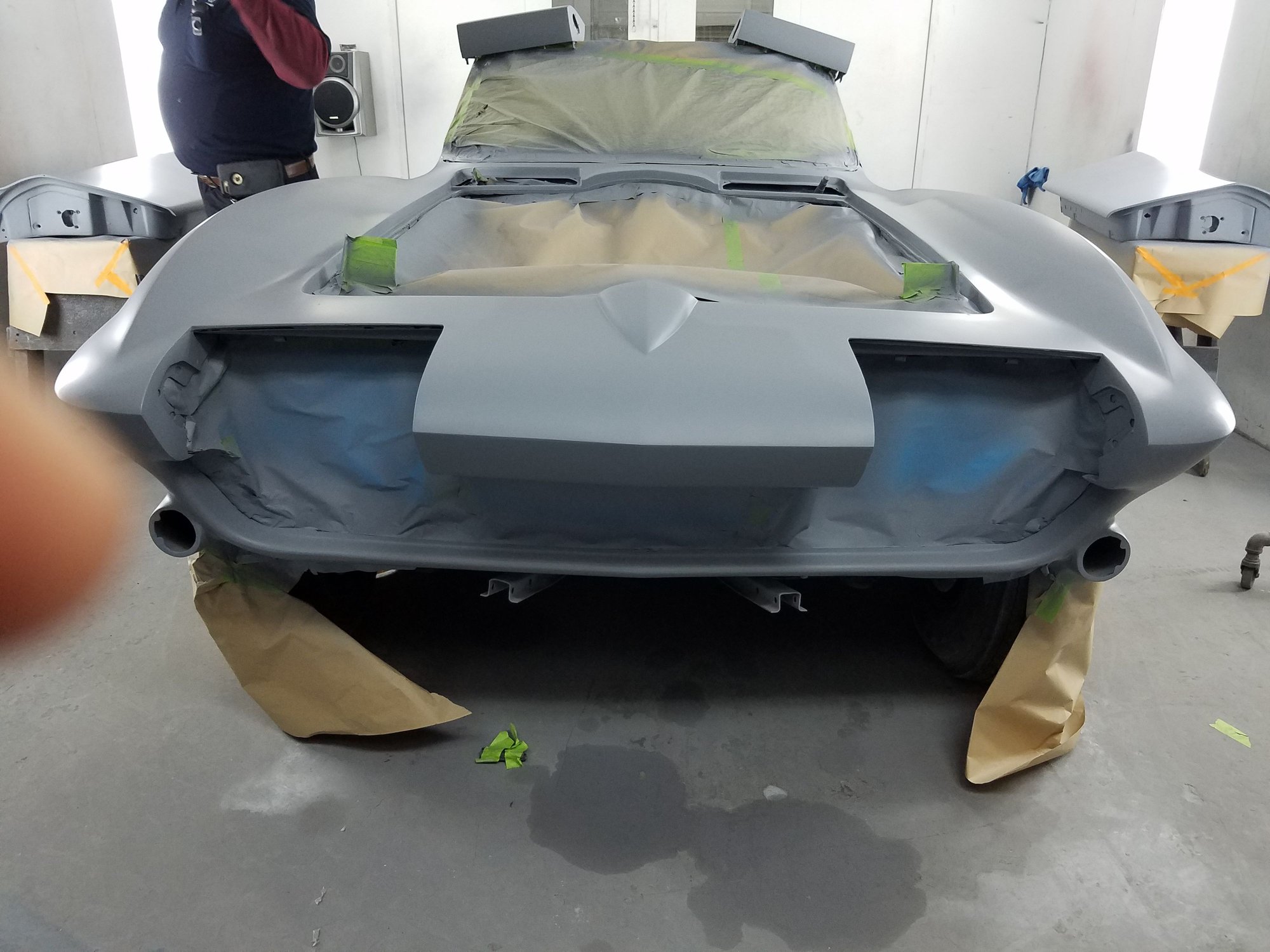

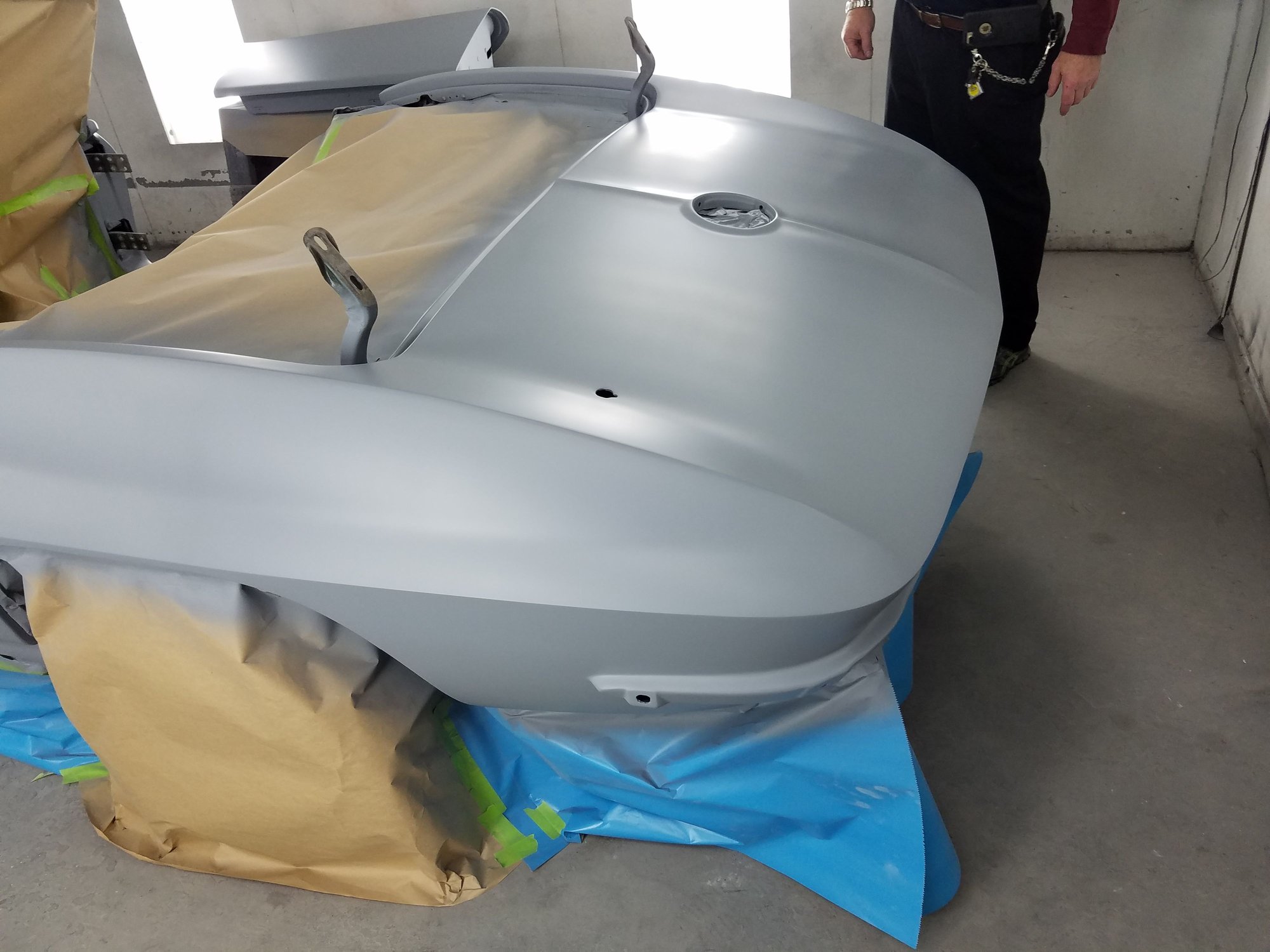

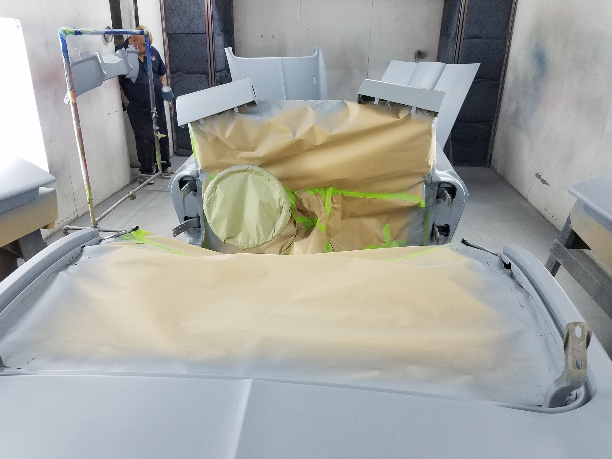

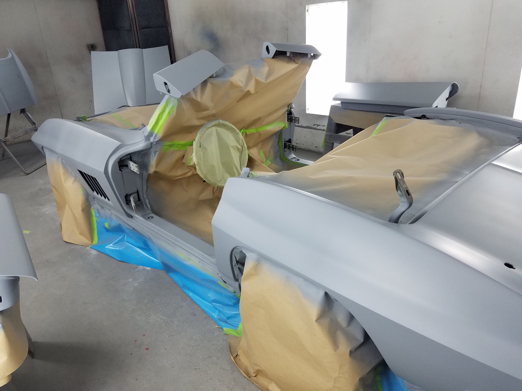

All the body work has been completed and this is the final sealing ready to go on over all the coats of Polyester. Next step after another round of blocking is to pull the body off and put it on a rotating dolly for final paint. The chassis will be restored next. Progress, slowly but we are moving in the right direction.

Did the body shop fill the two holes in the front nose where the crossed flag emblem goes? I'd want to re-drill those before paint. Great progress for only six months
