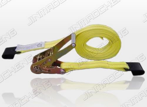

I took mine off with a HD lift and nylon tow strap as well. I welded up a balancer/load leveler for when it's time to put the body back on. But the seat belt location looks pretty darn fool proof.
