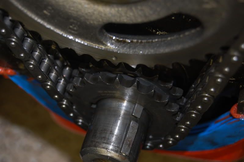

I got home today and put the garage tv on the Texas/Bama game, and start tearing the front of the engine apart. Once I get the pulleys, damper, water pump, and timing cover off, I find this:
The UT Quarterback gets knocked out of the game, and I find that the cam gear is off one tooth. How the hell did that happen. I took a picture of the setup just before I buttoned it up, or did I? I do not remember taking the cam gear off for any reason after taking the picture of the timing marks lined up perfectly. Damn.
Well, after reading David Vizard's book, I had regreted not putting the cam in 4 degrees advanced, so I'm doing that now.
I am really bummed right now because of this game and this major screw up on my part. Sorry guys.

i missed a clue too. that it liked 50* timing at idle was a clue for a retarded cam.
No real damage, and it will now run great!
what is the comp. now? 180?

Keep digging and you will find the culprit which you did. It can now be fixed and it should run very well now. Its not the first and won't be the last something like this happens. At least you found it. Let us know the results.

I put everything back together tonight and meausured my cranking compression. It is now 150 lbs on all cylinders, with the cam advanced 4 degrees. Not the 175-185lbs I'm used to, but much better than 120-130 lbs. It's late, I'll crank it in the morning and see how it runs.

15" of vacuum and it running like a sexually violated semian (raped ape) again. I'm gonna wash and wax it and drive it like I rented it.
