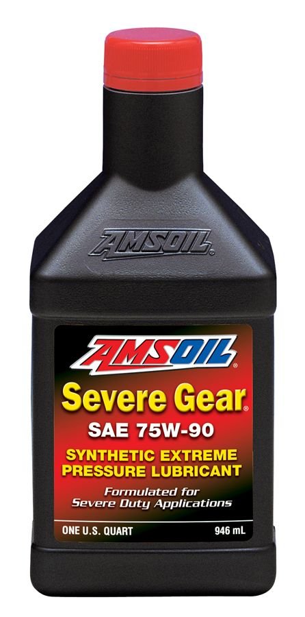

This is what I use. It already has the proper amount of limited slip additive in it.
http://www.amsoil.com/shop/by-produc...90/?zo=1934716

good old 90 w gear lube plus gm [posi additive

Have used it in all my differentials that call for SAE 75W-90 gear oil for years with no problems encountered. I feel it is well worth any additional expense.

I have used Mobil 1 75W-90 synthetic and Amsoil in my diff since 1990...no additive...zero issues with diff
