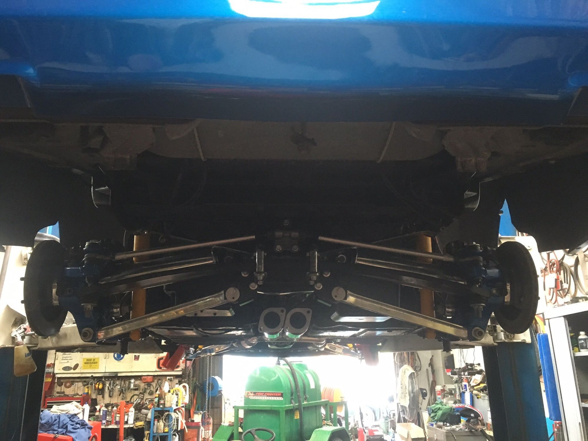

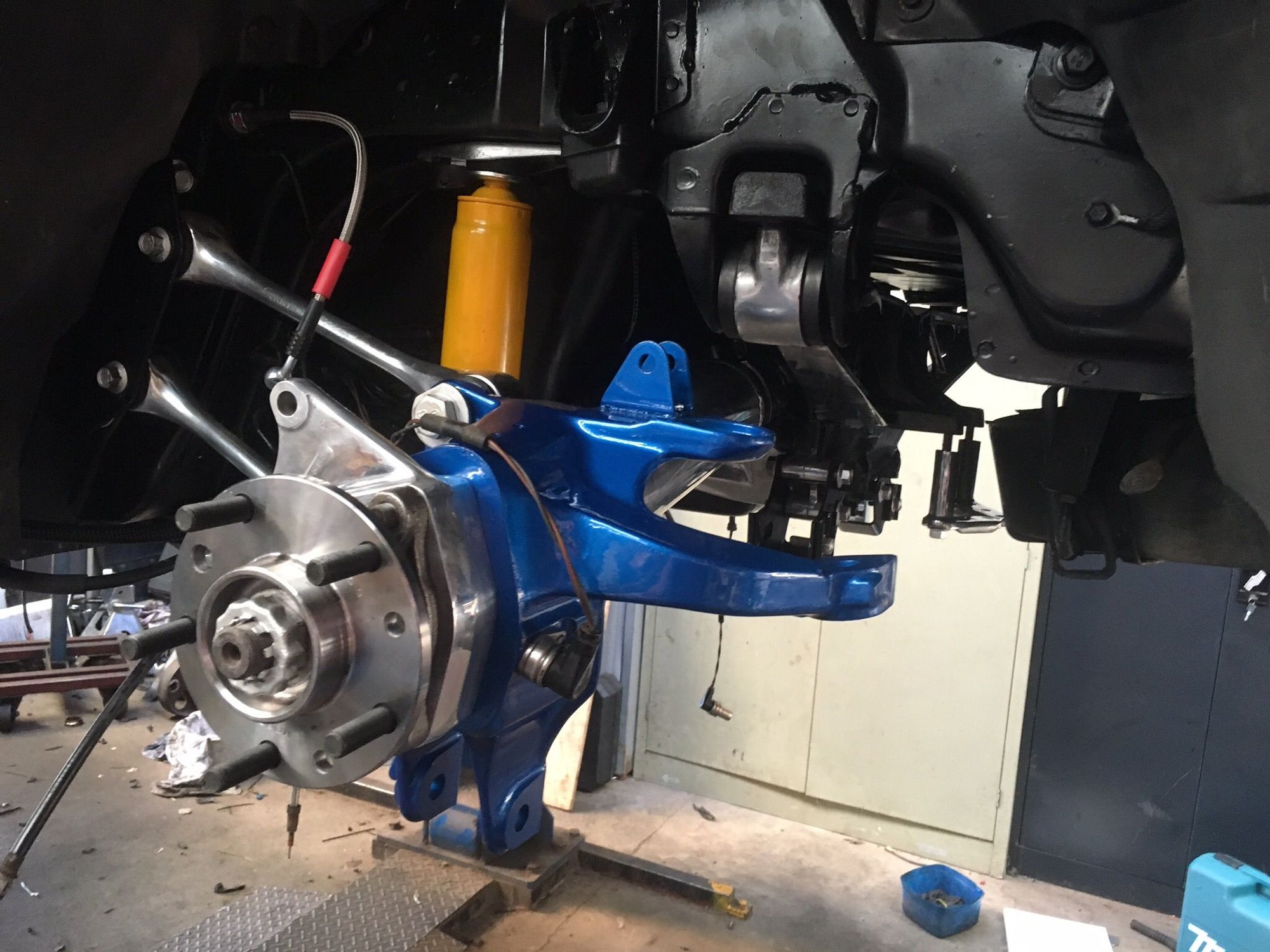

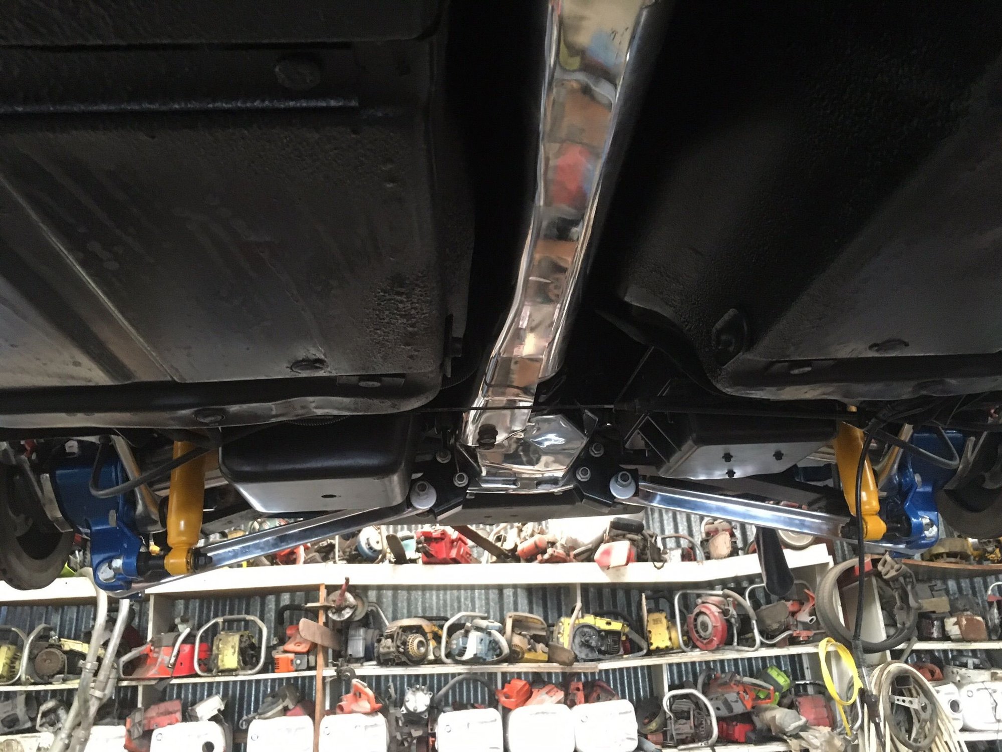

Spend a little bit of time under there

Dalesc4 , yours is awesome. 1bdvet, yours is top notch as well. I used the eagle one etching cleaner, a nylon scrub brush and water. Easy peasy. Mine is a driver and sets outside, so to go as far as these other guys would be of no use for me. But man, is that some nice work they've done. Name:  photo862.jpg

Great job yes mines a touch far
I must admit I own a metal polishing company so it's what I do
U guys all have the right idea
The trick is the more u can smooth out the alloy the sinner
I can get it
So sanding is the only way to get them like mine
And then use a polish like
Autosol or Fitz
The other ones are really just to keep them clean
If any one has any questions
Please let me no
Dale

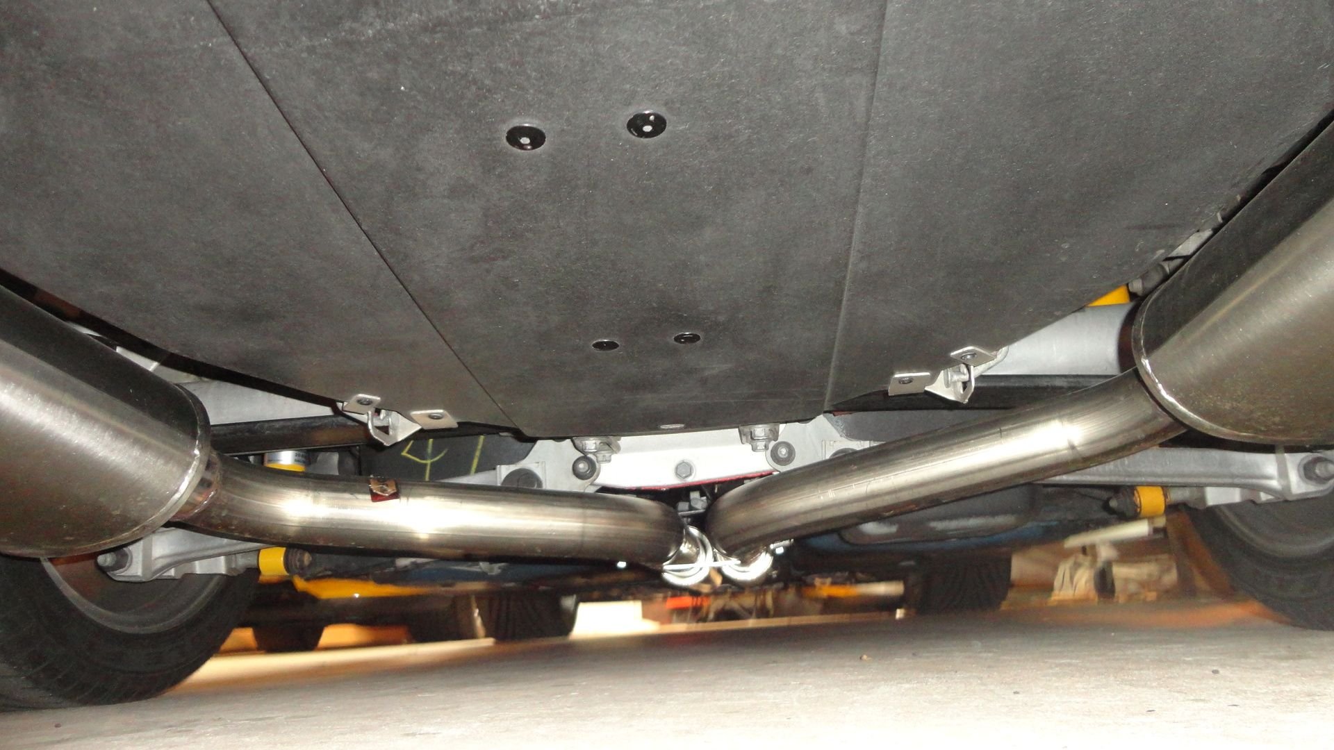

Nothing special, but I like pictures

@ Dalesc4 That looks outstanding

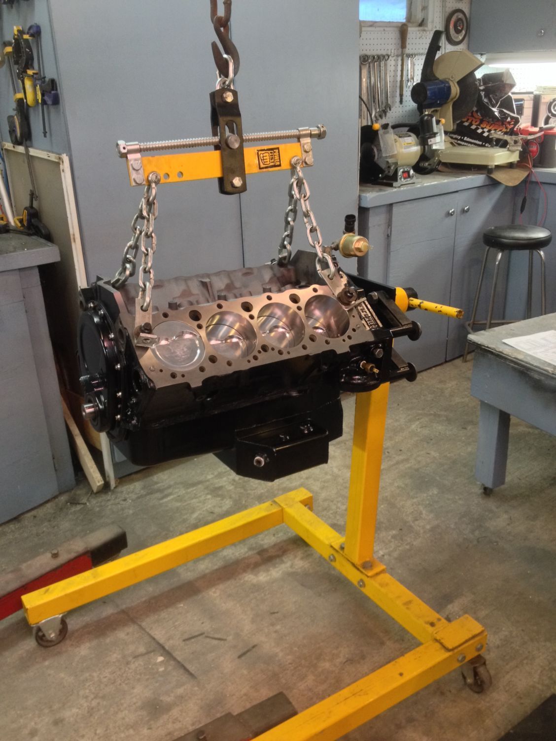

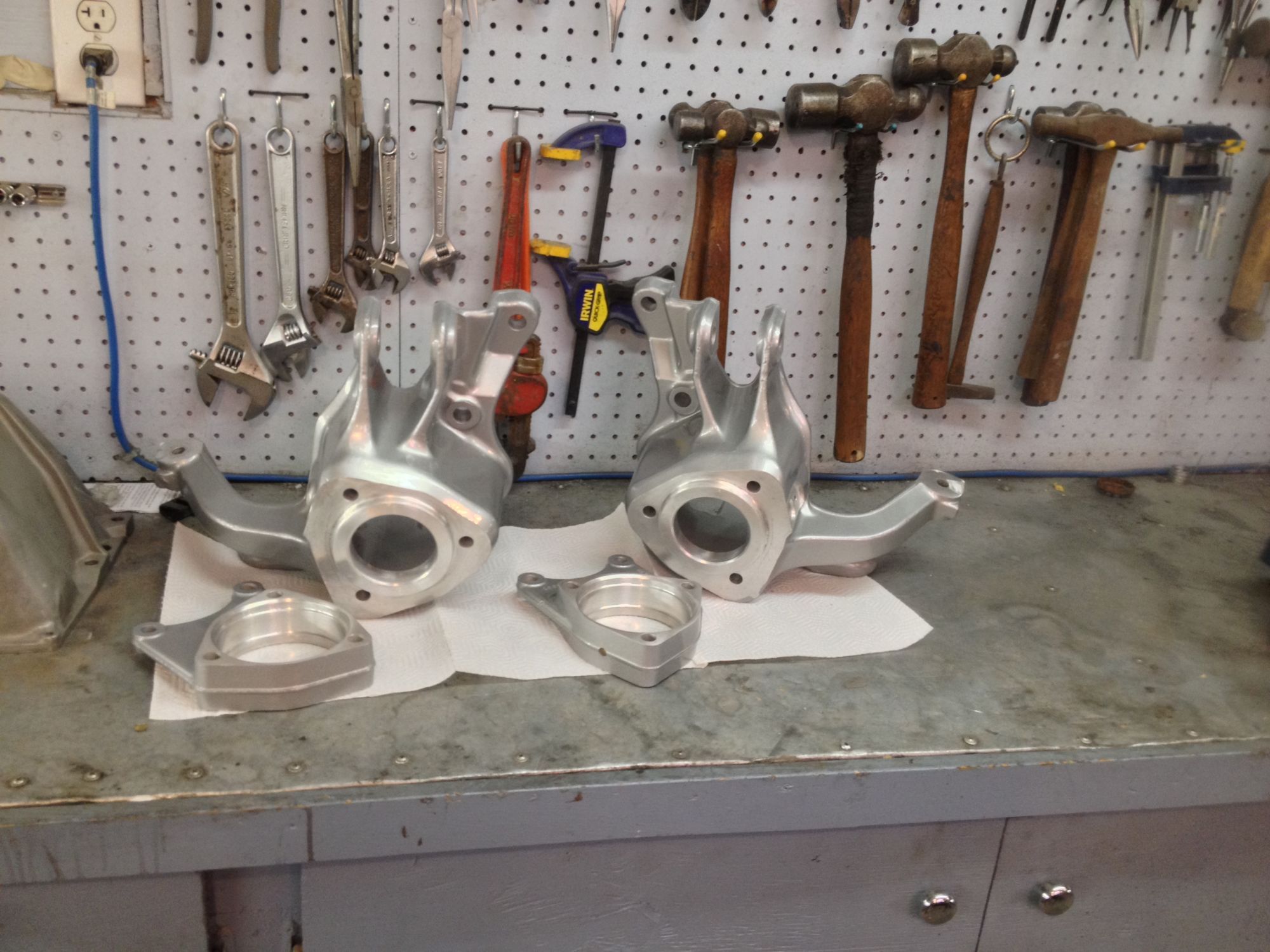

I took basically everything apart under the car and painted it bright silver with gloss black accents using a catalyzed automotive paint, engine was just gloss black underneath. Here's a few pictures from my build thread...
