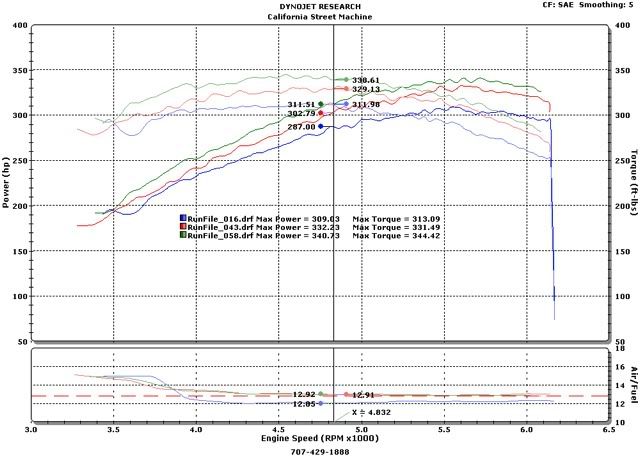

Here are the graphs. 1st run is baseline with stock plugs and no tune, 2nd is with long tubes, tune and NGK's, 3rd is back to Delco's with no other changes in the tune. I felt that after adding the LT's it should have picked up more so we were wondering why. We put the stock AC Delco plugs back in it to eliminate that variable and came up with an additional 8 RWHP.

Theres some other factor at work here. Dont know what it is but Im confident you're not getting 8hp with just a plug change, unless theres a gap difference, wrong heat range, bad plug or something not quite the same from test to test.

Gap was double checked, heat range was the same, part numbers for the application were verified etc. This is not my first BBQ
This is not the only time I have seen something similar. I work at a dealer and we see 30-40 forum cars a month, all with unique issues. Recently I have seen a ton of issues with aftermarket plugs and drivability issues. I only posted this for people to see facts, not some keyboard commando baised opinion with no supporting facts to back it up. Take it for what it's worth and if you don't believe it, no biggie. I am not going to lose any sleep over peoples doubts on this issue when I see it on a weekly basis.

that plugs brand new out of the box, diferent brands could make a big diference, im not sure on the dyno numbers but i have seen .15 gain at the 1/4 and also a loss of .30 with less then a 100 street miles on some brandsi have never had a problem with the ngk, i always just coat the iner spark plug boots with a qtip and dielectric creme

.15 gain or loss would account for about 8-10 HP, which would be consistant with what I found. Both of the sets of plugs were brand new and the gap was checked just to eliminate that variable.
The only reason that made me think to do this comparison was seeing so many recent issues with aftermarket plugs on Corvettes. Using that logic on the LS2 TBSS, this is what i found.
The dielectric grease is a good idea to keep the boots from sticking on the plugs as well.

If that dyno graph is from a LS3 with the mods you quoted...those #'s are about 60 t0 85 hp shy of what they should be! Even without mods they are 35 t0 50hp off. I'm willing to give the Delco another try when I change out my NGK tr55's. Thanks for your input.

In the previous posts I stated the dyno graphs were from my LS2 Trailblazer SS with Long tubes and cold air.
