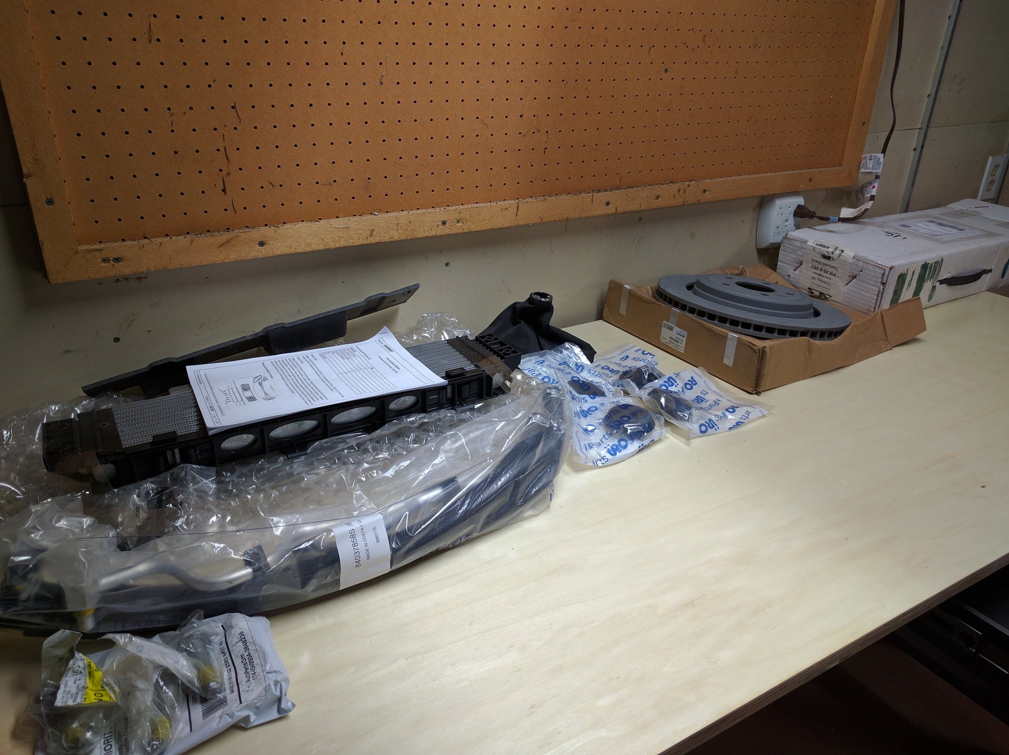

Well, it did not take long; I received all the parts for the Z06 brakes!
As expected, it only too 1.5 weeks for the parts to arrive (even though it said 1-2 months delay).

Z06 fan, transmission oil cooler, quarter panel vents, and front grille are in.

In other news, I received the seat conversion kit, T1 suspension, sueded steering wheel/**** : )
