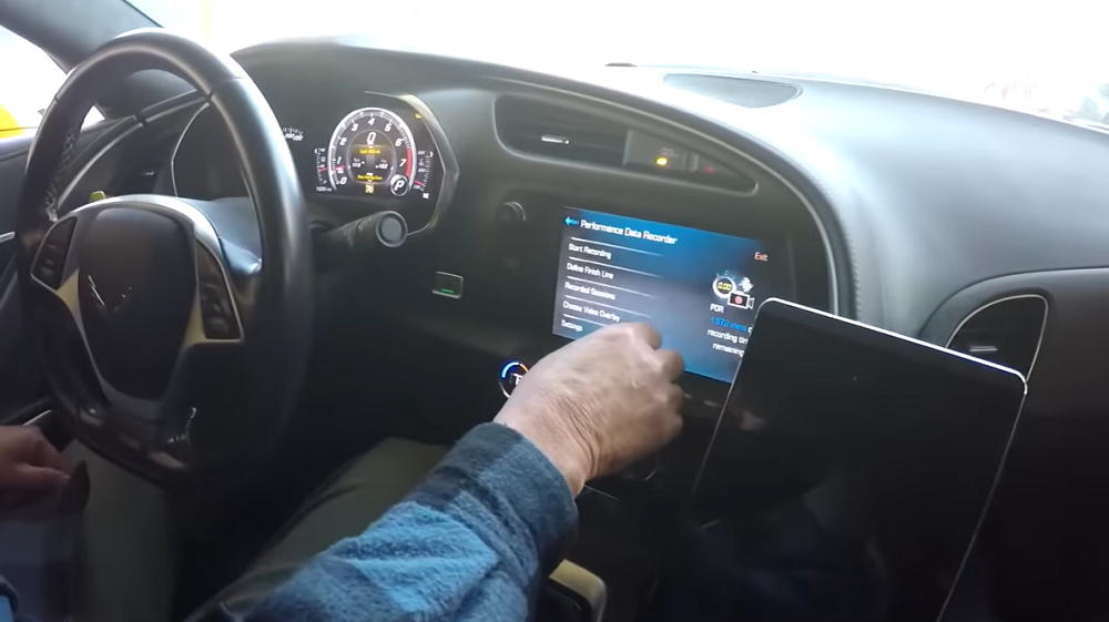

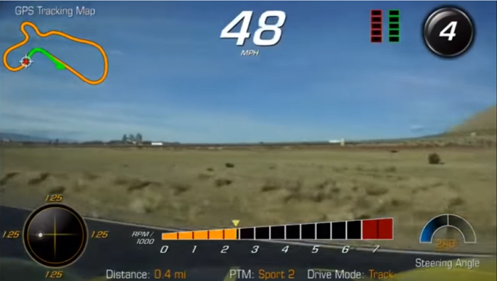

The Performance Data Recorder is on and shows that the car is in Track / Sport 2 mode. That turns off stability control in a C7 Z06. This is a bad idea most of the time, but an even worse idea in this case. This appears to be the first run of the day and looks to also be a cold day. Tough to tell the specific model of tires on the car but they certainly seem to be summer performance tires of some sort. Not a tire you want to push on a cold day. On lap number one. With no stability control. With a novice driver behind the wheel.
I tell all of my students to leave the electronic aids on when they are first learning. In fact, 99 percent of the time I am driving on track, I leave them on in my own car. There is a point when you will progress to a level where they may interfere a bit and then maybe you have the skill to handle the car with the aids off. But even then, is it worth it? Maybe you gain a couple tenths on a lap but so what? I have never seen Laura Wontrop Klauser at any of my HPDE events and walk up to a driver and ask them to join the Corvette Racing team. The goal of HPDE is to have fun, be safe and leave with the car and yourself intact.
car setup
If you feel you can’t push the car enough at an HPDE there are plenty of racing schools, you can join. Last year, I had a student in a brand new Supra at the track for the first time. He argued with me in the first session about turning off traction control. He said it was being too intrusive. I told him it was saving him as he was overdriving the car. When the second session started, he quietly turned off traction control without my knowledge. On turn 7 of lap one, he put us and his car into the tire wall. Lesson learned. Steve is a novice in a massively powerful car, on the wrong tires for the conditions. He needed all the help he could get. Turning off the safety net of stability control was a mistake. As it almost always is.

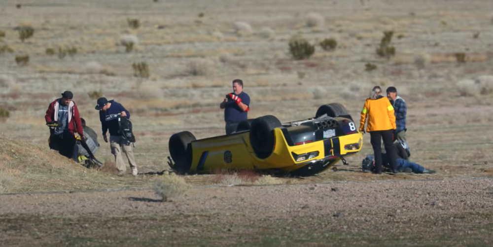

A Destroyed C7 Z06 – The Crash
Note: I don’t have any access to data other than what I can see in the video from the destroyed C7 Z06 Performance Data Recorder. So, I am making a few assumptions here, but this seems to be what happened…
Steve leaves pit out, negotiates turn 1 and then goes immediately to full throttle. The car quickly goes from about 70 mph to about 90 mph. Traction is lost at the rear and the car pitches to the outside of the track. According to the data we have, it looks like the driver then immediately lifts off the throttle and applies some moderate braking. The car then darts to the inside of the track. It hits the dirt at about 35 mph and rolls. The roof is crushed and both occupants are lucky to be alive.
Z06 crash
In my humble opinion, a number of things lead to this crash, all of which could have been prevented. Car setup I already covered. Beyond that, the first mistake was the driver unleashing a full 650 horsepower on cold summer tires on a cold track. The second problem was when the car first stepped out. In this scenario, lifting off the throttle and jamming on the brakes is a big mistake. Why? Because weight transfers off the rear wheels, giving them even less traction. And this made the off-track excursion basically unavoidable at that point. It is a natural instinct for a novice driver to take this type of corrective action.
Destroyed C7 Z06
Sometimes in a situation like this adding more throttle can get the weight back on the rear tires. However, with the cold temps and summer tires him adding more throttle was probably not going to be an option. Given what we can see in the video, his best bet would have been to gently reduce throttle and counter steer. He may have saved it or at least kept the spin on the track. This comes with seat time and instruction. Steve had little to none of either and so, goodbye, C7 Z06.
