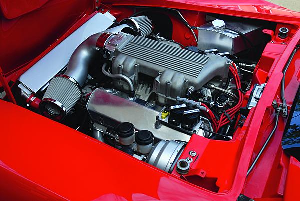

One glimpse under the raised hood of this racy red ragtop and you’ll be smacked right between the eyes with a fistful of aluminum 510ci Donovan mountain motor. This fuel-injected powerhouse sounds great, but before it ever came to life, it went through hell.

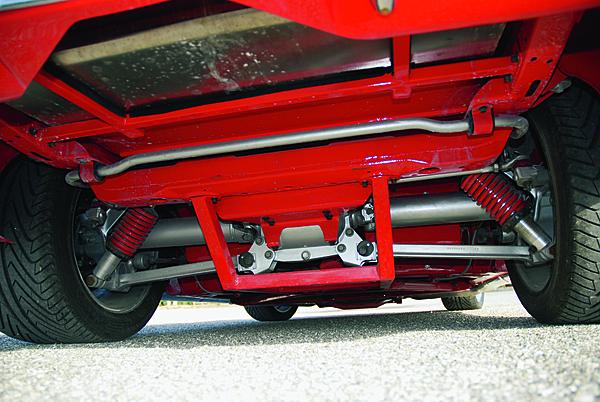

There was a plan for upgrading the entire suspension to C4-grade components, an honorable intention. But, by installing the torque arm for the differential, it all but eliminated the ability to install the passenger’s seat and required the majority of the floorboard and tunnel to be modified. Those gleamingly chromed side-pipe headers that sound so cool didn’t have a prayer of reaching around the modified chassis components either. Another object that went unnoticed until someone tried to line it all up was the core support. 1968 Corvettes use a very similar core support as a ?67 Corvette with limited radiator area available. This becomes a real issue when you consider the 700-plus horses that were planned to live under the car’s hood. That is, if you could close the hood. Turns out that the engine proved to be a couple of inches too high, and at that point, it might as well been a mile.

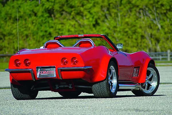

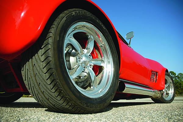

As the parts began to flow toward the project car, it became even more obvious that at least some would never fit. Items like the ?68 having the ignition on the dash. But, when your ?new, but purchased a while ago? dash panel is for a later ?69 version, you’re stuck wondering where you’re going to put the key! Sometimes, one year does make a difference. When the Corvette Clinic installed the custom-built Boyd Coddington wheels, it became obvious that the sleek lines of the Corvette were perched up more akin to a 4×4 than a sports car.
One mistake that many projects suffer from, this one especially, was that the body was painted with the assumption that everything would fit. This fault became more obvious ? as things repeatedly didn’t. The ?73 front end that was grafted onto the front of the car was painted with the body. Problem was, no one checked to see if the accompanying marker lights and grilles would fit in the openings. They didn’t.
Once Chris knew what he did, and didn’t have, he knew what he needed to do. That began with lowering the engine 1? inches and raising the body a full inch. That allowed the hood to close so that all of the panel gaps could be adjusted. But, it created a problem between the crank pulley/harmonic balancer and the crossmember, which needed to be notched to make room. That eliminated the ability to use a typical C4 spring arrangement, so a set of QA1 coilover shocks were implemented at every corner, allowing for ride height adjustments as well.
Chris fabricated custom mounting brackets that used urethane-bushed mounting points to keep the differential planted, instead of the C4’s factory torque arm. The floorboard, trans tunnel and anyone who would ever reside in the passenger’s side of the car breathed a sigh of relief. Truly, this project was living in its darkest hour, but it’s always darkest before the dawn.
As parts started to fit together, the project began to gain momentum, and those grand plans for the car from the beginning were starting to be realized. A set of Baer brakes bolted right up to the chassis and, while they were at it, a complete ABS system was integrated into the car’s abilities. The controller and module were mounted in the rear compartment of the cabin, just like it would have been in a C4. All brake and fuel lines were run in stainless steel with Mr. Gasket Shadow series aluminum fittings and hoses. That issue with the core support was rectified by modifying it to mount a custom Ron Davis radiator with C5 cooling fans fitted for faster cooling.

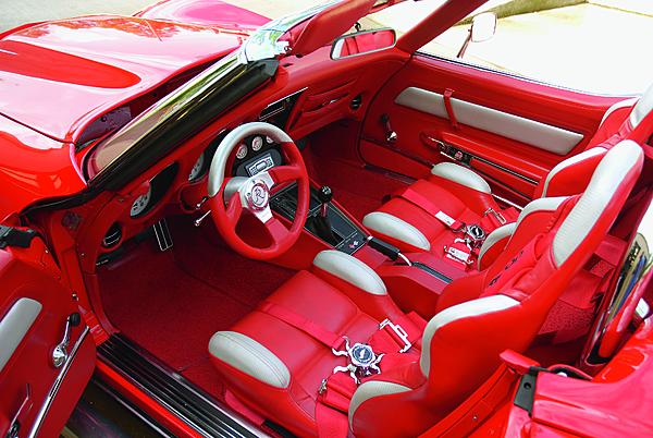

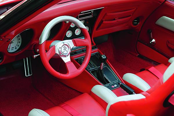

Chris first focused on making all of the components fit before worrying about making them pretty. That meant that the car was assembled, and disassembled, several times before any further painting or polishing was done. Once he was satisfied that the surprise gremlins were properly exorcised, he began spraying all of the chassis components in red or silver urethane and the body went back into the body shop for another fresh coat of red. Upon returning to the Corvette Clinic, the rest of the car was assembled including that red and faux silver carbon fiber-inserted interior.
As the car came together, John’s dream of finally enjoying the car came into focus and, since he lived in South Florida, he wanted to be able to enjoy the car year around. That’s why this monster has at least one creature comfort, a Vintage Air A/C unit. Even after so many years of toil in trying to realize what his vision of the perfect ?68 Corvette could be, John was now able to hit the key, drive in style and rattle the windows in his gated Miami suburb. It was more than a little gratifying.
