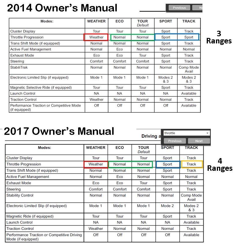

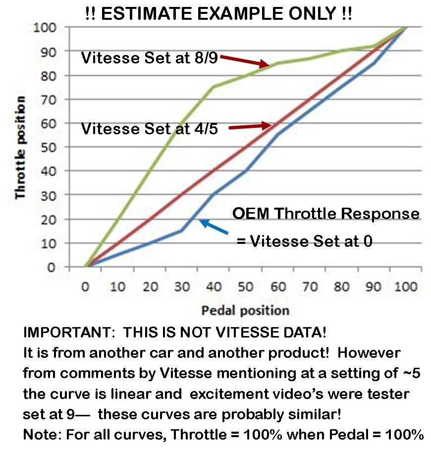

Yep they could do that OR you could add a simple Throttle Controller.
I had driven my non MRC Z51 C7 for 3 1/2 years and was used to the max throttle response since I drove in Sport. When I got my Grand Sport set the steering to always Sport and NPP to always Track. But no such option for throttle response. In fact for the 2017 I needed to have it in Track to get max throttle response. Driving in Track on the street will rattle your teeth!
Solved the problem with a Vitesse Throttle Controller! In fact I can set the Throttle Response far more aggressive than I have the Holley 850 on my 502 cid BB in my street rod! That 850 is a "Double Pumper" with two 50 cc accelerator pumps and the right pump cams (fast but not full volume dump) so it doesn't get too rich-but yet no bog or stumble! The 850 carburetor is cable operated but throttle-by-wire control is NOT the feature that is slower, it's the response programming! Note below a 25% foot peddle opening can open the throttle 50% if programmed to do it! The OEM is probably more like that shown, a 25% peddle opening only opens the throttle 12%!
This is a PDF of my install: http://netwelding.com/Throttle_Control.pdf
Below are a few pics from that pic/text doc.
In 2014 only had to drive in Sport to get max Throttle Response. It was a non MRC so ride was no issue but liked the Steering and "nanny response." In 2017 have to be in Track mode to get max response. After driving in Sport in my 2014 for 3 1/2 years my Grand Sport was NOT acceptable to me!
Note, in Touring where I drive the Grand Sport the throttle response is slow. Could set the Vitesse Controller to what I call "Boy Racer" at 9 but 4 or 5 setting is fine for me. At 5 feels like the 2014 set at Sport (= Track.)
