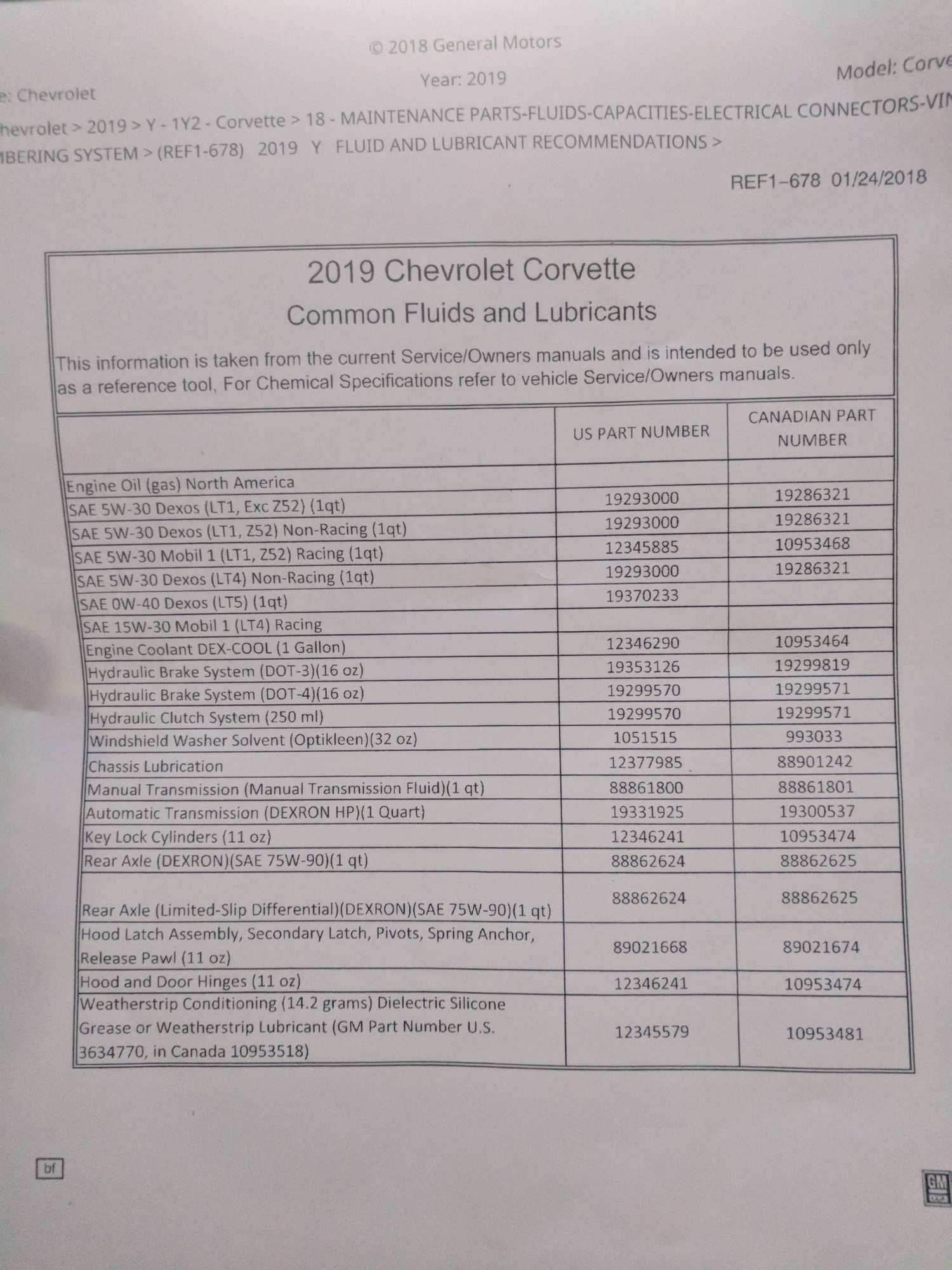

Where did you get this information? I went in to my local dealer today and they had never heard of this oil... They did some research and found this sheet below. The part number listed for the 2019 Corvette "Dexos 0W-40" is 19370233.
It's weird because it lists it for the LT5 and doesn't label it as Mobil 1, but he said when he looked up that part number it was the Mobil 1 ESP I was looking for. They are checking tomorrow to see if they can order it.
slickstick is offline   Reply With Quote

GM and Mobil aren't making this easy for us.
According to Google:
The 19353135 shows up as a 0W-40 Dexos 2 oil, but only on a website that seems to be for people in Europe trying to find parts for American cars. I suspect it's not the new wonder oil.
The 19370233 doesn't show on Google at all.
