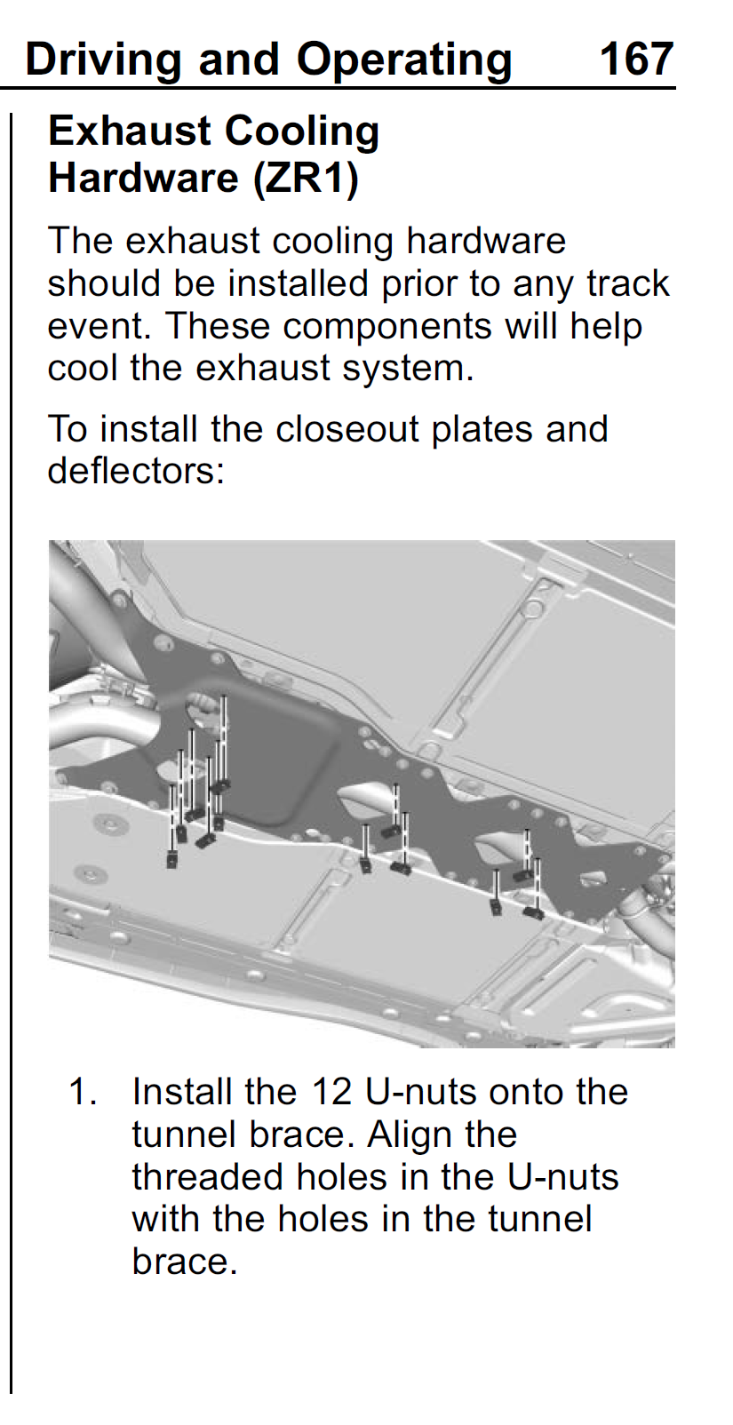

It looks like they are designed to funnel some air in to the tunnel where the exhaust is. Here is an excerpt from the owners manual.

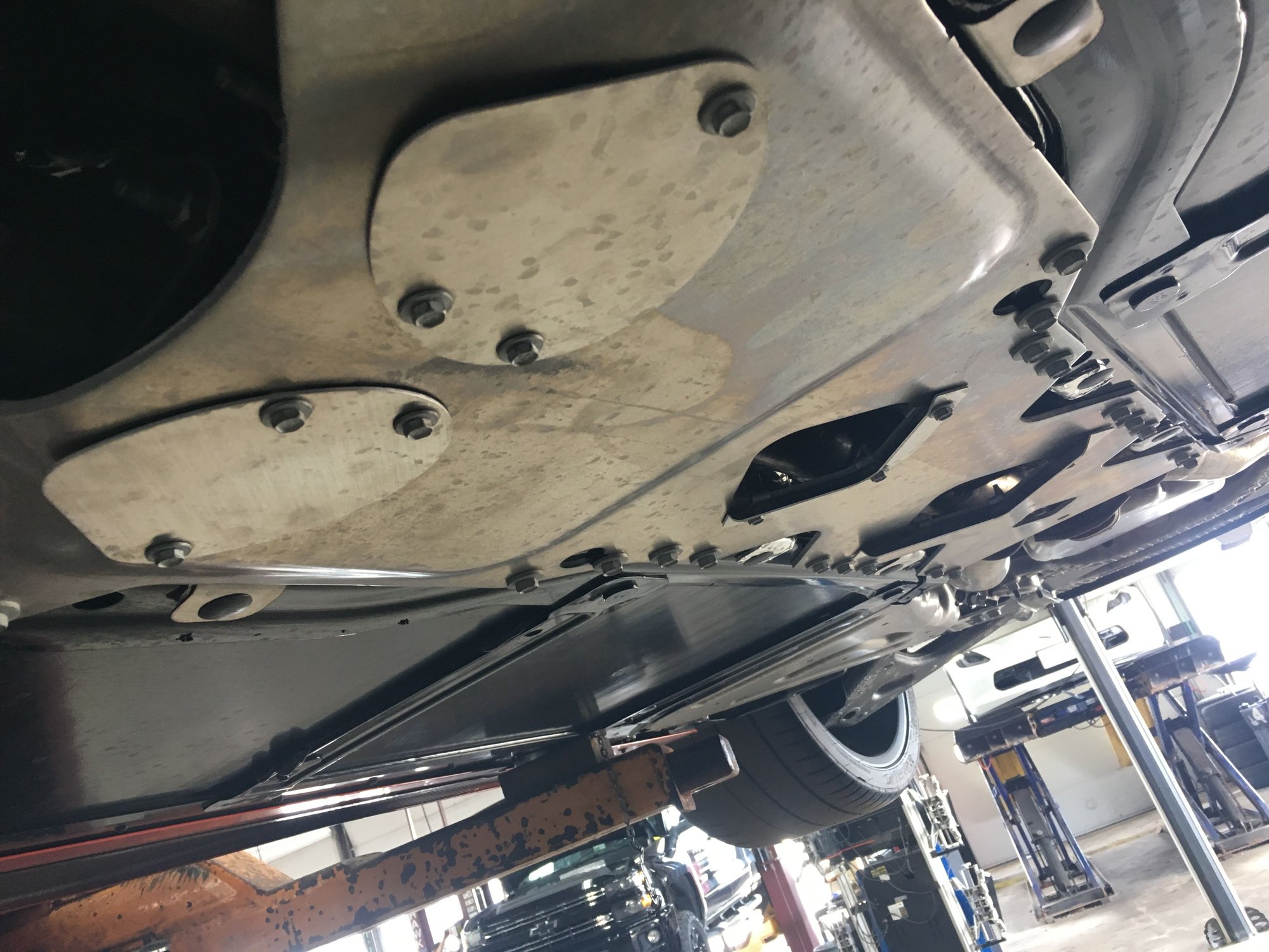

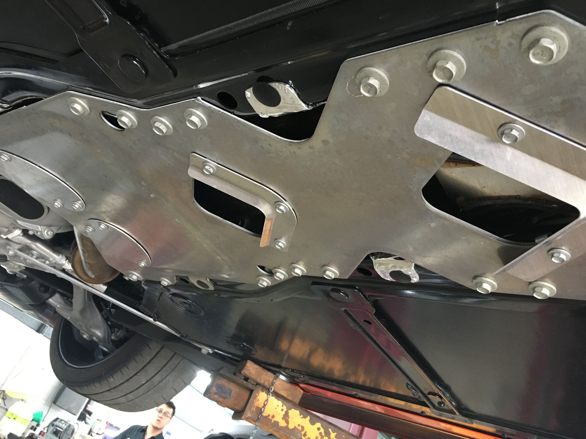

Got a look at the underside of my car today while doing my 500 mile oil change at the dealership. Took a couple pictures of the new Exhaust Cooling Hardware (installed).

Thanks for the pics! Very interesting thinking about how these would work. Almost looks like it is blocking off the breather holes which you would think would make the exhaust run hotter!
Amateur aero guy here: my guess is that the deflectors are to help get the air out of the tunnel plate as quickly as possible until it gets to the very rear of the plate. It looks like any air coming through the tunnel plate will follow the holes out from under the plate given the aero disturbance the deflectors are causing: creating a slightly lower pressure "bubble", for lack of a better word, right under those holes.
The idea here is that the air surrounding the cats and exhaust pipes will get so hot while at WOT on the track that GM probably wants that out of the tunnel plate instead of going all the way back and cooking the exterior of the mufflers.
Just a guess. As to why GM suggests removing them for street driving, I'd expect it to be a ground clearance concern. But maybe we'll find out more if this gets submitted next week.

All sounds plausible, BUT, I think you are looking at the pics backwards. The covered holes are at the FRONT... so they are blocking some of the air entering at the front of the tunnel... the two deflectors then direct air up into the next two holes... my guess is to speed up air flow at the rear of the tunnel and force air to better flow out the back end... but that's just a pure guess.
I do hope that we might eventually get a better understanding of how these alterations work... and an explanation on why GM recommends removing them for street driving. I don't think ground clearance is the issue as they have SO LITTLE impact on clearance that it just doesn't appear to be the issue... at least not to my eye.

It looks like the additional tunnel hardware is to create a "Bernoulli effect", the scoops in the middle create a low pressure zone in the front of the tunnel and the block-off plates ensure that cooling air enters the front of the tunnel for max cooling effect. Based on my observation of the brake cooling system on my Z51, which puts a lot of sand inside my wheels, my guess as to why the cooling hardware is to be removed for street use is that the ZR1 would be an expensive street cleaner.
