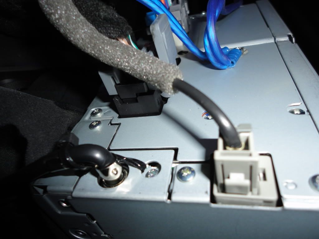

here is a picture of an RCA interconnect that is ground to the chassis of the head unit. take a wire, strip a bit of the insulation, wedge the wire into the barrel of the RCA connection. your goal is to secure the wire to the negative side of the RCA without touching the positive side. the other end of the wire should be attached to the head unit. in my photo you will see a spade connector.
When you have the head unit removed, you may want to try an additional test. If you notice a high pitch in your speakers that goes away when you unplug the antenna from the head unit, then you need an antenna isolator. The antenna isolator that I purchased from the website named after a South American rain forest is manufactured by DLC (no part number). The antenna isolator that I received had connections for a standard antenna plug; however, GM changed the size of the antenna plug from a standard plug to a mini plug so I had to use metra 40-gm10 and metra 40-gm20 to complete the connection.
Pic of the antenna isolator. The far left item is metra 40-gm20, the middle item is the DLC antenna isolator, and the right item is metra 40-gm10
Pic of antenna isolator plugged into head unit (interconnect ground also visible). You will see a zip tie that I ran though two holes and wrapped around the antenna wire to keep the antenna securely connected (the connection was not tight). In this pic you will also see that both interconnects are grounded to the head unit chassis and crimped to one spade connector.
