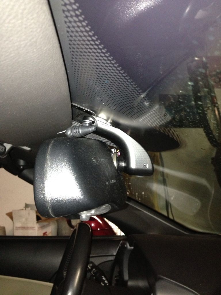

I mounted the bluetooth mic above the mirror and just ran the wire around the windshield to the drivers side, down the across to the radio.

I put mine here, haven't heard any complaints, but I'm pretty much against do anything in the car besides driving, so my conversations are always short and sweet.
some pics of the mounting location i chose.
