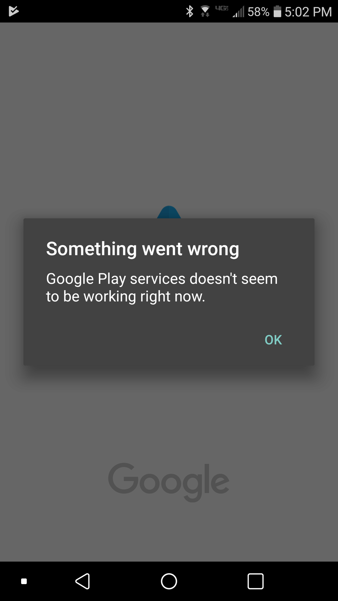

Tried both cables enterchanged with ever combo of usb c type I habe here (4) and get the same stuff
Here are most recent reactions combined with usb errors
Im lost LOL
