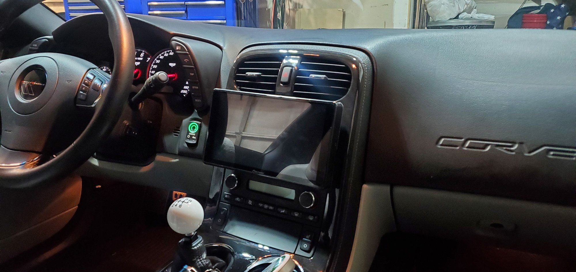

spent the weekend installing the 9 inch Pioneer. worked out good. if anyone has any questions let me know. Sorry the pics came out crappy in the garage.

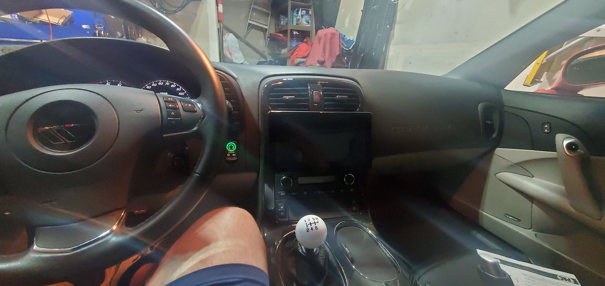

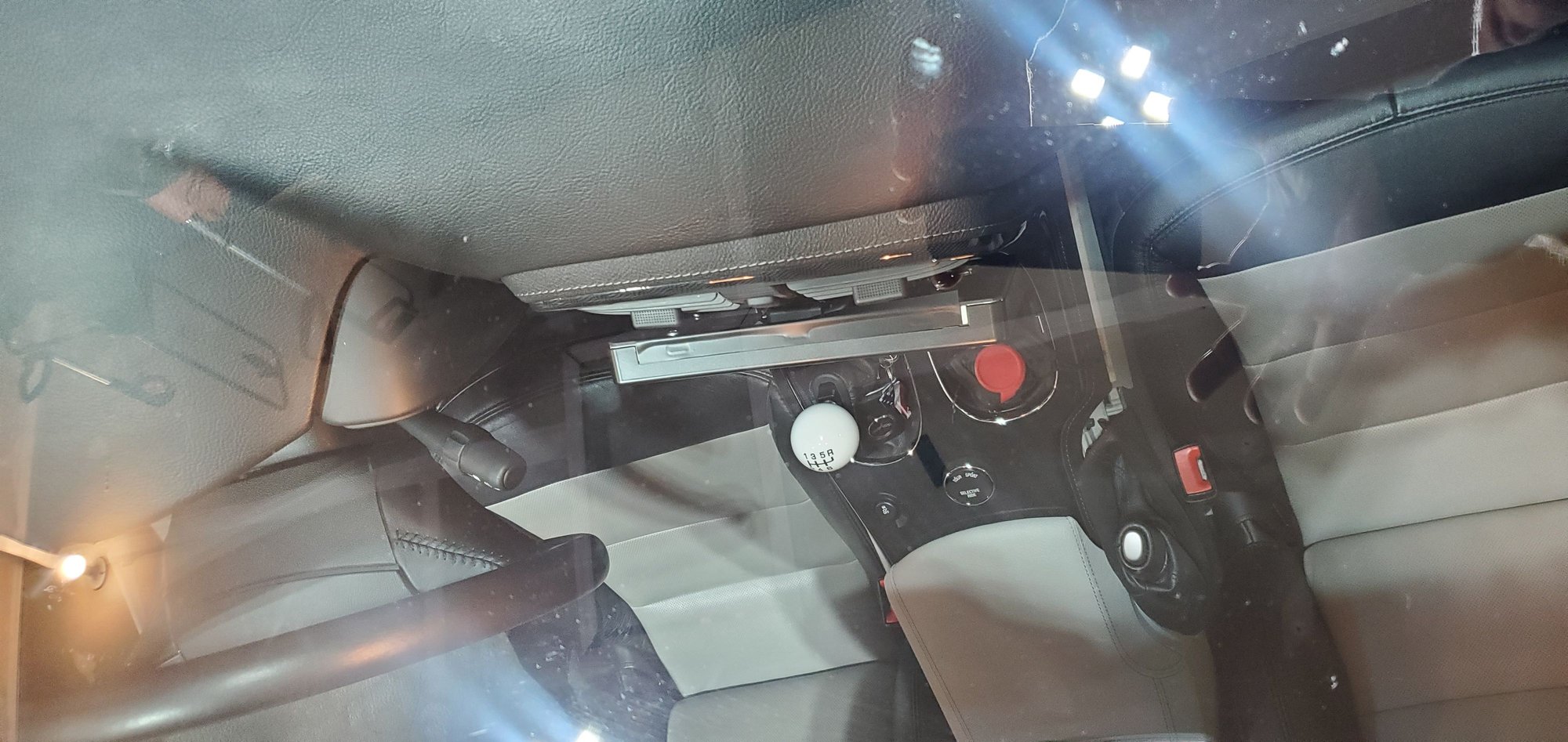

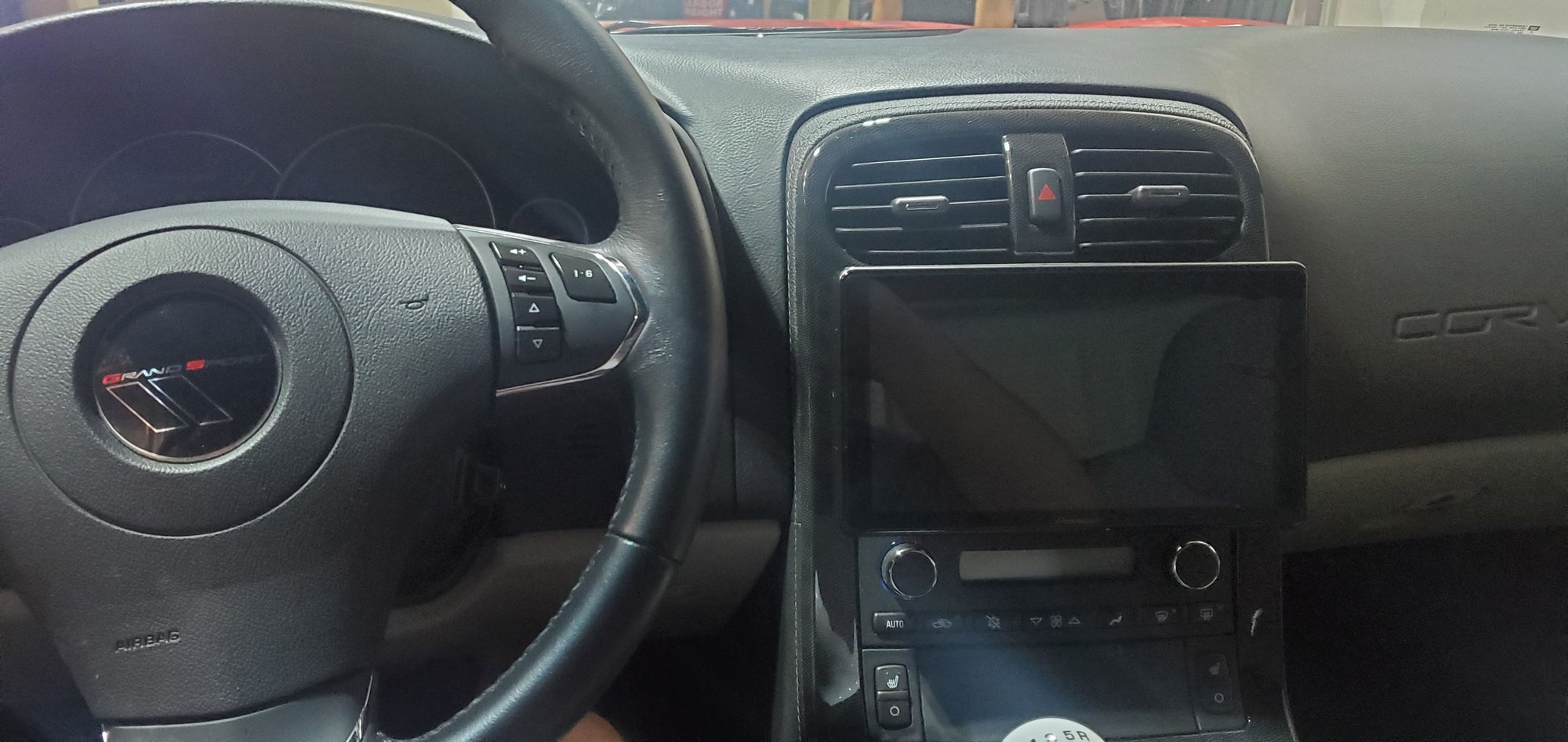

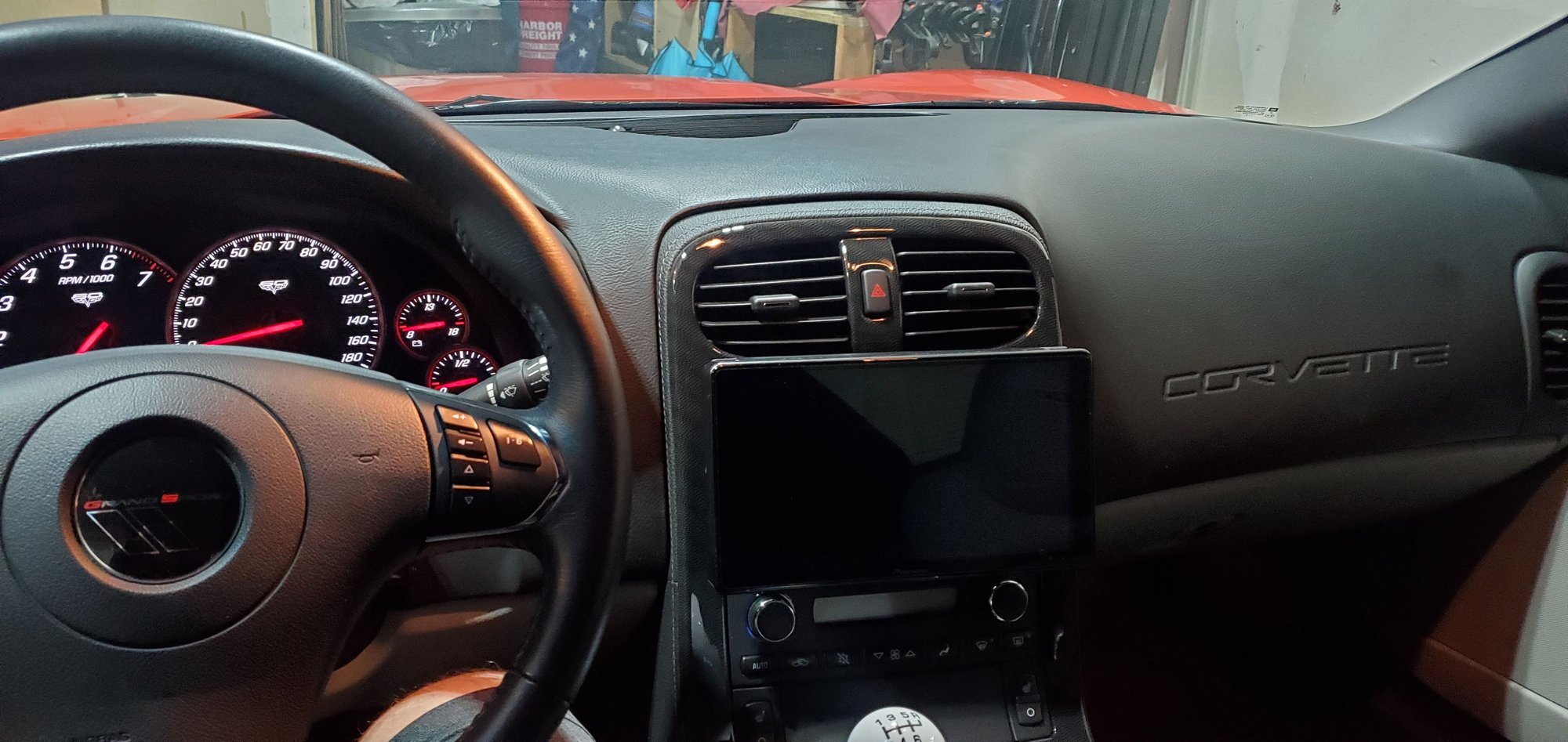

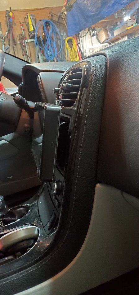

yes, the radio doesn't recognize the camera when its at the higher setting - if you figure a way around this, let me know.
the view from the drivers seat - its more or less facing directly at me

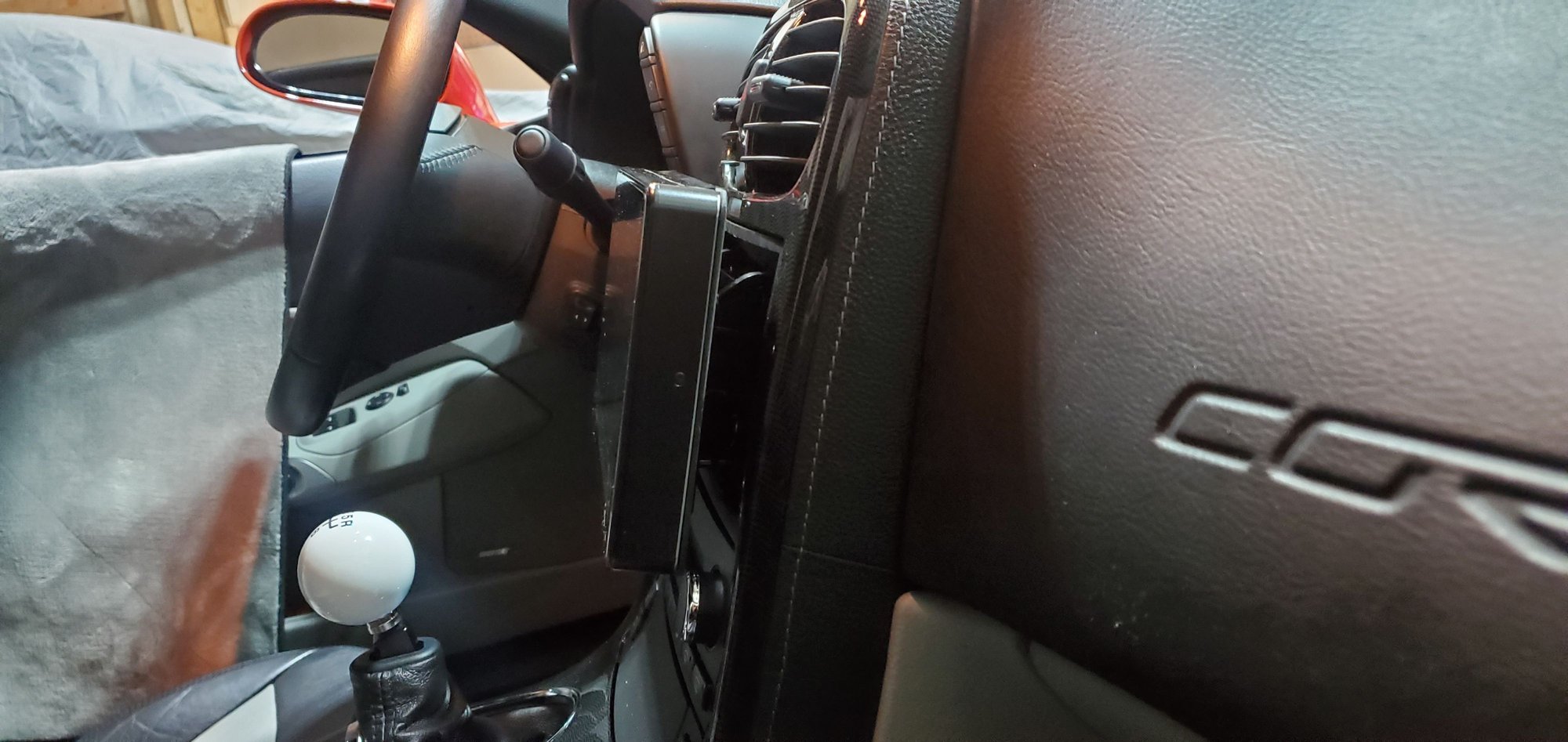

direct side view - you wouldn't see this unless you had your face on the dash
another side shot for you

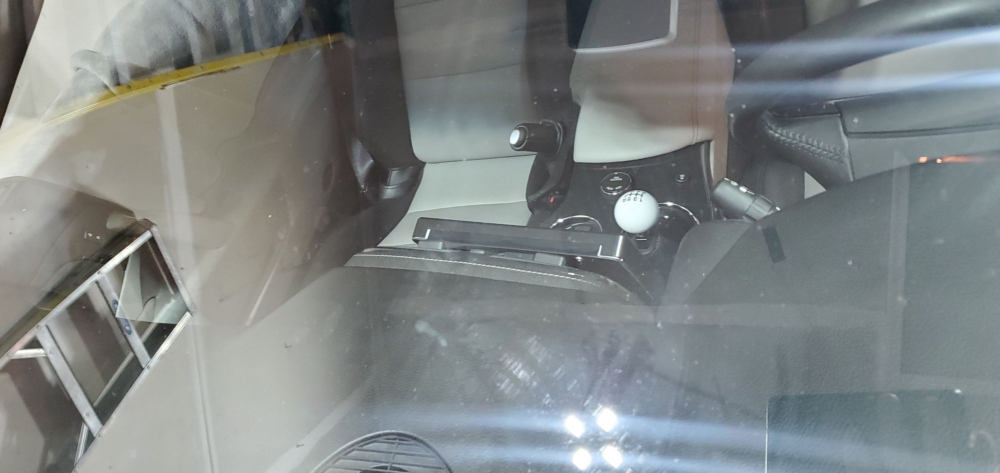

view from the passenger seat - that entire area of the dash is angled away from the passenger
top view - stuck a piece of electrical tape to cover up the grey - just threw it on there to see how it would look - I'm going to redo it to make it perfect
another top down view

Thank you for the pictures. They are very helpful.

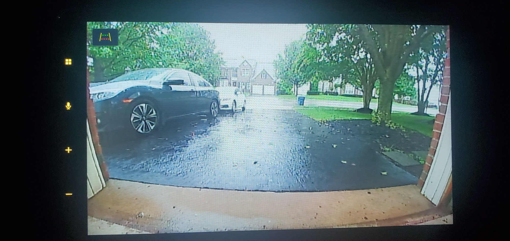

The camera has two settings, it only works in the lower setting. The picture is still fine here's a couple examples. I was just hoping that it would be HD but no big deal.
backup view, I removed the parking lines from the camera setting but I can still use it from the radio
