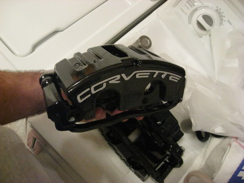

As of yesterday, we are now allowed to put C6 (non-Z06) calipers on our C5 T1 cars. I have a brand new set of C5Z calipers and 5 sets of race pads to go with them, so I'm not sure I'll change right away.
Are there more than one type of non-Z06 C6 calipers? When I've looked at them online from various sources, I see notes about Z51 vs. non-Z51, but can't see for sure if there is a difference.
Also, will the pads I have for my C5 calipers fit a C6 caliper? Thanks for any information guys - I've been poking around the interweb this morning looking for answers, but always feel more comfortable hearing from the guys who KNOW!

The Z51 uses a different caliper that won't work. The C6 caliper uses the same pad and is slightly reinforced. There was a recent thread:
http://forums.corvetteforum.com/auto...s-not-z06.html

Thanks for the pic and the link. That C6 caliper does look substantially more beefy than my C5Z calipers. When you say the Z51 caliper won't work - it won't fit, wrong rotor size, what's the rub?
