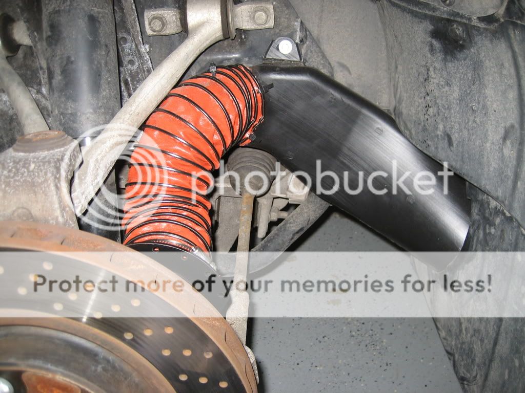

0Lambert_Automotive
Former Vendor
Lambert_Automotive's Avatar
Member Since: Mar 2007
Location: Highland IN
Posts: 314
Received 0 Likes on 0 Posts
Originally Posted by Silverton
I just received an estimate of 7 hours labor for installation of brake ducts, hoses and spindle ducts on a C6 Z51. That was way more than I expected. Is that ballpark, or should I be looking elsewhere?
If you have to remove the hubs to install the kit and the person has never done it before perhaps it will take that long.
Our kits should NEVER take that long to install. No hub removal is necessary with any of our Corvette kits, and they all come with detailed instructions and even templates for cutting the inner fender well of the C6 to accommodate the Z06 inlets.
A complete bolt on installation as pictured below:
Give us a call if you have any questions. Even if you are not using our kit brake cooling is what we do and we would be happy to help.
