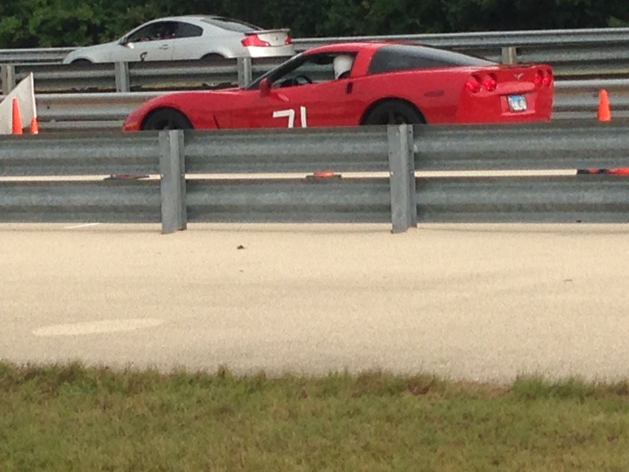

Instructor said I drove the line perfect, braking and throttle inputs were perfect. After third session noticed the belt was frayed, nursed it home and on further inspection noticed balancer bolt loose and balancer moved forward about 1/2". Replaced it with a powerbond sfi rated one and a earls/arp bolt. This must have happened before as the rack had wear marks, I'm glad I pinned the HB and also went with a aftermarket bolt torqued to 240 lbs with loctite!
