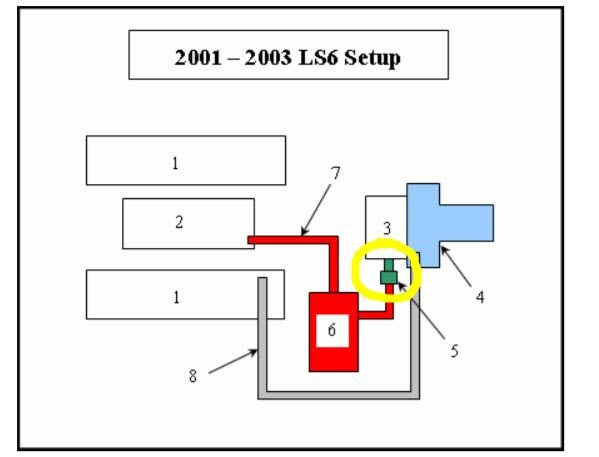

Can you post pictures to where the other ends of the catch can hoses go? That hose with a filter on the end (off the valve cover) is supposed to be feeding the catch can...
Kubs is offline
Sorry, this one shows the routing of the hoses better:
911tt is offline
Old 03-26-2019, 04:29 PM
wrkdWS6
CF Senior Member
Member Since: Mar 2016
Location: PA
Posts: 376
Received 30 Likes on 26 Posts
That guy (fresh air line) is supposed to enter the intake air stream not the catch can. If he had a stock LS6 TB the line would connect directly to the TB itself. With the LS2 TB he has, the line would go anywhere in the intake tract after the MAF and before the TB. Given that it is vented with a filter, I think it's ok as-is tho.
Routing into and out of the catch can is correct. I do not see a PCV valve in there where it should be (for a 2003 C5Z) which is between the intake manifold and catch can. In 2004, the C5Z got an internal pcv valve/oriface restricter thing whatever it really is which was installed in the tube coming out of the valley cover. Pop that line off coming from the valley cover and see if there's any restricter oriface inside like on an '04. Since you have an '03, your PVC valve is supposed to be located as seen below:
I was just noticing the same thing. Since the valve cover is vented I assume the PCV valve was omitted intentionally?
911tt is offline
Old 03-26-2019, 04:55 PM
wrkdWS6
CF Senior Member
Location: PA
Posts: 376
Hmm Iím not sure.
If the line coming out from the valley cover (hard line that comes out from under the intake manifold) does not have anything inside of it, I would put a PCV valve on the car just as it should have it between the the catch can to intake manifold connection. Iíd also toss out the breather and run a line from there to between the MAF and TB where it should be. Then I would see if that changes the levels your seeing in the catch can. Just my .02. Plenty of people run breathers but you may get an oily valve cover after a track day so I prefer the intended routing especially when diagnosing a problem.
I wish I had my car handy because I also have an '03 and have that same catch can and LS2 TB etc. and would take a pic of how the whole deal should look. When I get home from work here i will see if I have any pics on my computer that would help you out.
I took that line off and there's no restriction in it. Just a plain piece of hose.
911tt is offline
Old 03-26-2019, 06:23 PM
wrkdWS6
CF Senior Member
Location: PA
Posts: 376
Check out post #10:
https://ls1tech.com/forums/generatio...catch-can.html
Various posts here state the same:
https://ls1tech.com/forums/generatio...thout-pcv.html
I think we found the smoking gun
Great find! He makes a convincing argument. Also, without a PCV there could be excess pressure that could lead to oil leaks (unless the gasket cover breather prevents it). I'll go ahead and order a PCV to put in-line with the existing system to see what happens.
Edit: My setup is less restrictive than a factory PCV setup, not more. So pressure is not my problem.

Disclaimer first: I haven't actually done this to my car yet, but it's near the top of my to-do list.
Consider putting the check valve between the valve cover and the little air filter, so that it only allows air to enter the head from the filter. Manifold vacuum will pull the valve open at low throttle. At high throttle, the check valve will close, and blow-by fumes will flow through the catch can and into the intake manifold, propelled only by the blow-by. That way, 100% of what flows out of the crankcase will also flow through the catch-can. I like the idea of watching for changes in catch-can fill rate for signs of trouble. Opinions differ about the wisdom of pulling blow-by into the intake manifold (even with a catch can) but I think the risks are overrated.

At one point I was thinking about placing a check valve in front of the breather filter so that the breather can only pull air into the valve cover and no oil can come back out the other direction. After all, pulling clean air into the crankcase is the breather's only role, right? The reason I initially rejected the idea is because it seems the breather is designed to work both ways, sometimes allowing gas to exit, especially when the manifold isn't generating vacuum, i.e. WOT. That concept makes some degree of sense, but if pressure does build up in the crankcase, I'd expect it to vent through the valley into the PCV valve, so now I'm confused.
Your suggestion got me to do some additional reading. This site has an interesting write-up: https://www.aa1car.com/library/pcv.htm that I think is better than Wikipedia's description.
The key piece that I was missing before is that with a typical spring-loaded PCV valve, the valve is fully open under decel, but being fully open actually provides minimum flow, which is good because there's very little need to vent crankcase pressure, so you don't want to be actively sucking oily air out of the crankcase and back into your manifold if you don't have to. Under WOT, the valve is partially closed due to lack of vacuum, but this actually provides maximum flow. Again, this is what you want because WOT is where you see maximum pressure and the whole point of the system is to keep the crankcase from pressurizing. When the car is off, the valve fully closes because nothing is acting against the spring.
My thinking is that under WOT, if enough pressure builds in the crankcase, the PCV valve could be pushed to its fully open position, which would then minimize its ability to flow and release pressure. That's where the breather comes into play. Under WOT the breather provides an additional pathway for pressure to dissipate.
So I don't imagine you'd want to put a check valve on the breather because that would prevent it from providing additional emergency venting from the crankcase when needed.
If you're suggesting putting the check valve at the breather instead of between the valley and the manifold, that seems like a bad idea because (in theory) the reason I'm getting so much oil in my catch can is because of my lack of PCV valve (I really love using italics to emphasize words). Again, the lack of PCV valve means that under decel, the manifold vacuum is completely unchecked and I'm pulling a huge volume of oily air through my catch can under conditions where there is no crankcase pressure to vent. It's a wasted effort.
What this doesn't explain is why the 2004 Z06 (and later cars from what I understand) switched to an orifice-style valve. The orifice would lose the ability to regulate airflow based on driving conditions, instead it would just limit maximum airflow. Maybe the spring-loaded PCV valves are prone to getting stuck, which would cause all sorts of problems, especially if they were stuck closed. If you're running a catch can setup that would be much less likely to happen because the air coming out of the catch can should be much cleaner than what went in.
A few days ago I had no idea what a PCV system was, so take this with a grain of salt, but this would be my summary:
  • A PCV valve between the valley and the front of the manifold is necessary because it intelligently regulates flow from the crankcase back to the manifold to avoid excess airflow, which is probably why my catch can fills so fast without one.
  • The breather should not be restricted with a valve because it needs to flow both ways, just in case the PCV valve is ever overwhelmed by crankcase pressure.
Assuming I'm right, the best method for dealing with an oily breather situation would be a second catch can positioned between the valve cover vent and the breather filter. With a second catch can I would feel better about routing the breather all the way to the air intake since there would no longer be danger of feeding oil directly into the intake and gumming up the MAF sensor.

1. Get dual cans and put a can on that fresh air feed line in the VC. You can't have the PCV going to the manifold and the fresh air on a breather. You're pulling unmetered air into the engine. Air goes in through breather cone, down into sump, out valley cover, then into manifold and MAF never reads it. (http://www.saikoumichi.com/Stage1_LS1_page.html)
2. Your leak up front could be from a few different things. If the timing cover was installed off-center when torqued it will wear the front main in short order. The "old school" way was to leave the cover loose until you insall the balancer allowing it to self-center and then torque. Or, if you have an ATI pin kit the hub is the perfect tool to center the timing cover as it's the same size as the balancer hub. I'd do a new timing cover gasket, new front main seal, and an ATI super damper. Get the 10% underdrive steel hub. 25% exists, but many thing it's too small to provide sufficient crank harmonics damping for a track car; OK for drag race.
