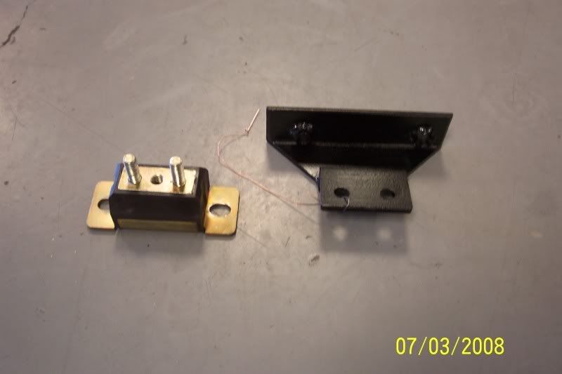

I'm very passionate about this upgrade to my car. This along with the jeep box that Jeff Silverslash recommend, are everything he said they would be. I have had such positive results from his guidance, with one exception his install on the trans. I would call him and tell him I had to do this our that, and he would agree and tell me he also ran into that problem and resolved it. All I want to do as he did for me is eliminate the BS that some of those out there are experts on and have not done the deed so to speak.
Both trans. World and non use auto. trans. fluid.
I paid $350. for non world and bell housing. + 200. to make sure it was ok and that included new seals, no leaks so far.
There is not a big difference except for the speedometer take off, non is a mech., and world is elect.
You'll have to build a new transmission mount to except the new trans., and to get the right angle to avoid vibration which you will have.
I'm not an expert just trying to help those how want to do this avoid the pitfalls I ran into.
