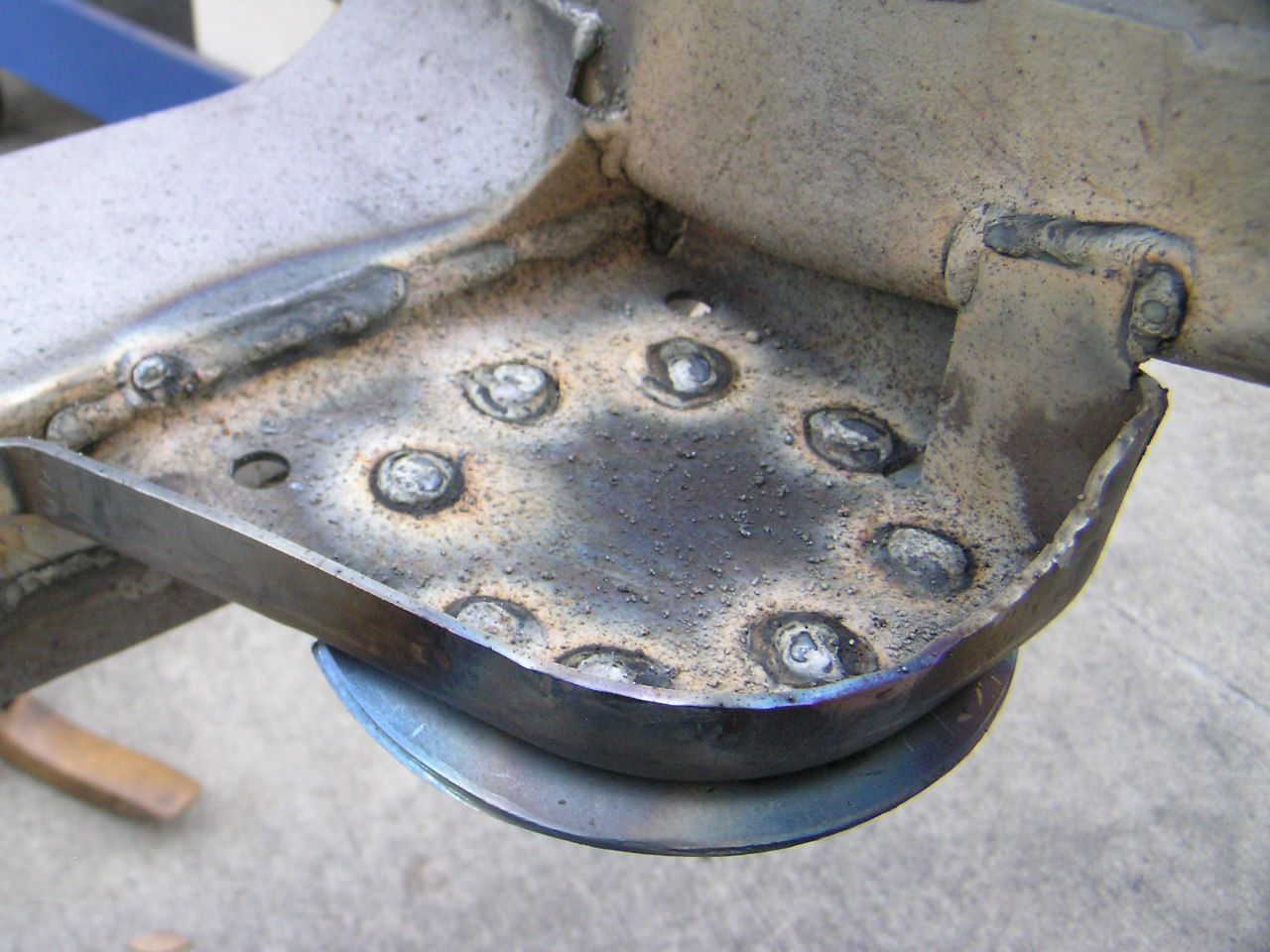

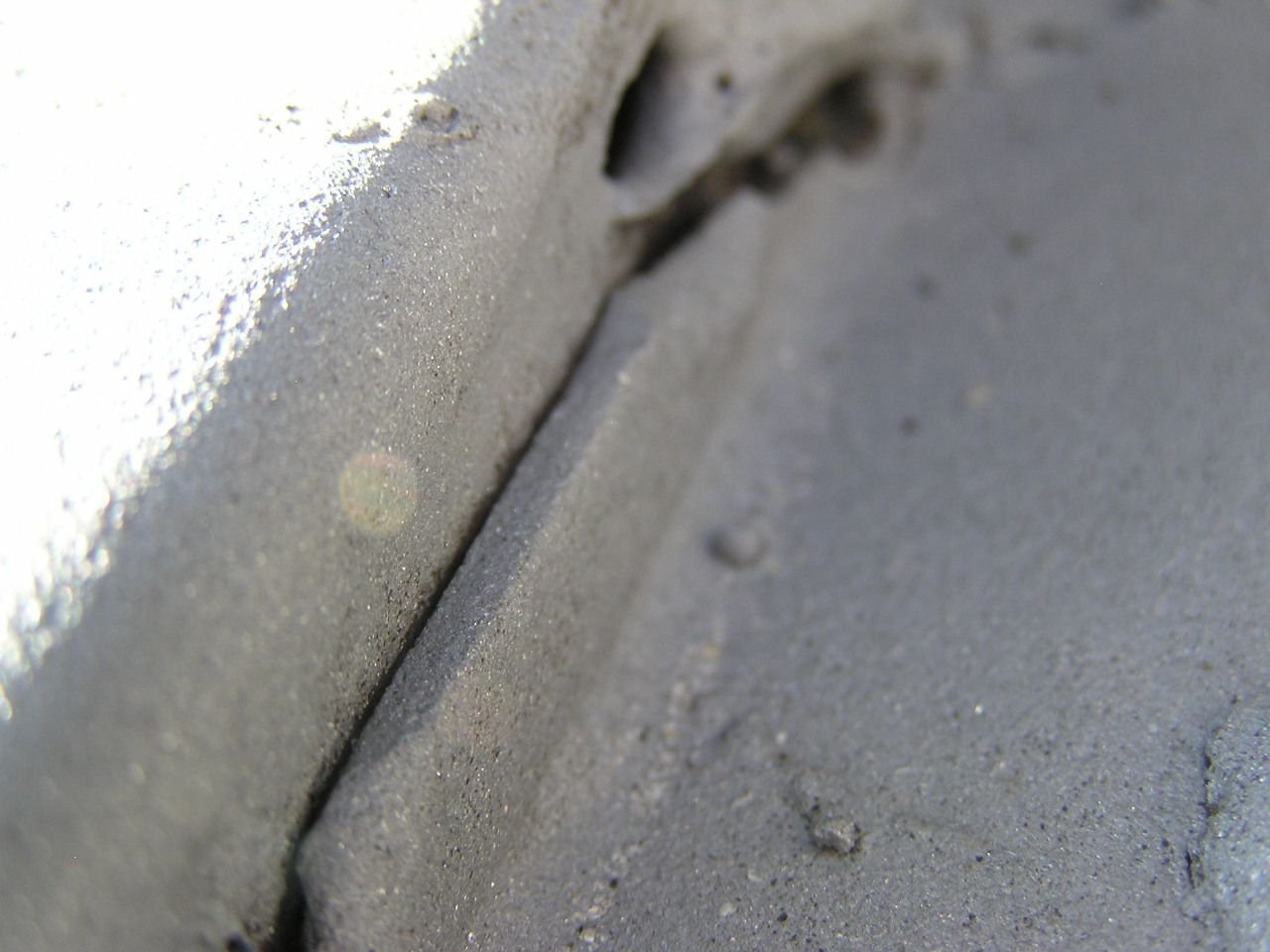

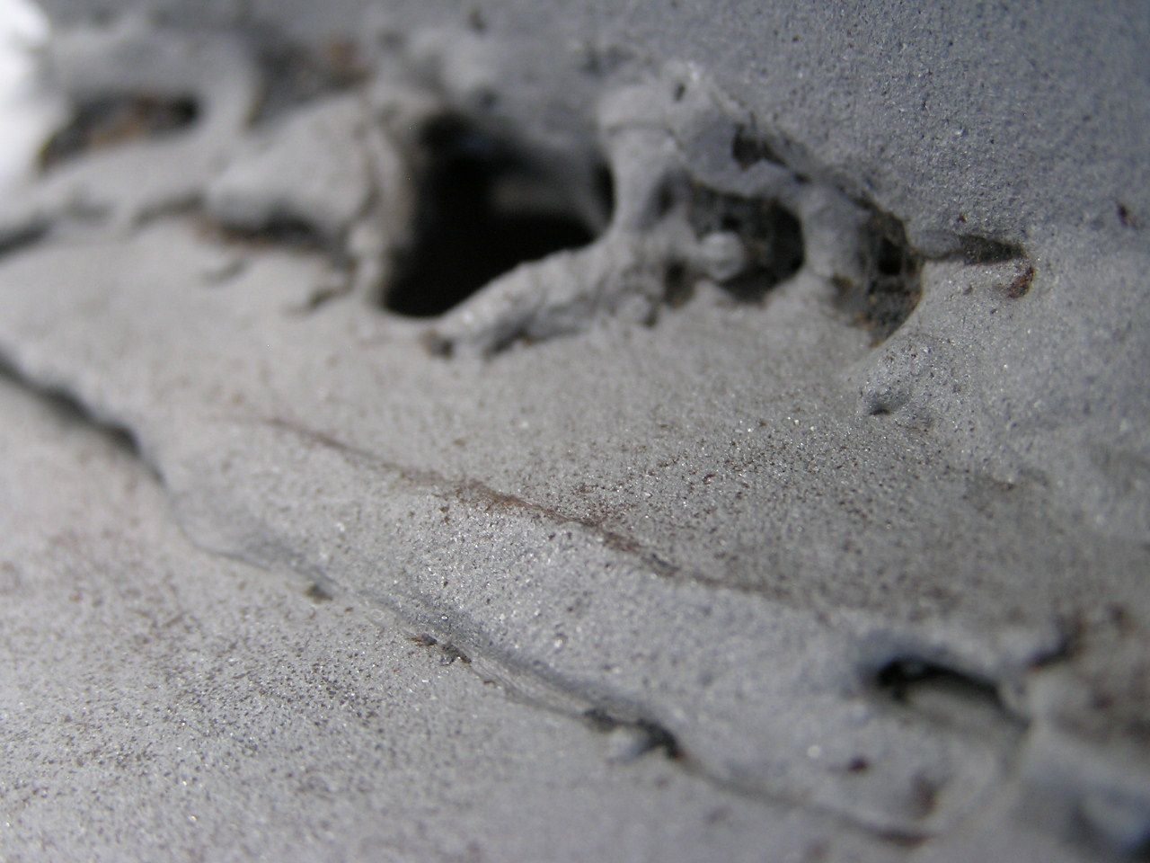

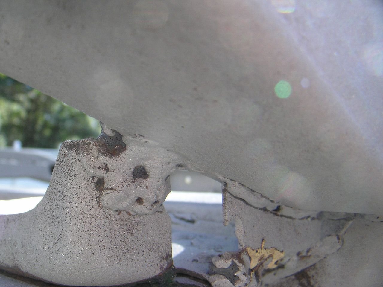

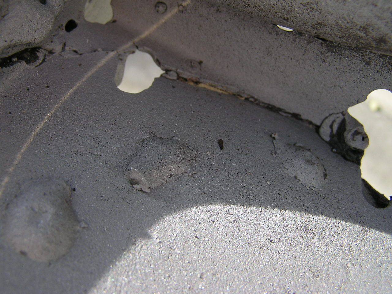

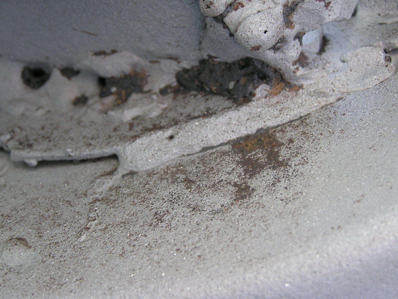

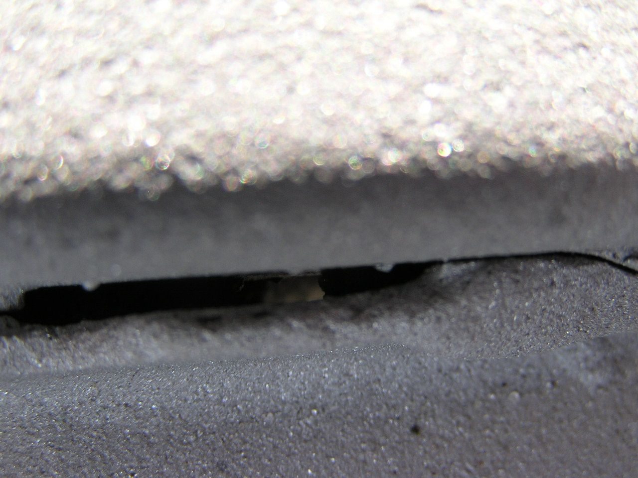

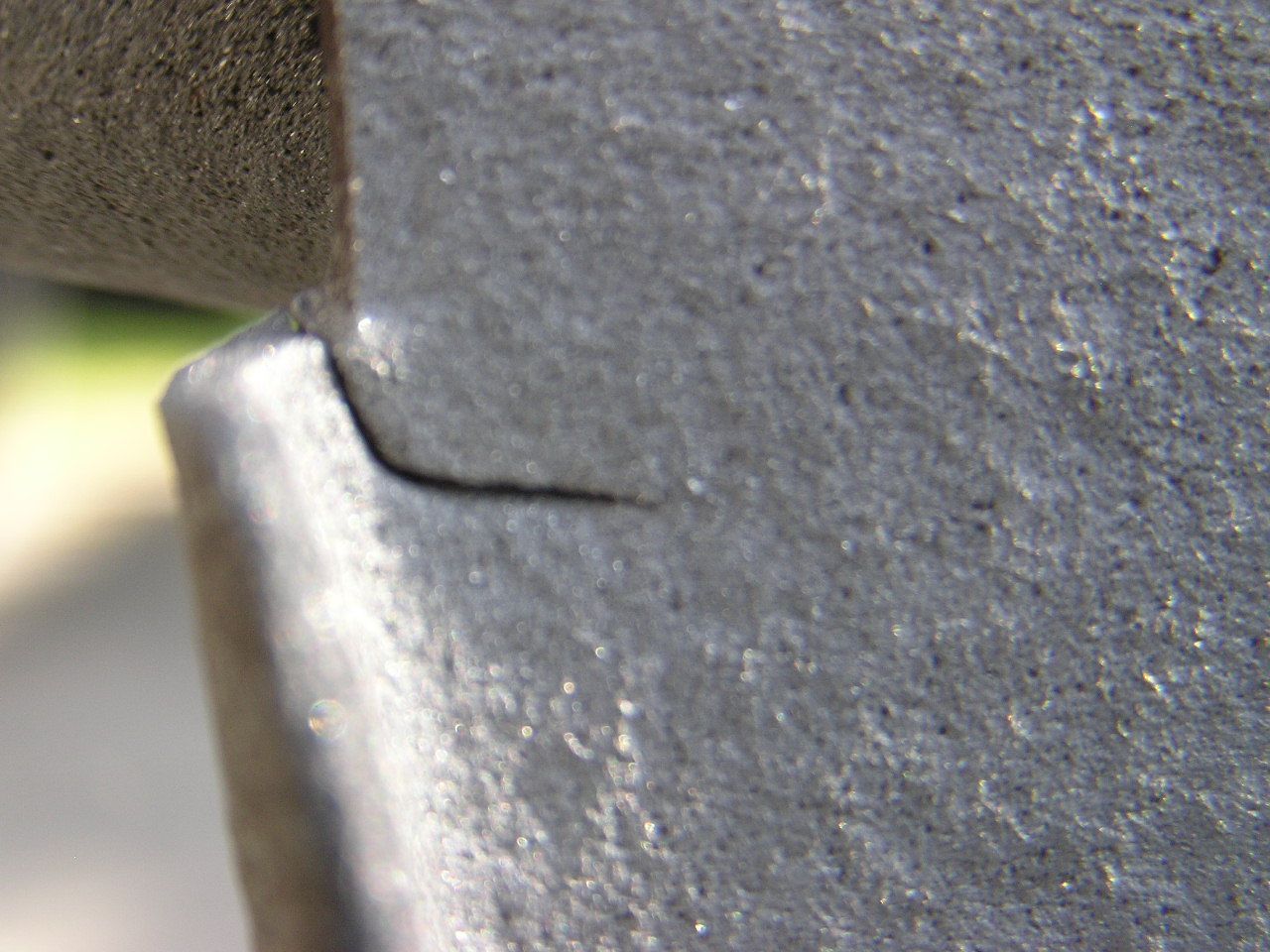

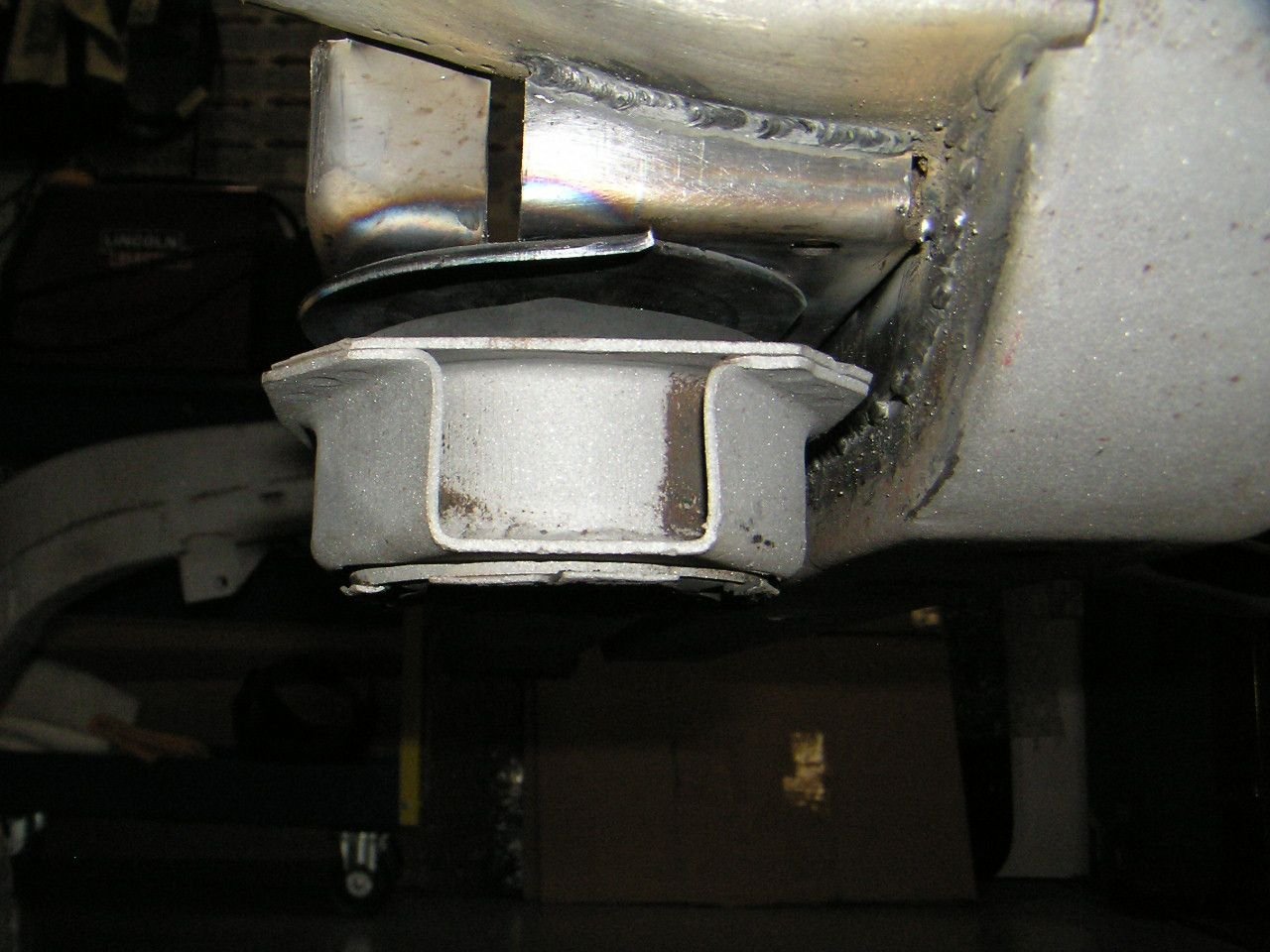

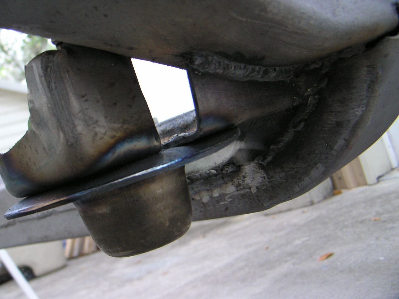

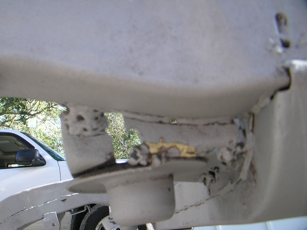

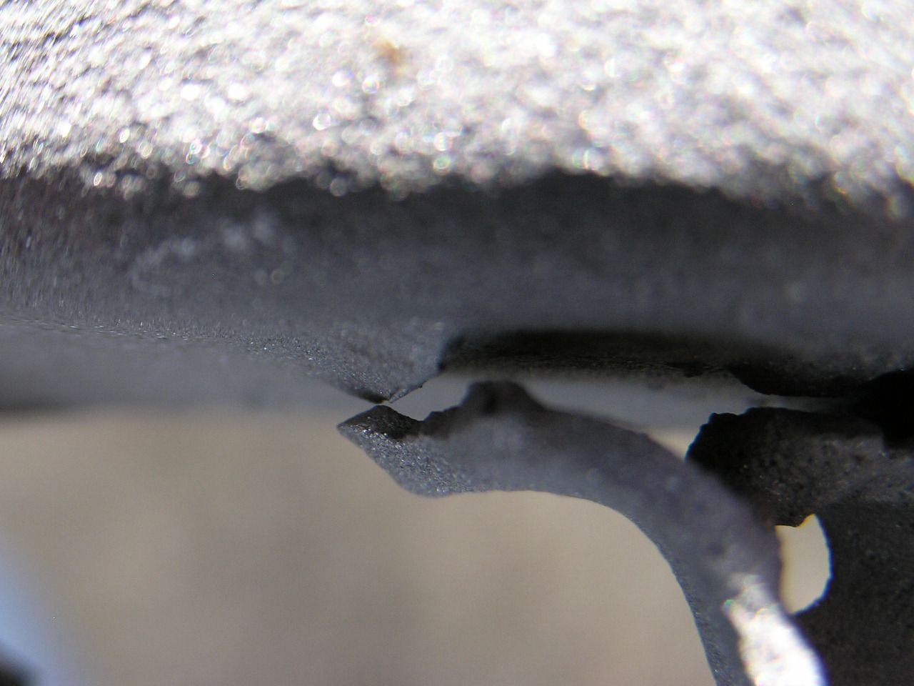

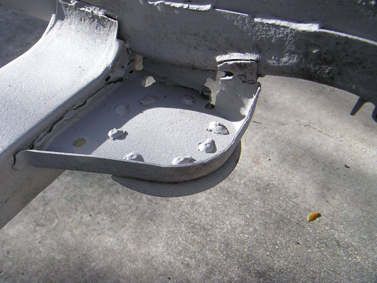

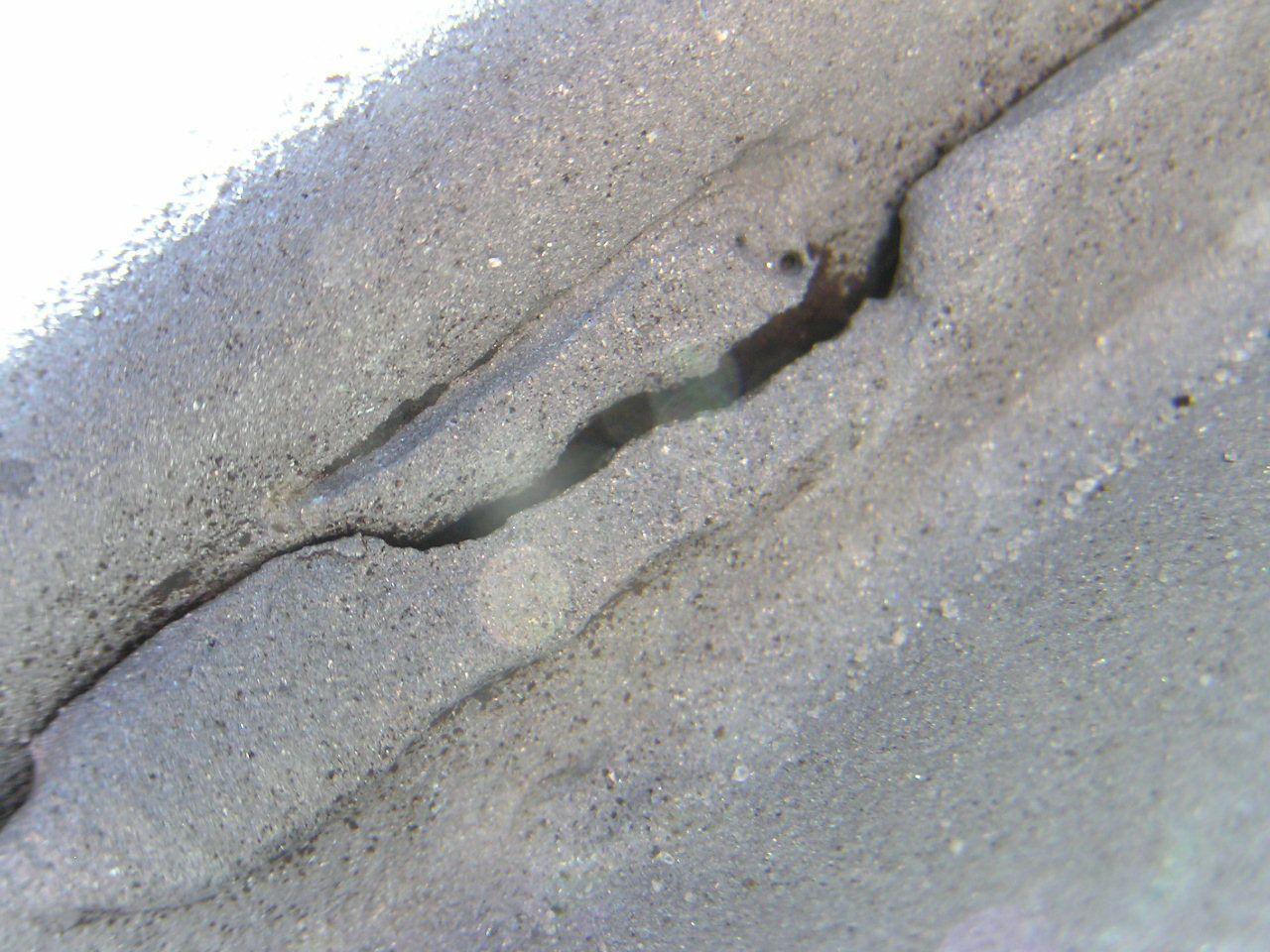

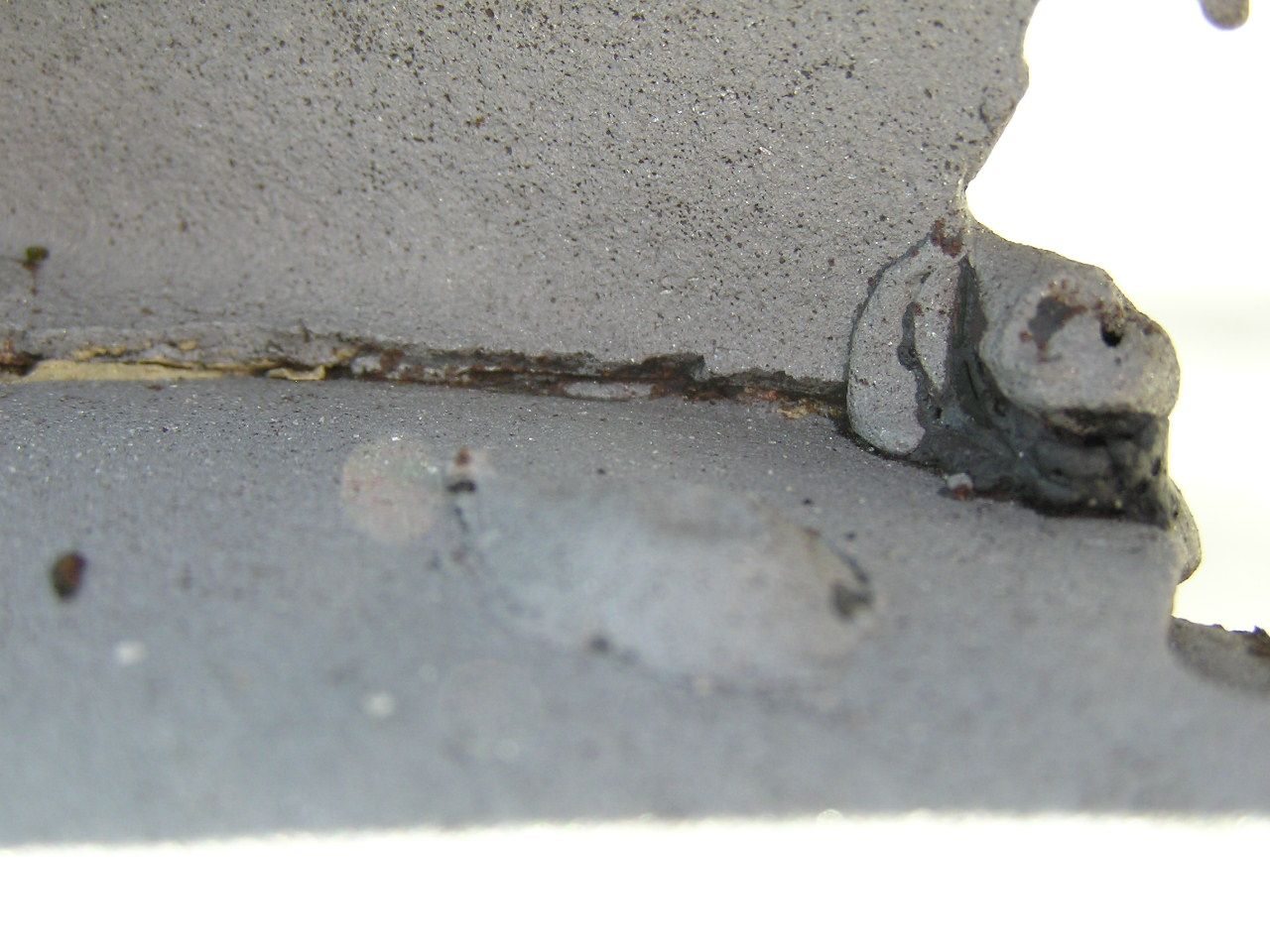

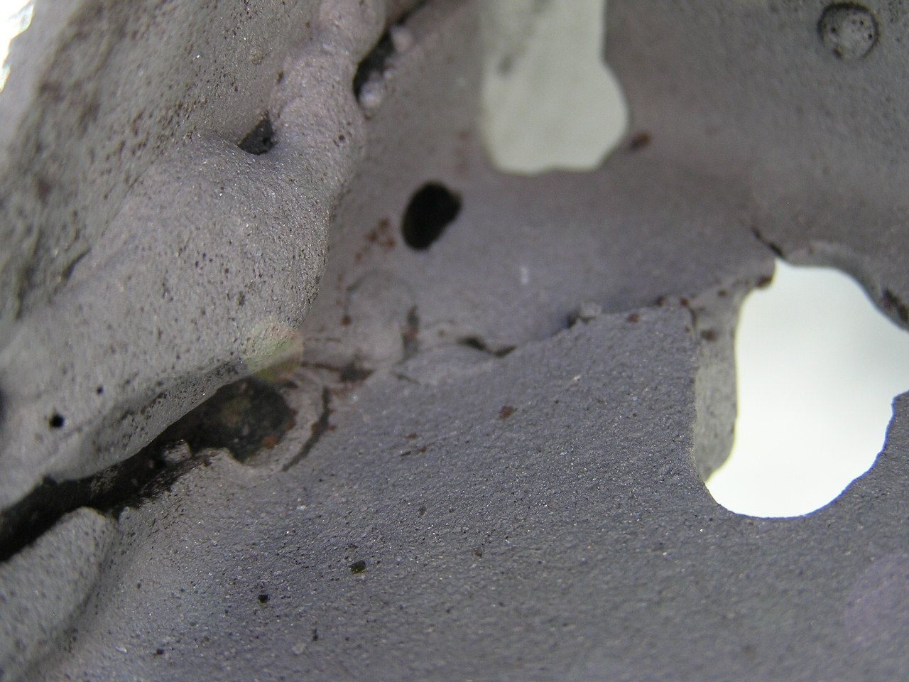

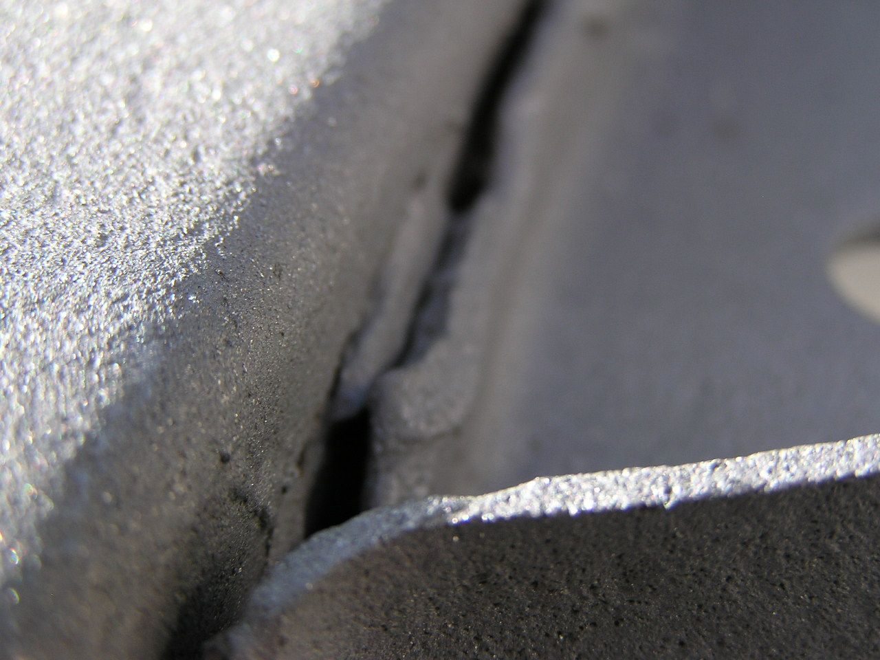

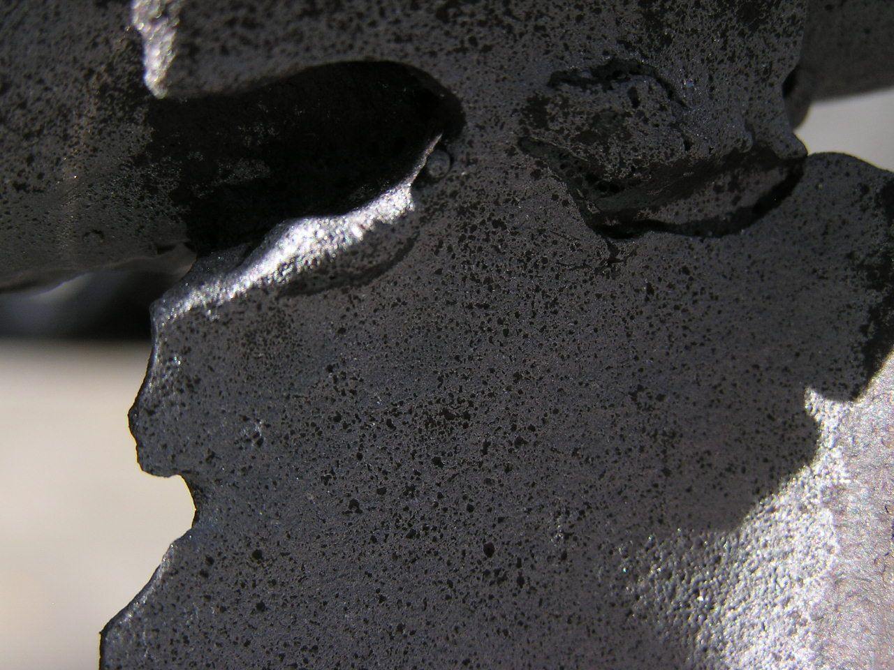

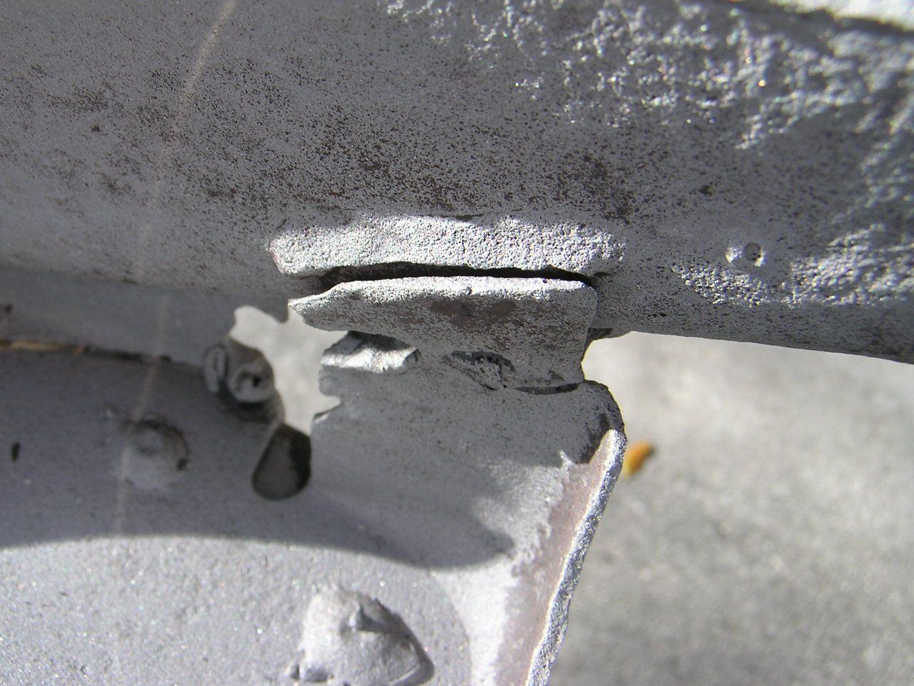

Since it was originally a BB car, I would carefully inspect the differential crossmember gussets/sombreros. They are a bit of a weak link.
These pics from JohnZ outlining the common problem....
Before body-off on a '67....The Driver Side on this one was poorly repaired years ago. It tore away from the frame and was brazed, hack welded, and covered up with heavy black paint. It was recently replaced as part of a body-off chassis restoration.
After body removed and media blasted....
Replaced......
Replaced......
Thanks for all of the replies guys.
Rich, I will look into that area of the frame. I know the history quite well on this car and I dont think it has any major frame issues. But the car was heavily raced on the street back in the 60s-70s. And I have heard the car pulled a boat a few times. Yes, insane I know. Let's just say that my cousin was a free soul back then. lol
