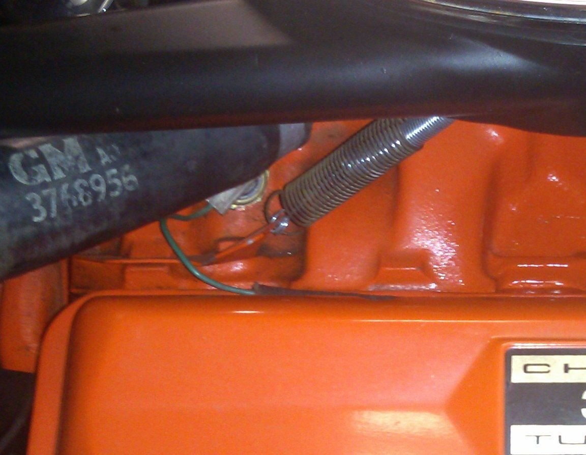

Here's my 65 300hp spring attachment. I added the shinier spring you can see on the inside to have two springs in case of failure of one.

Your spring and bracket should look like the photo in post #3 - it doesn't attach to the oil fill tube.

Again, this is two springs instead of the stock one spring:
