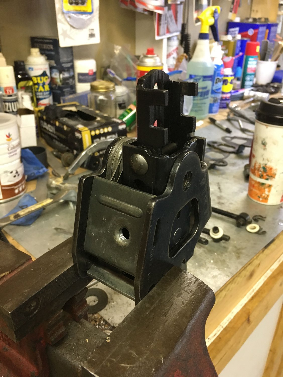

I've been busy with non auto related projects but finally had a chance to get on with it again.
I had two shifters that didn't fit my application, so I combined the two, now I have one good shifter.

I'm diving into my Carter WCFB's. They were supposedly restored/rebuilt, one has a bad accelerater pump. Fun stuff.
