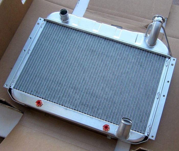

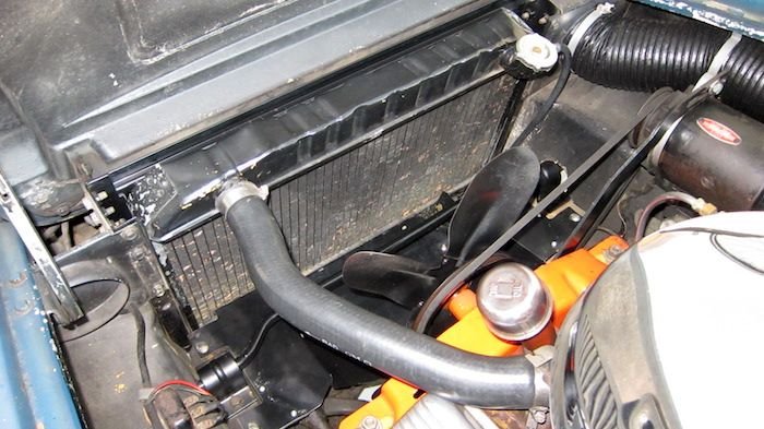

It’s way past time for me to finish up my radiator installation. It’s been about two decades now. This all started when my original radiator sprang a leak. I looked around and couldn’t find anyone who could recore the original here in FL.
I called ZIP and they gave me two choices. They had one that was a perfect fit and one that almost fit. You know I went for the cheaper one that almost fit.
The ZIP replacement wouldn’t allow for the upper half of the shroud to be bolted into place. Screw that. Who needs an upper shroud? Now for the last few decades I’ve been driving around with no upper shroud.
The car never really overheated based on my infrared scan gun readings. It did though dump a lot coolant in my garage after a long drive. That’s a sign of overheating but these are my temperatures after an hour’s drive.
Upper Radiator Hose: 168º
Radiator: 175º - 179º
Lower Radiator Hose: 148º
I’ve finally decided to take care of all this. I’m going to spend a lot more money than I ever thought possible but then again I’m the guy who spent $1,000 to have my seat belts restored.
Costs to Date:
Dewitt Radiator: $659.99 (DeWitts Radiator)
Upper Shroud: $199.00 (Corvette Central)
This is what I've been driving for the last 20 years.
This is my new radiator. It's a work of art.
Here's my new fan shroud.
This is going to get interesting. Feel free to offer suggestions and advice.

Yes - I'll agree that the Dewitts radiator is a work of art - that was the very logical choice to replace your 20 year old radiator. Nothing beats a Dewitts . . . in fact, I plan on ordering a new one to replace the 50 year old radiator in my '66 when the yearly sale is announced in a few weeks!
Happy Holidays - and good luck with your project - let us know how everything turns out!

I was looking at my brand new radiator and just discovered that it has provisions for transmission coolant lines. Oh Oh
My 1958 Powerglide does not use a cooler.
I figured out the mistake.
I'm pretty sure that I ordered Model 1139055M.
They sent me Model 1139055A
I'm just glad it never really came out of the box. I can send back a perfect specimen. Plus correct radiator is cheaper. My wife likes that.
