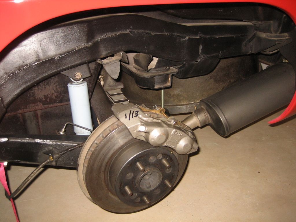

The last time I worked on my rear brakes I shimmed under the trailing arm and frame pocket to keep the wheels from drooping down. Worked well but you need something pretty tough as that point would make a dandy pecan cracker - lots of pressure from the spring and leverage. I tried some wood shims first and it nearly sheared them in two.

On the front, I would just loosen the control arm bushing bolts.
For the rears, what I have done is use ratchet straps to lift up the T-arms.
Mike Geary is offline   Reply With Quote
