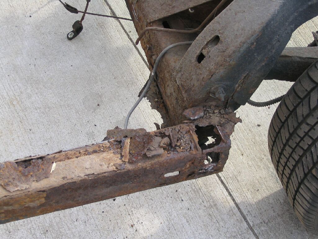

Showing my lack of knowledge with C2s on this next question.....
Is the frame area mentioned a common rot out section on C2's or could these spots just be poor welds / prep as it come out of the factory?

I'd have to go back and look at the pictures to remember where that patch was...now, I'm saying it looked funny (as someone else did also) it COULD be fine but isn't typical.
Whatever it is is NOT factory. Both C1/C2s are bad for rusting at the 'kick-ups' just before the rear wheels... Reason being that water, pine straw, gunk gets 'pushed back to that area as the car moves forward and can collect and decay over the years causing rust. This picture is a C1 (not a C2) but it will give you the idea. Again, the area needs looked at - could very well be fine...
The level of restoration done on the car would make me believe that anything like that would have been fixed - but believing isn't seeing...
The second pic shows one area of concern...on the car in question..

Here are a couple of frame rot photos specific to the c2/c3 frame.
