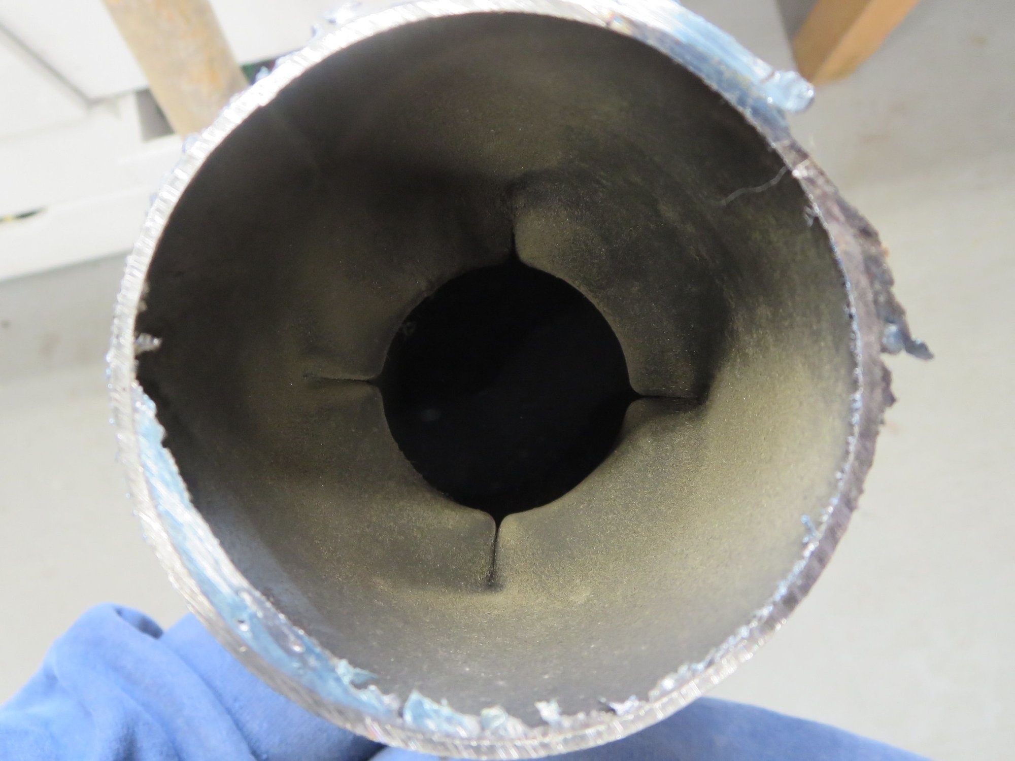

Mufflers with a 3 1/2" body will fit under the original shields. Classic chambered makes some - http://www.classicchambered.com/ and their site shows the retro-fit.
As far as no benefit, why do you think under car exhaust flows better & makes more HP than side exhaust? I just built the side exhaust for my big block using Classic Chambered mufflers with a 3 1/2" body and 2 1/2" flow path and they fit fine. If you wonder why the stock side exhaust is SO restrictive, here's a pic. of my factory sidepipe when I cut them open. The flow path is just under 1 1/2".

I have Classic Chambered 3 1/2" outer shell with 2 1/2" flowpath Vettepacks under stock covers with a tad wiggle room to spare. Four inch outers require a 1/2" rocker spacer which is available in the aftermarket. I dynoed my engine and it produced 414 RWHP with open headers. Thru the pipes it dropped only 8 to 406 RWHP. The sound is loud as all getout when you press to go pedal but mellows nicely at steady cruise and the sound is mellower than stock sidepipe mufflers.
Just so you know: anyone that says "you need some backpressure in order to make torque" is full of shlt.

Your posts in an old thread were the reason I went with Classic Chambered. I can't believe how restrictive the O.E.M. sipe exhaust is. I haven't fired mine up as I'm doing a body-off resto. but noise is not really an issue. It couldn't be louder than my Cobra was.

Here's 3" versions on a C2 - chambered all the way:
