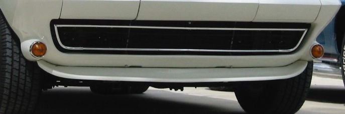

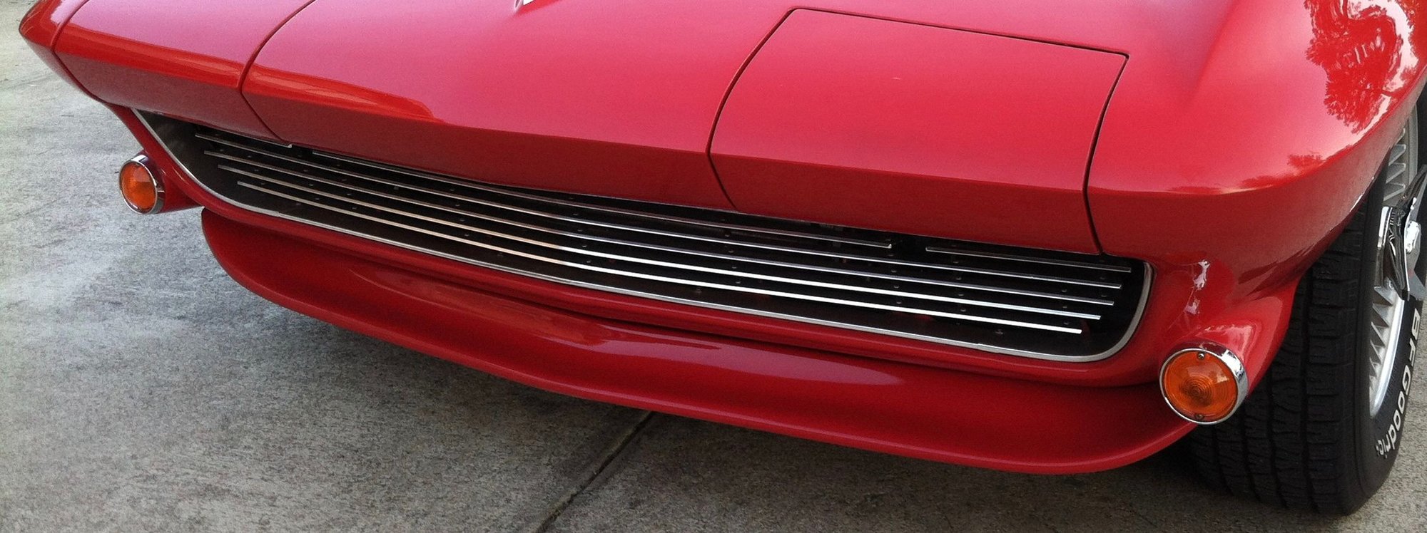

For 63 - 64, there are fiberglass tabs in the opening/mouth to mount the grill. So if you have a 65 - 67 and want to mount the earlier 63-64 grill, these tabs will need to be fabricated. There are also trim pieces for the 63 - 64 that line the mouth of the drill opening.
63 - 64 Grille
65 Grille (mounted to the front of the inner fender well)

Is the opening the same? Those pics look like not, also the left and right edge looks more vertical on the 63??

The opening is the same
