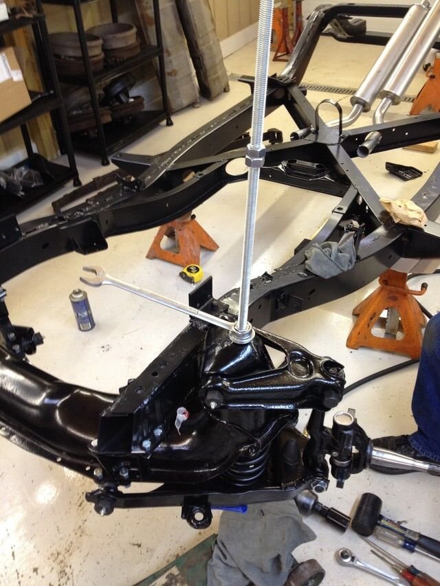

Here are two that I have made from All Thread.
The first two pics show the first one, made with a piece of boilerplate.
The second two pics show the second one, made with a piece of lawn mower blade.
I loaned the first one to someone... never got it back.
So, I made another.
