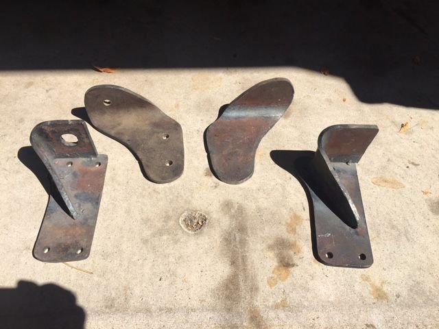

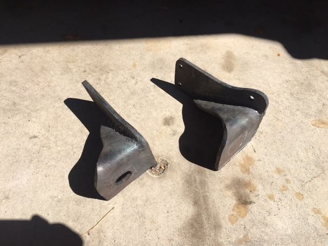

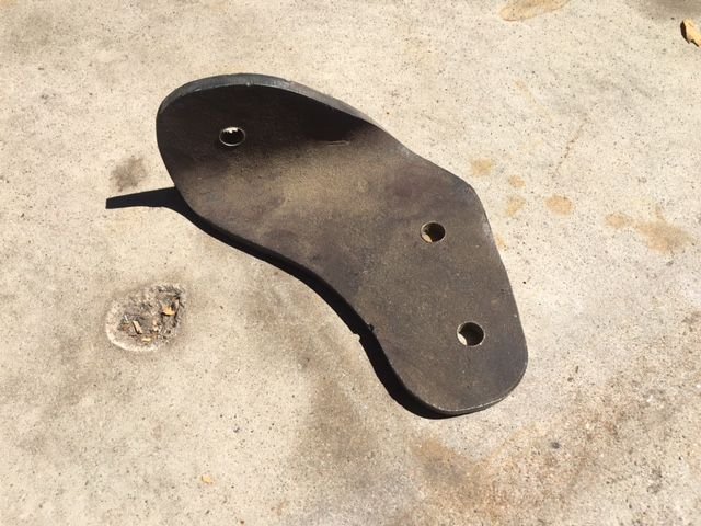

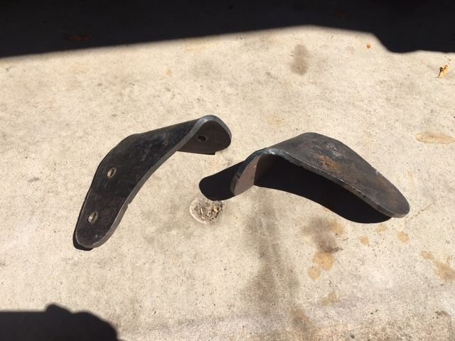

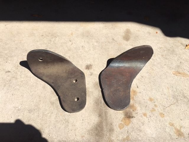

I will dig them out over the weekend. Since I posted earlier I remembered the name of the company. (Old timers disease). Herbert and Meek. I think they were out of So Cal and were bought up by Hurst. Their motto was we can put anything in anything - or something like that.
Vette5311 is offline

A long time ago a friend bought a motor swap kit from a company called Herbert and Meek. He was putting a big block in his 1962 corvette. I had a 62 at the time with a 327 and wanted to do the same thing, so he let me make a copy of his mounts. As I recall, although it has faded a bit with time, the uprights bolted to the same spots, brackets as the sbc did. But I am not sure of that as the difference in length is in the front on a big block. Distance from side mount to bellhousing is the same I believe. So maybe the brackets had to be moved on the frame. The mounts were designed to bolt on just like the sbc ones do. The pieces I call elephant ears, bolt to the bbc below the water pump next to the balance damper, same spot as a tri 5 chevy. The mount that goes between was to be the same as stock C1 rubber, but now they make a better mount setup from street rod people like Speedway Mtrs. that I would use. The mounts are made of 1/4 inch steel plate. There is a difference between the right and left uprights but I can't remember what. They probably only fit one way correctly. The thing I really liked about them is that they free up a lot of room for building headers as compared to conventional side mounts. Now instead of using the "elephant ears" brackets I believe I would use the front saddle mount that goes side to side and bolts on under the balance damper. Not sure if the height would work as is, might have to redo the height on the uprights to get the motor in the right spot height wise. https://www.ebay.com/itm/Speedway-13...e/381244396627 There is a plastic big block replica available to build with but kinda pricey. I would probably just use a bare block, but I don't have one at the moment. Hope this helps. Good Luck. let me know how it turns out, I'm still trying to decide if I want to do this with my C1. I really don't want to cut a hole in the hood, so that is my big problem.
