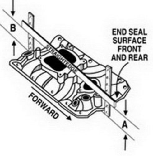

Originally Posted by Vette5311
I know everyone says you have to cut the hood. However I have never found anyone who can say they tried the LS6 low rise intake. If you've ever seen one the runners actually go down from the ports. I think it was originally designed for the C3 corvette but found greater usage in the 1970 Chevelle. I will post a picture and actually measure the carb pad height this week. I would really like to do this but I will not cut my hood on my C1
Carb pad height as measured in the first drawing is 2 3/8 front and 3 3/4 rear. I don't know what the carb pad numbers for the L72 intake are but I am sure they are much more than this. I believe this is the lowest BBC intake ever made by anyone. It was widely used on the 1970 Chevelle LS6. I believe it was designed for the C3 but have no way to prove that except it is lower than need be in the Chevelle. This one when viewed in side profile, you can see how low it really is. 4 of the intake runners actually go downhill from the port to the plenum. I gotta believe this is detrimental to intake flow. I find it really hard to believe this would not work on a C1 without cutting the hood but of course that is just speculation. The only way to know is to try it and by then you would be so far down the road it would be hard to turn back and as I said, I really do not want a hole in the hood.
Dr L-88 (09-24-2018)
I just measured my L88 intake (#3886093) and it measures 5 5/8 rear and 4 1/8 front, so that is nearly 2 inches taller than your LS6 intake. I am inclined to think that just may be enough to avoid cutting the hood. Of course a dropped base air cleaner would be required and there is the possibility that an air cleaner could not be used.
Thanks,
Rex

Or a drop base air cleaner with a 2 inch element instead of the standard 3 inch may do the trick also.

Received 1,249 Likes on 837 Posts
Default Intake height
ok I've decided to attack this from a different angle. I need to establish a baseline to calculate from. So.........does anyone know the tallest intake that will fit under the stock hood of a 57? I called Edlebrock and they said they did not know but they do know an air gap intake is to high. Has anyone here ever tried the 327 GM high perf intake from a 365 hp or is it to tall also? OR does anyone have a stock 2x4 intake and can measure it as described in the drawing posted above?
thanks for any help.
