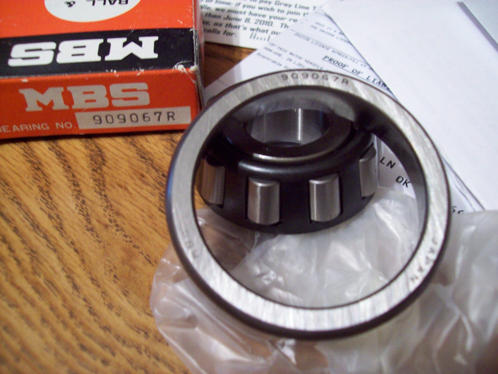

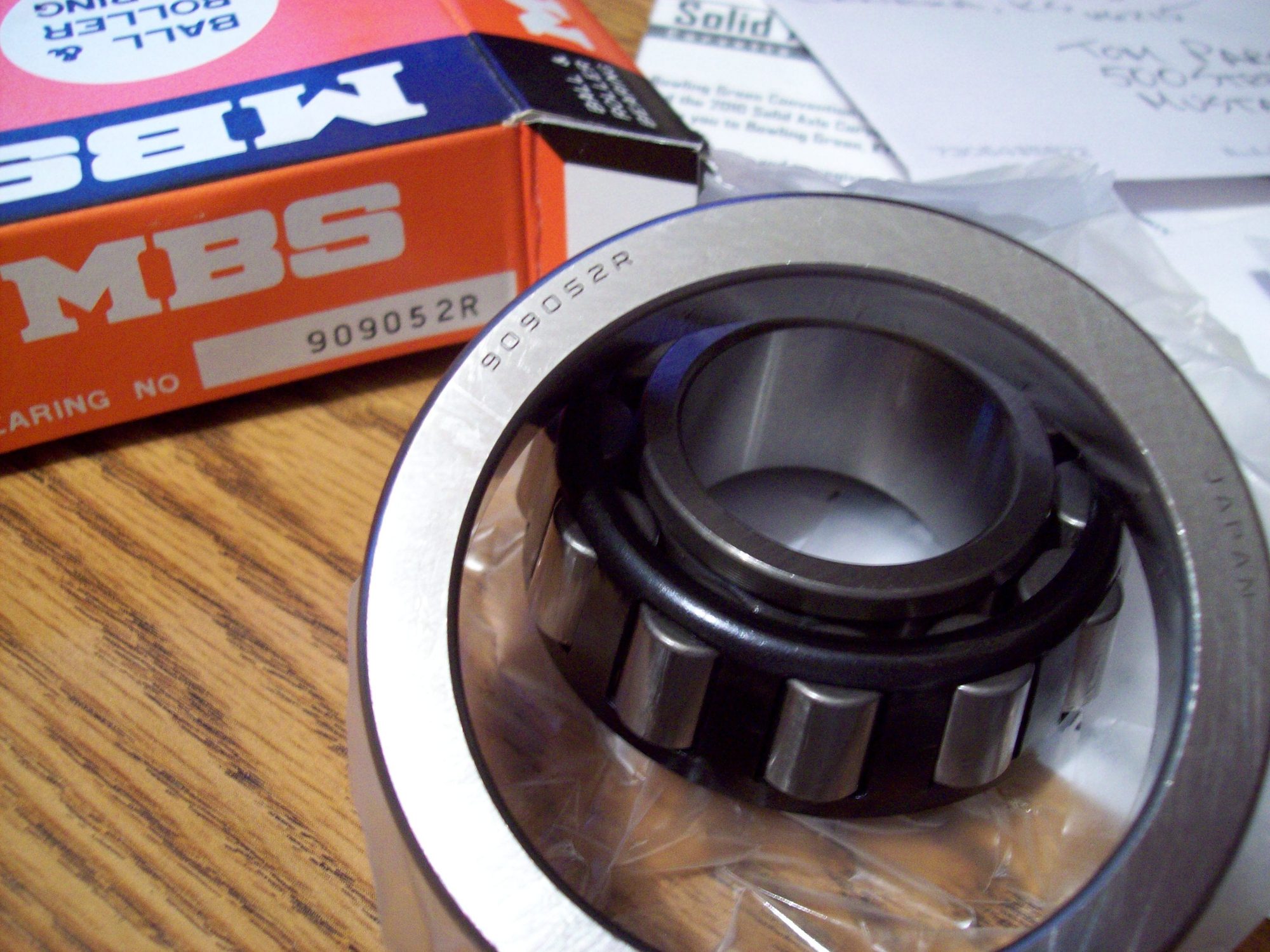

I did find these. Price seems reasonable compared to the ones described in the older threads.
I have no affiliation whatsoever with the ebay seller. Just wanted to share in case anyone else is considering the conversion.

YEP, I've posted this several times over the years.
https://www.superpages.com/bp/los-an...0018138791.htm
The aftermarket sources (Corvette Central, Paragon, etc) have them ------------------------- but at about TWICE the price. I have them on the 56 and I am a big believer in the conversion.
MANY, MANY years ago, Roy Braatz was the person responsible for making this known.
These bearings are NOT, repeat, NOT available through local bearing sources or at the local auto parts store.
