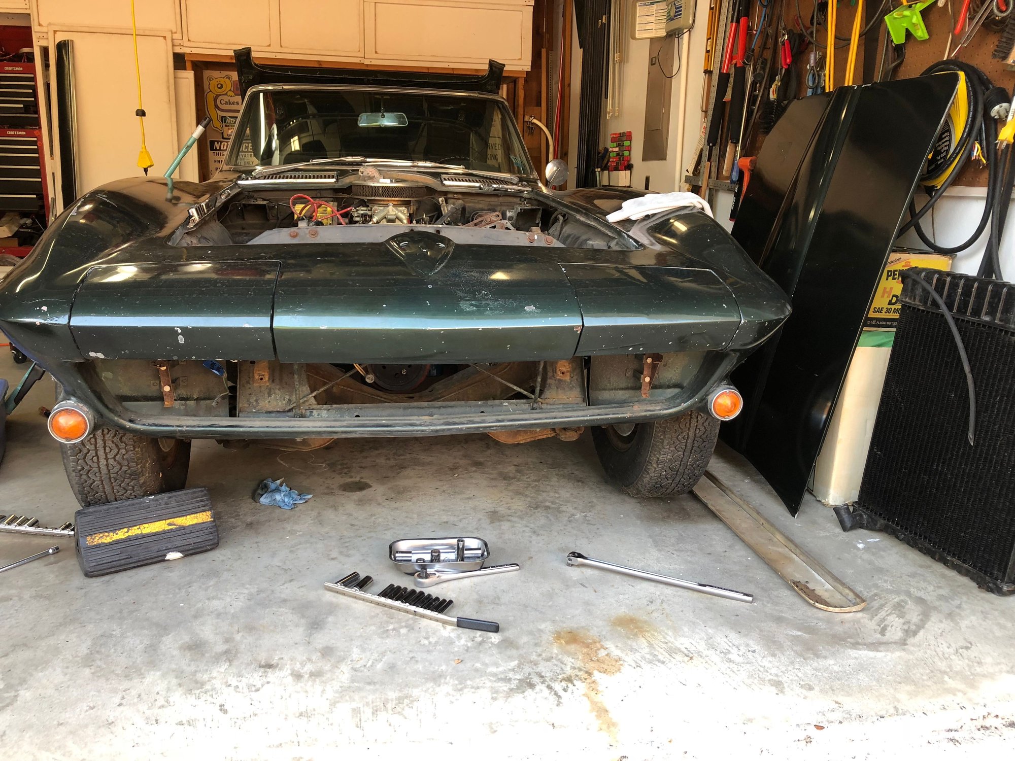

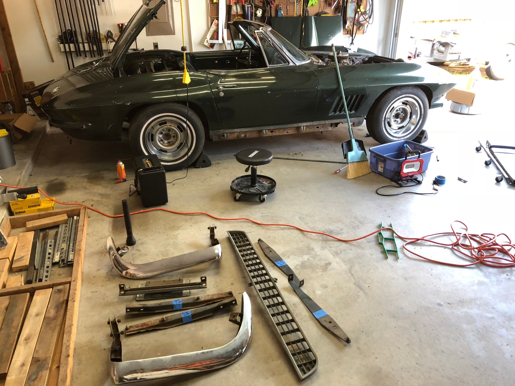

Default Restoration Officially Starts
I guess I will say last Friday was my official start to restoration by getting the body ready to lift off. I started on the rear a little on Friday. My son and I worked together for about 5 hours Saturday and I spent another 4 on Sunday. I think I could go longer but the wife would get upset if I rerouted the living room A/C to the garage. Radiator is out along with misc body parts. I removed the grill since it was only hanging on with the top center screw. I don't know how many bubba's had this car before my brother, but I guess it is actually kind of nice in a weird way. I don't know how things did not fall off this car. Every piece is missing a bolt or two or even more so things come off quick. Down side is that some of the bolts on the same mounts are different sizes. If you have never used Aero Kroil rust penetrator, its great. Giving the body mount bolts a shot day and hopefully they will not fight to much. In the overall pic of the body and parts you will see the long strap between the broom and stool on the floor. That is the mounting bar at the bottom of the body for the long lower strip panel. Was I supposed to leave that on for body lift? I have seen pics with it on and off. Also, can that bumper brace be straightened or do I need a new one (pic of braces side by side)? So far I am either bagging screws or taping them in their location on the part they came from as well as photographing before removal. Here are the current pics.

I would straighten that bumper brace and not think twice about it. Others may have the best way to straighten but that part is old Iron and it will live to play another day.
I have Kroil and use it as needed but you might wish to know that a 50/50 mix of Acetone and Tranny fluid has proven to work better than Kroil. Kroil may be better than all others including PB Blaster but the 50/50 mix has proven the best to break down rust for bolt removal. Hope that helps.

I got the kroil free, but just one can. I do have some trans fluid and acetone. I’ll add that as well. Thanks. So do I need to put that bar back on the lower body before I lift or is it okay without?
If you are talking about the metal strip just below the door, that's what your lifting clips fit under. Otherwise you're lifting on fiberglass. I have not explored just what that strip is attached to, or how, maybe I don't WANT to know, but mine were both on for the lift.
I took my strips off prior to lifting the body from the frame.
My "clips" on the sling actually lifted by reaching up under the edge, and up to the bottom of the birdcage.
I really don't think it matters either way if the metal strip is on or not.
Pat
NOT having the strips on would help the clips fit better, mine seemed like they needed to be spread wider. Maybe that's why, perhaps I should have removed the strip.
