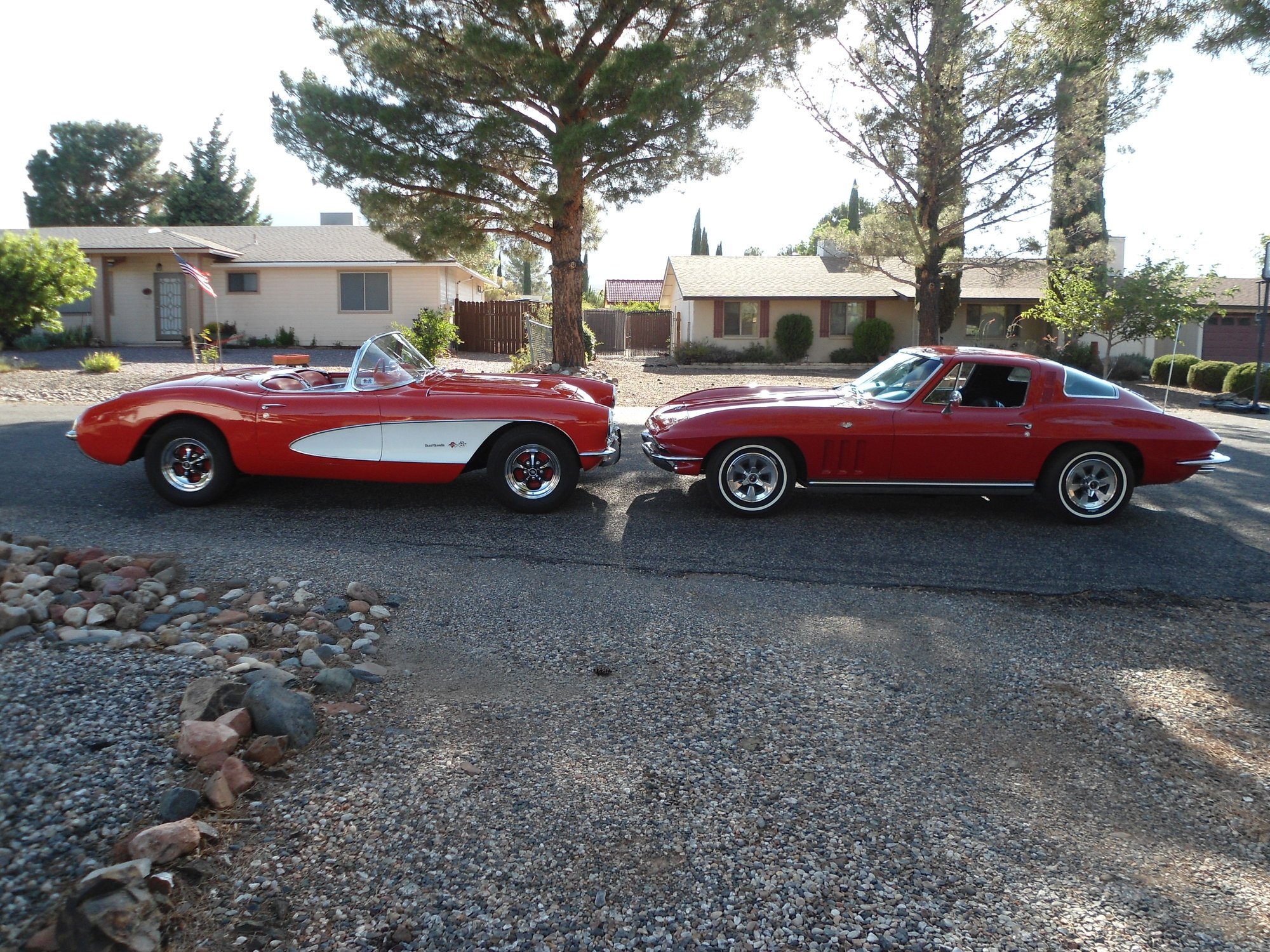

I applaud you guys on your ambition of these resto/builds.
Having lived in the NW corner of Illinois until 1981 I am only too familiar with the rusted bolts and frames on old Corvettes and can say that I certainly don’t miss any of that since being in AZ. since 1981.
Looking at these projects makes me feel so bless to have my forever southwestern states rust free 1957. I also this past year bought my 1965 from N.Y. state but was lucky enough to find an original 76K mile car that had never been winter driven and always garaged that is totally rust free.
I will be thinking of you guys for the next year or more while I am driving my cars and you are working towards done cars.Best of luck to all of you.
