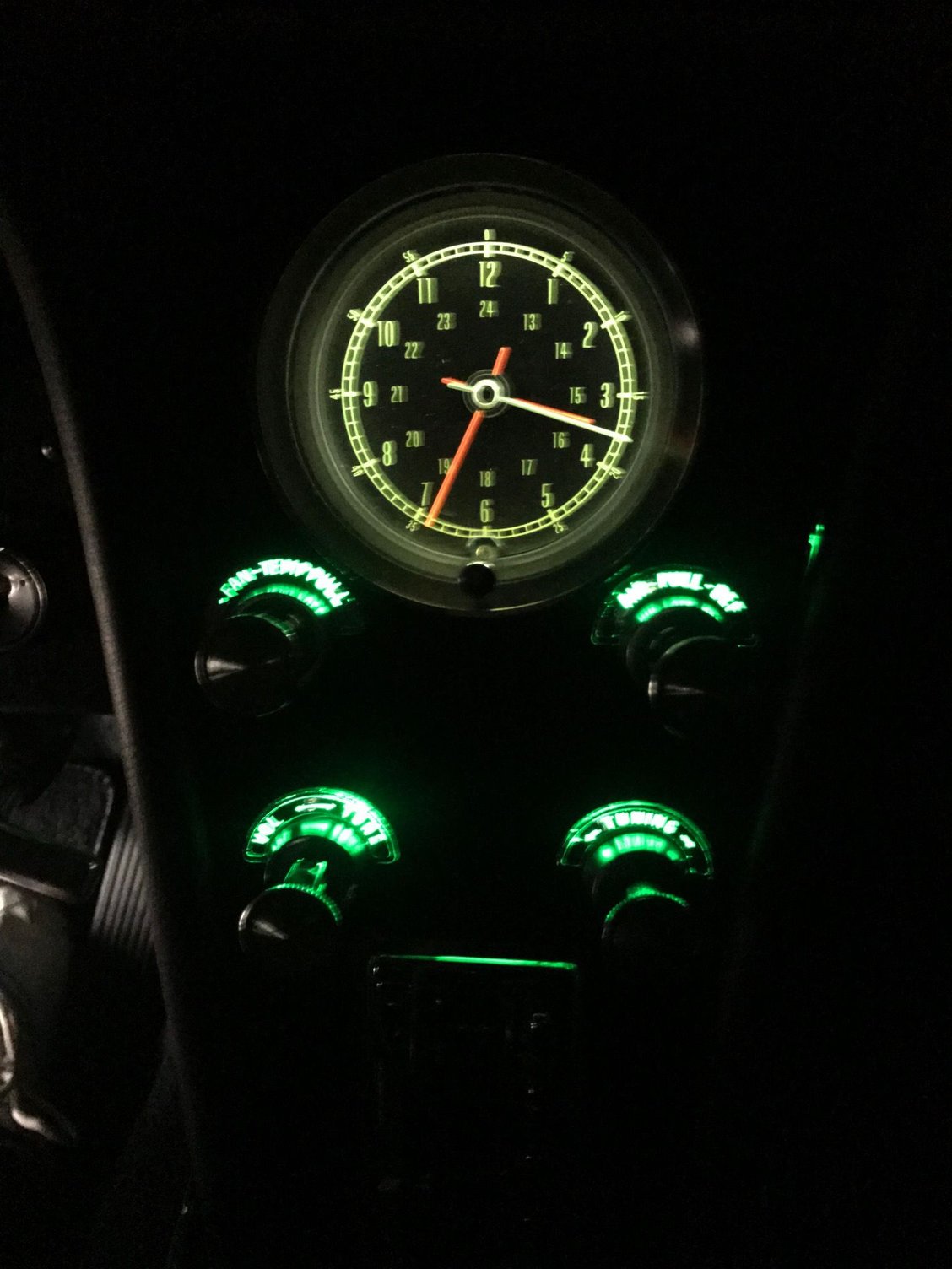

Check out my dash. I used a LED BA9 (green). It lights up the bezels the way they should be lit. It did require cutting off the end of the torpedo fixture.
Is that just ONE bulb lighting that up so nice?
Yes, Just one green BA9.
I think I could read a map at night under those. Quite a difference.
