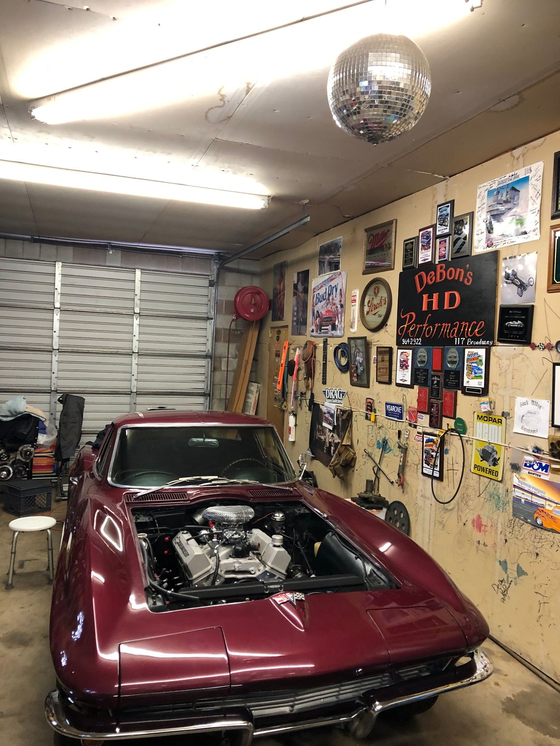

It's 7.09 Saturday morning 31 degrees and snowing. Going out to the garage and building a fire. Today the new 383 stroker is going in the 64 there will be updates. These guys will arrive once it warms up

As you can see I left the trans in the car this will be a first for me I've never put an engine in with a manual trans in place.

It's finally warm enough in the shop. disco ball out hoist in. Remember pilot bushing

Ready set go. Man my monkeys are good and they work for beer

Ain't it pretty

FYI if you stab a engine in with the trans in place. The motor mounts need to be on the frame not the engine so you can just slide it on to the input shaft
