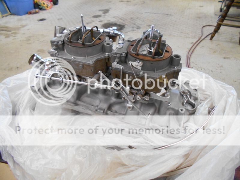

Gentleman. I have just realized that the factory 61 2x4 cast aluminum intake manifold on the 283" engine
will not fit on the new ,almost completed 327 headed engine.
the intake windows are quite a bit different in size..and layout.
the new engine is a 350" with the 66 327 heads.rebuild.factory cast iron heads.
obviously the intake windows on the new 327 is larger. my question is.
can I port the window of the 283 intake on the floor enough to make this intake fit?
is this a viable or realistic option? I am considering port volume further up in the plenum. (i am wondering if this is going to be a huge restriction?)
i am also considering that porting the floor will end up making the manifold to thin.
Is attempting to port this factory 2x4 intake a realistic option? I have not had a chance to study it yet.. but the floor looks to be were it will need the most grinding.
I want to keep the stock appearance.. keep the stock carbs linkage ,air cleaner. ect.
is there a compatible 327" 2x4 intake that would otherwise be the same?
is so does anyone have a recomnedation or part number for it.
or
IS porting the 283" intake manifold going to be a viable option with out much issue or problem.?
anyone have any advice to my situation.?

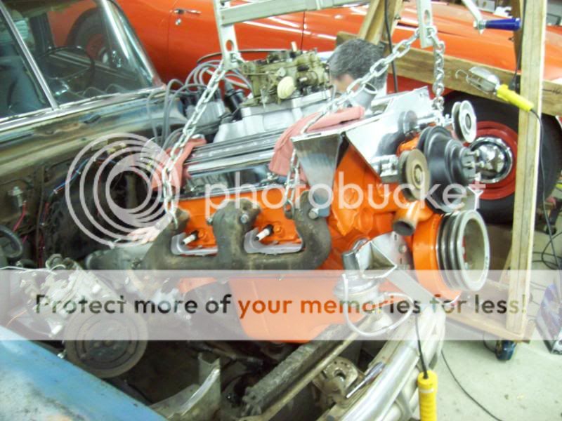

Yes, it can be done. I have a 1967 327 block with a stroker crank, Edelbrock aluminum heads with a port matched original 2x4 intake.

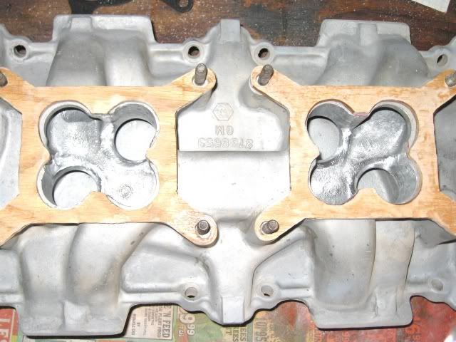

Not sure its helpful, but I have a 2X4 57 up intake manifold, I got at a swap meet years ago,, I matched it to a stock intake gasket, and it is cut somewhat bigger than stock,,, I figure a racer opened it up for bigger heads that were available at the time,,, maybe 327 or 350, but just a guess, as I found it in the 80's!!! I never put it on an engine to try, but seems there is some room to open it a bit... Its been used and I don't see any cracks, so it may work... Let us know!!!

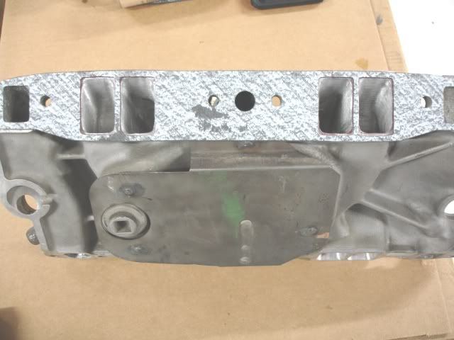

Like you I wanted to use my stock aluminum intake manifold on heads that had bigger intake ports. It was not 283/270 HP but a 327/350 HP/L79 intake to be installed on a GM SP383 crate engine with what they called aluminum fast burn heads. The tops of ports on the heads were so large that they were visible with the intake in place. So no gasket was going to cover the difference. I had a welding shop add aluminum to the tops of the intake and then had it machines for a flat surface. The additional metal added was about 1/2" on all 8 intake ports. The final intake was media blasted to erase any evidance of a modification. Now with correct gaskets the intake is tight and appears correct. The top of my engine is all L79 appearing... Al

We did this a few years ago. Joe "Devildog" here on the Forum ported a 283/270 intake and used it with WCFB's on a 400" motor. He welded about a 1/4" on top of each runner and then spent a lot of time making it look virgin. Turned out great and he's run it for years. We were scared to take out the rest of the plenum as things were getting pretty thin...but it hasn't cracked and he drives it all the time on roadtrips. We dyno'd it with the 2x4's, an air gap style Dart dual plane with 750 Holley and a Weiand single plane with same Holley.

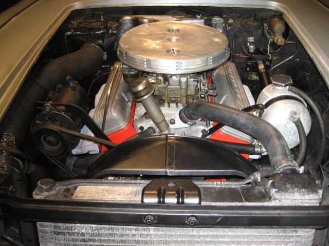

A few years ago I built a 389 (.060over 383) for my 51 Chevy and used an early Z28 intake with a Q-jet. It ran GREAT! But I've always loved the early 2x4/WCFB setup. When I installed FI on the 56 40yrs ago, I bagged and shelved the 2x4 setup and there it has set all these years. A few days ago I pulled the intake from the 389 (gotta replace a piston) and so I'm putting the 2x4 setup on it, with a Batwing air cleaner. We'll see what happens.

Although, I clearly remember back in the day when those were SUPER UGLY (and still are), and many guys with 56-57 Chevys removed them, threw them back in the corner of the garage (or behind the house) and installed cool looking, small chrome air cleaners.
Mine is one of the recent repos and it is next to perfect. I just had to have one. Just got it painted (black) yesterday. I also have instruction decals for each pot.
