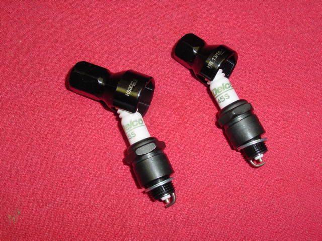

I have set of special plug sockets that look like this, for those really tight plugs:
https://www.toolsid.com/powerhouse/s...iABEgJqEfD_BwE
They are available in both 5/8" and the larger (13/16"?) size
Doug
I've had a set of those for many years - they used to be marketed as "HeaderSockets" - I had a close condition on my '69 Z/28 between the #5 plug and the steering gear, and they solved that problem.

I like those... Thanks for all the info everyone!
