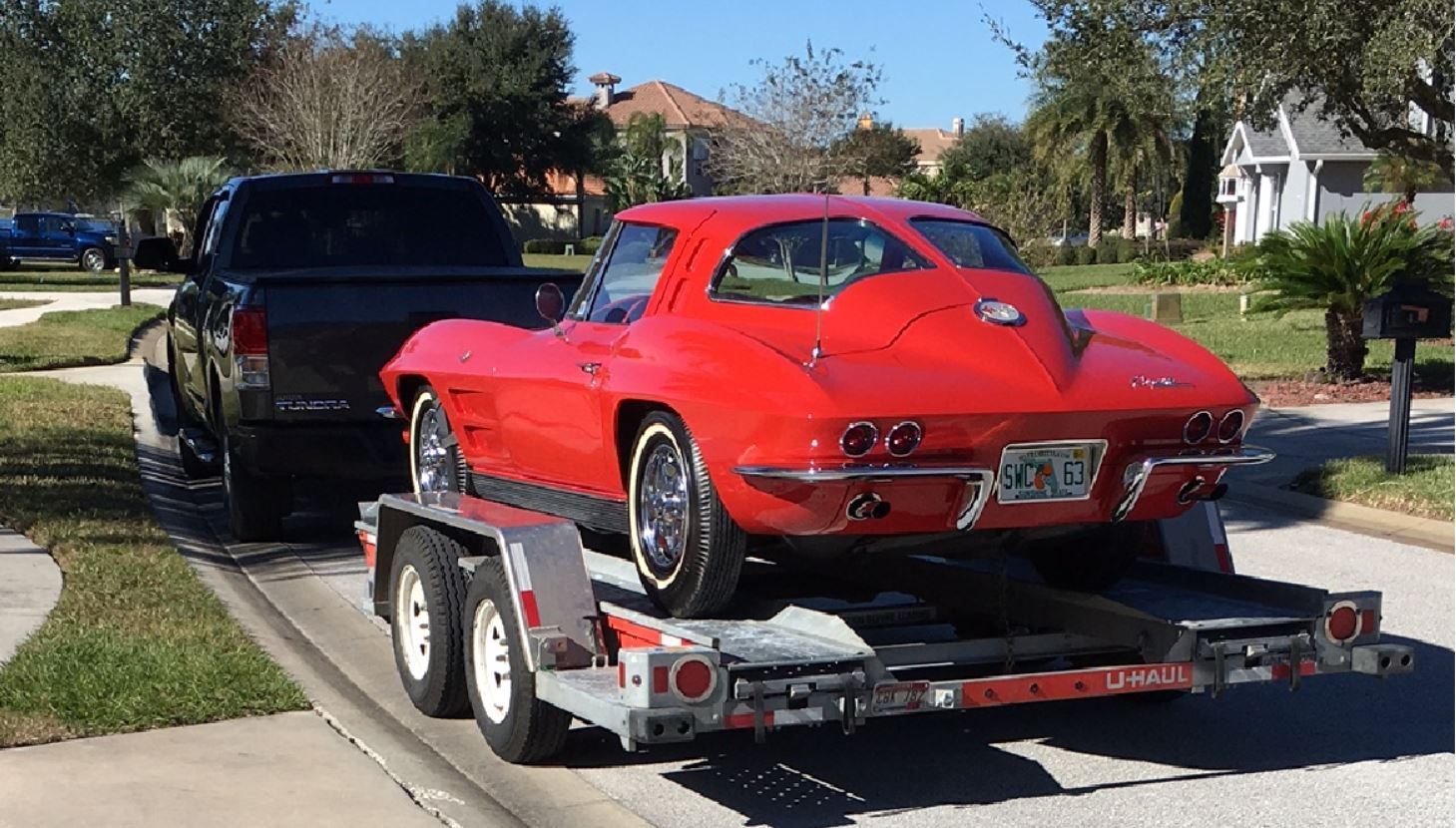

Originally Posted by Frankie the Fink
I do leave a bit of slack in both the U-Haul trailer chains - they are backup safety devices IMO....
Never had a car slip sideways on one of those trailers but I usually travel fairly nice roads. I did get stuck once (truck AND trailer with the 63 on it) in a sandy lot behind a Dunkin Donuts once. It took some pretty violent actions to get "unstuck", rocking the truck like mad and whipping the steering wheel around; even so the car stayed firmly in place.
HOWEVER - one of the tricks I mentioned is to pull the car onto the trailer all the way to the forward stops and set the parking brake. Then get the front wheel ratchet straps installed and barely snug. Then RELEASE the parking brake on the car (and ensure its out of gear) and crank a good healthy amount on the ratchet straps (you'll see the car pulled forward another couple of inches) - this nails the car completely to the front stops. Then RESET the parking brake. Otherwise, you'll usually find the car has some slop between the wheels and the front trailer stops after some miles and you'll feel it bumping a bit as you drive along...
Here is my normal rear attaching:
Chain appears double because it is longer than needed. Seems to prevent side creep.

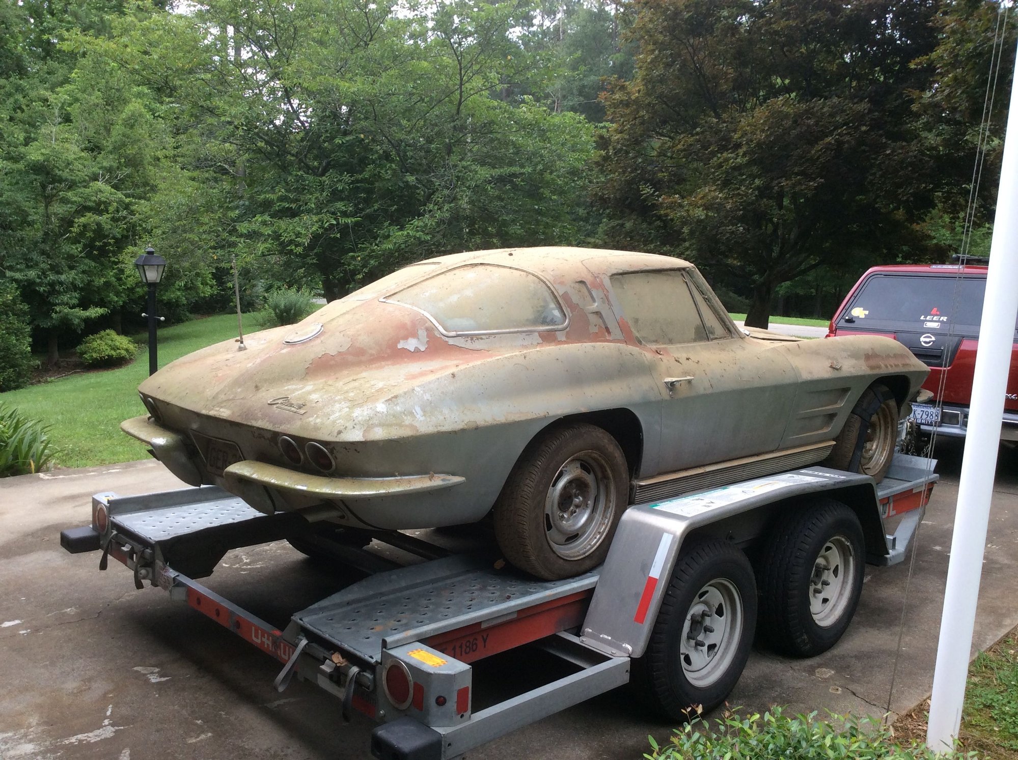

Another one in Richmond after a successful trip. Lots of pictures taken, thumbs up, horn toots, delays getting gas, but fun.
If you tow any C1 or C2 Corvette you're an instant celebrity, if you tow a split window you're also a traffic hazard. I've had people come up on my rear at 85mph, jam on the brakes to match my speed, roll their window down and try to talk about the car at interstate speeds...all while freight-training traffic behind them.... I've had picture takers nearly drift into the trailer too. I stay in the far right lane, do the speed limit and just try to stay out of trouble - with mixed results...
Apparently 20 years of dust can’t disguise!
Are you kidding ?
People love patina...no way that thing is not a show-stopper...
