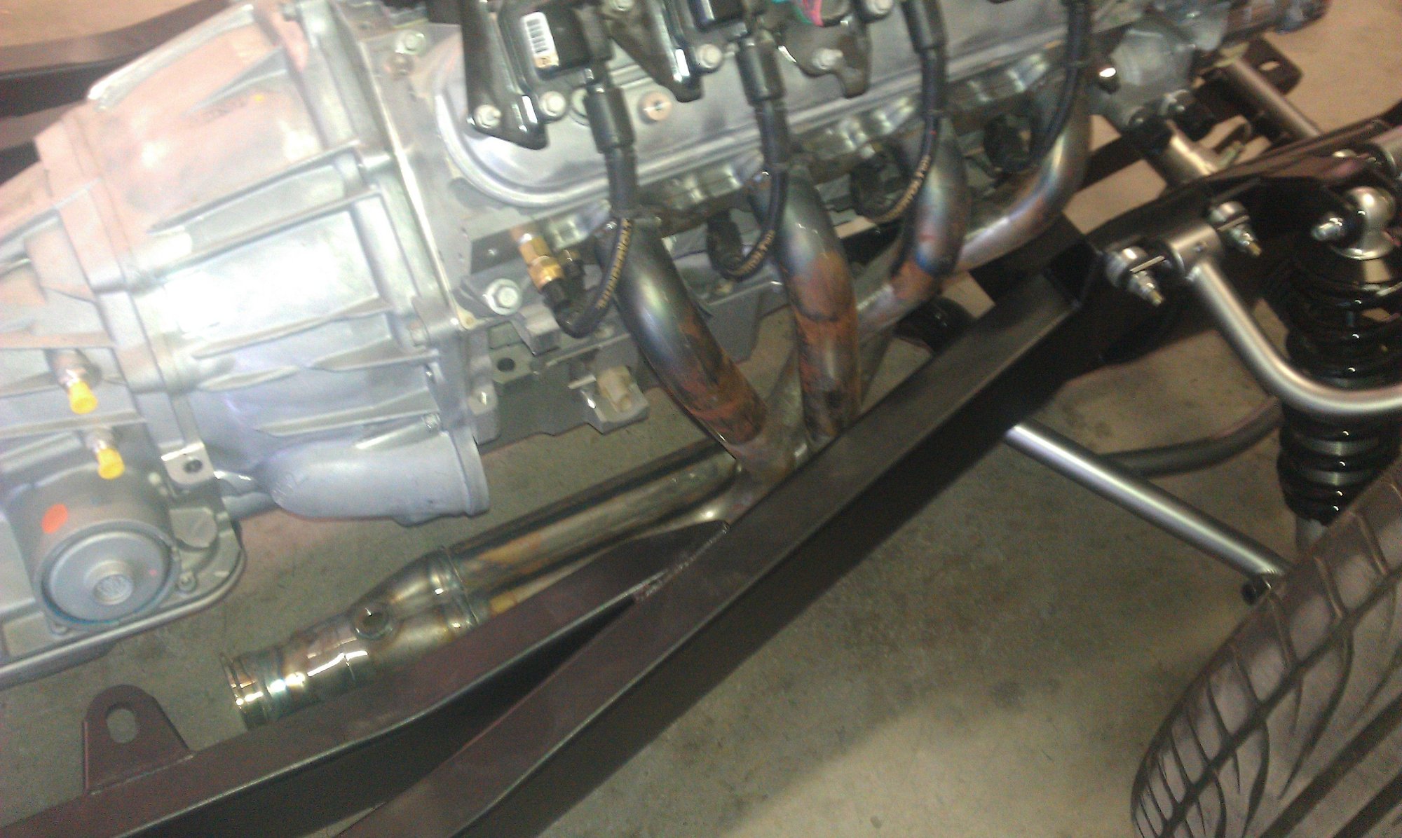

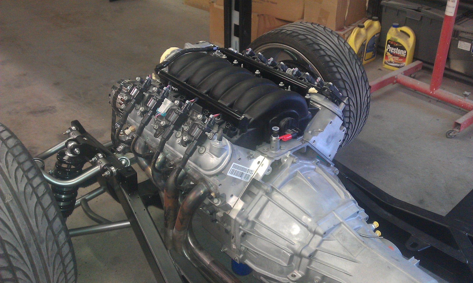

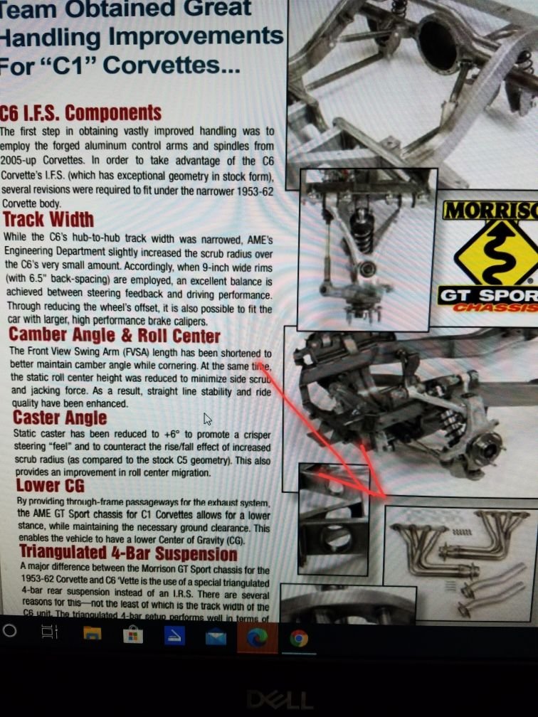

Robert,
We used Art Morrison's headers on our '59 with an LS3. I'm pretty sure they are 1 3/4"...
Paul

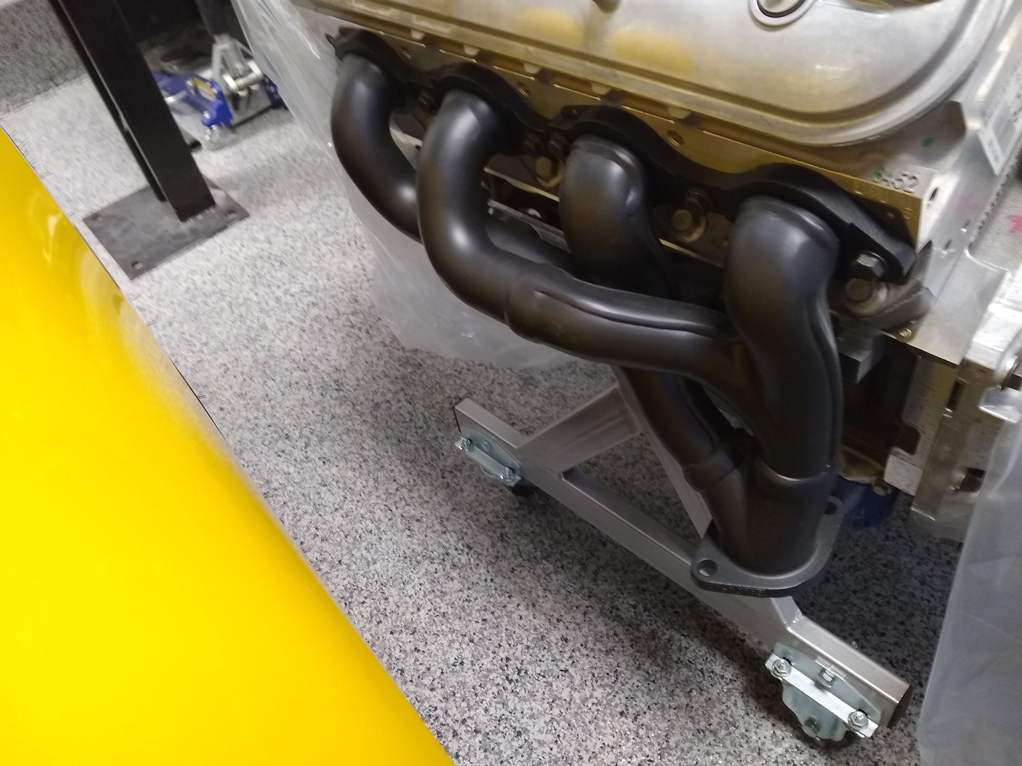

Ultimate Headers can probably make you up some AND they will fit your chassis. That is the route that I was going to go until I bought my crate LS7 that came with 2014- up Z28 Tri-Y hydroformed stainless shorty headers. They appear to be 1 3/4". I removed the shield mounts and smooth them out a little and then had them ceramic-coated and they look great.
​​​​​​ That might be something for you to consider as well.

I keep thinking the headers have to fit a C1 when in reality they have to fit a C4. Thanks for the responses and pics Wolfman. I should have tons of clearance.

Here are the LS7 Z28 Tri-Y OEM shorties. The primaries are 1 3/4". I haven't hooked up an exhaust system yet but I had this engine and end these headers in the car and there is plenty of room to make a gradual turn toward the back with ground clearance in the Corvette Correction chassis.
Joe
