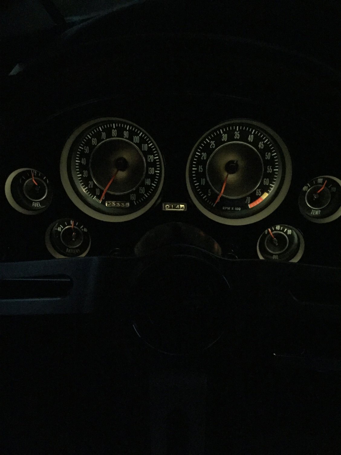

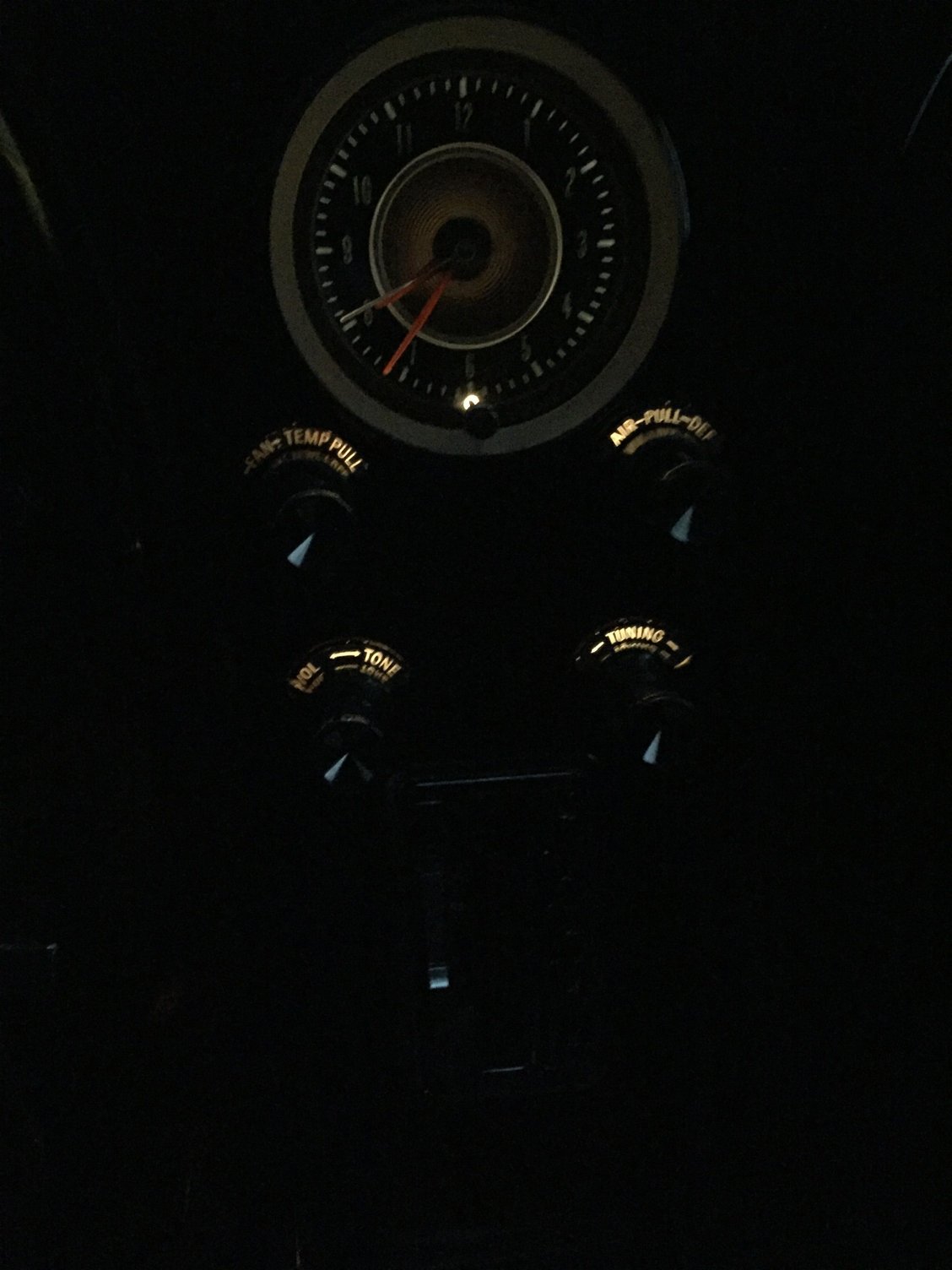

Although I rarely drive my car at night, the times that I did, I found that I could hardly see my instrument lights, especially the clock and radio-heater control *****, so I took the clock out and I found that the torpedo light at 6 o’clock wasn’t even working. I found out it wasn’t getting a very good ground so I cleaned the area where the light mounts at 6 o’clock and aimed it precisely in the middle of the 4 ***** and wells, it made a huge difference
