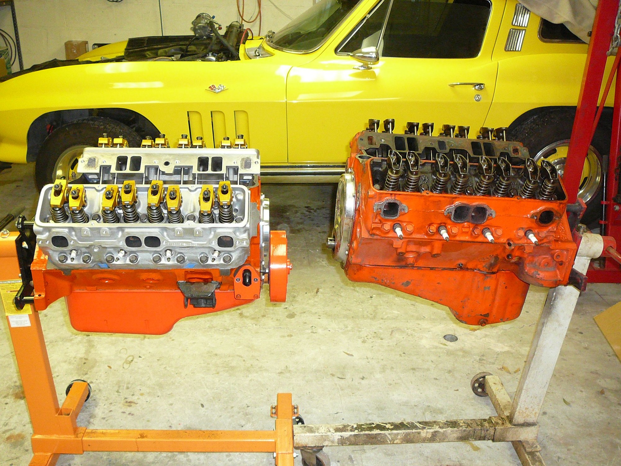

My local mechanic and former stock car racer had several 400s sitting in a corner and allowed me to pick any one I wanted. I consulted with Tom Parsons ahead of time and learned much about them. Two or four bolt doesn't really matter, just make sure to have it magnafluxed. There's no reason to use original heads and a good set of 327 heads will work fine. You can use original crank but it's externally balanced so you'll have to use corresponding parts. I ended up with more horsepower than I originally targeted but the torque is amazing, you'll love it!

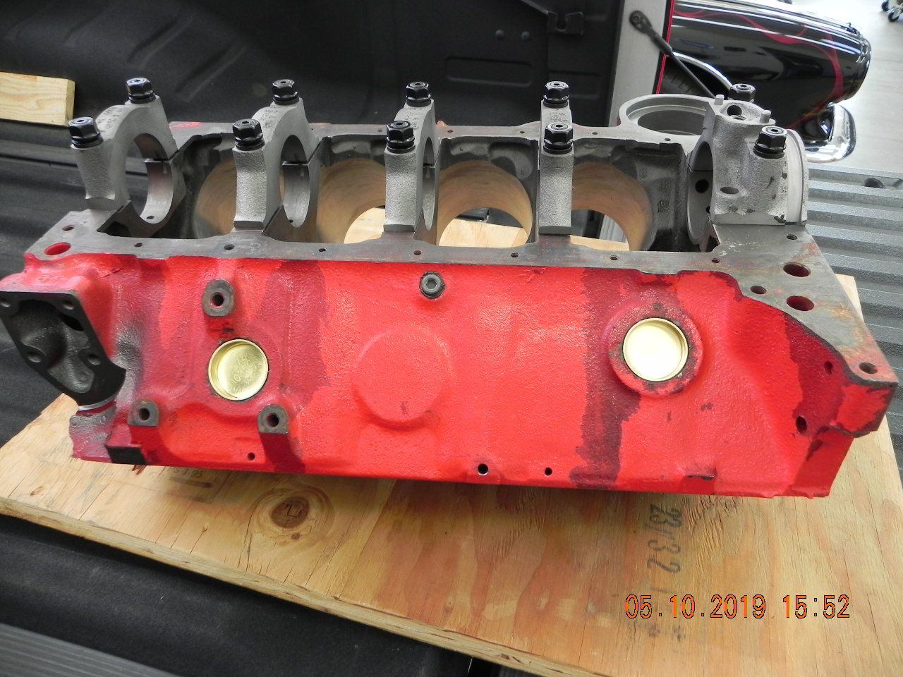

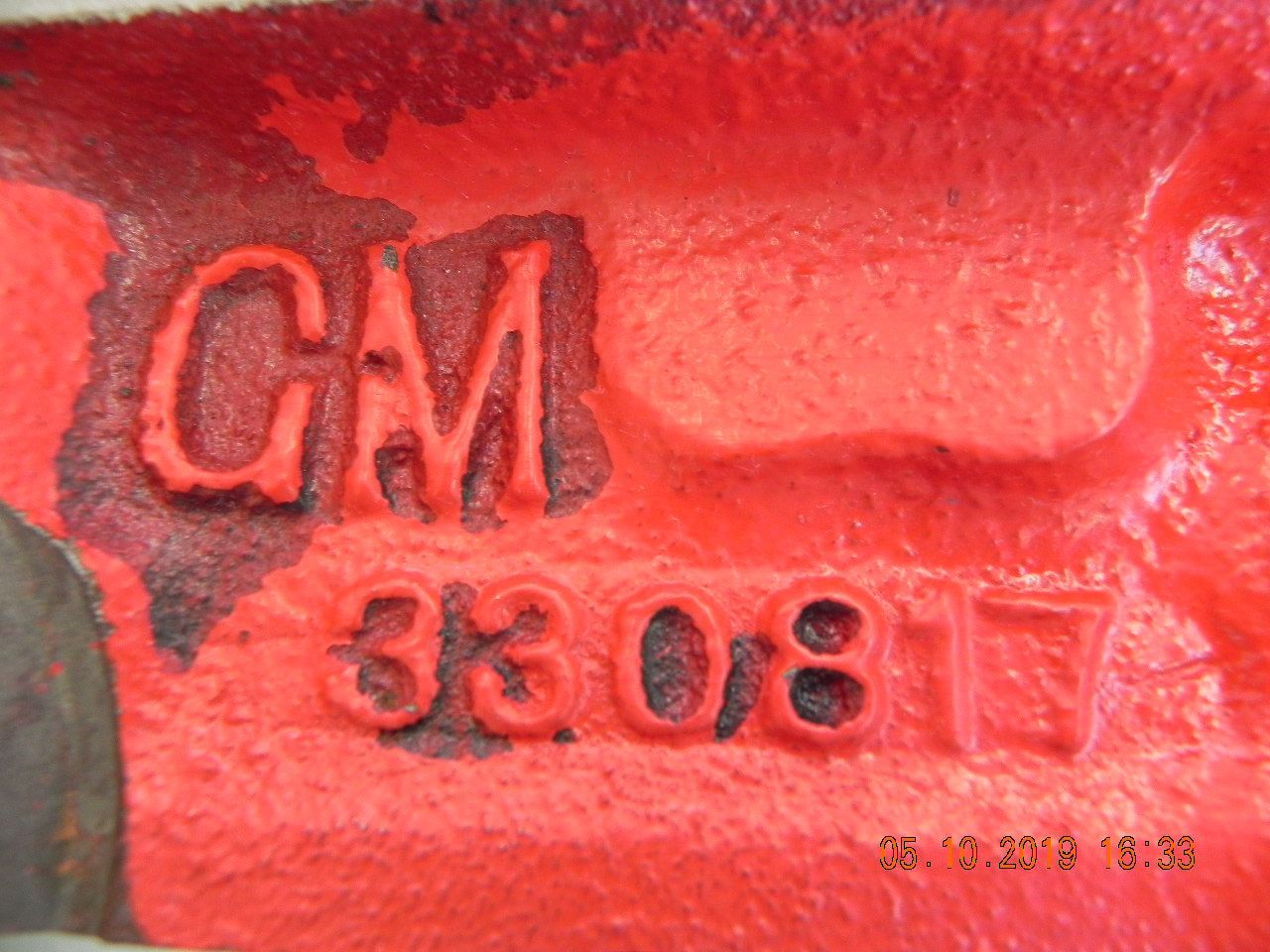

Last year I built a 400 SBC for my 56 Nomad. Scat and Eagle make fairly inexpensive rotating kits for the 400s.
Picked up a '74 vintage 400 block from a neighbor and I also thought all 400's came with '3' freeze plugs on the side of the block but as you can see in the pic, while there is a raised casting area where the middle freeze plug might be, in this block it was never cast with that third plug.

Out with old 327/350, in with the new 406/540!

From: Melbourne FL
Mike T - Prescott AZ
Your block looks nothing mine although I no longer remember what year mine is.

The 400 SBC was made between 1970 and 1980 and no doubt had a few variations in their castings. Besides my 74 vintage 400 having casting number 330817, there was also 3951509 and 3951511.

just curious what kind of heads are those, twisted wedge? Thx
