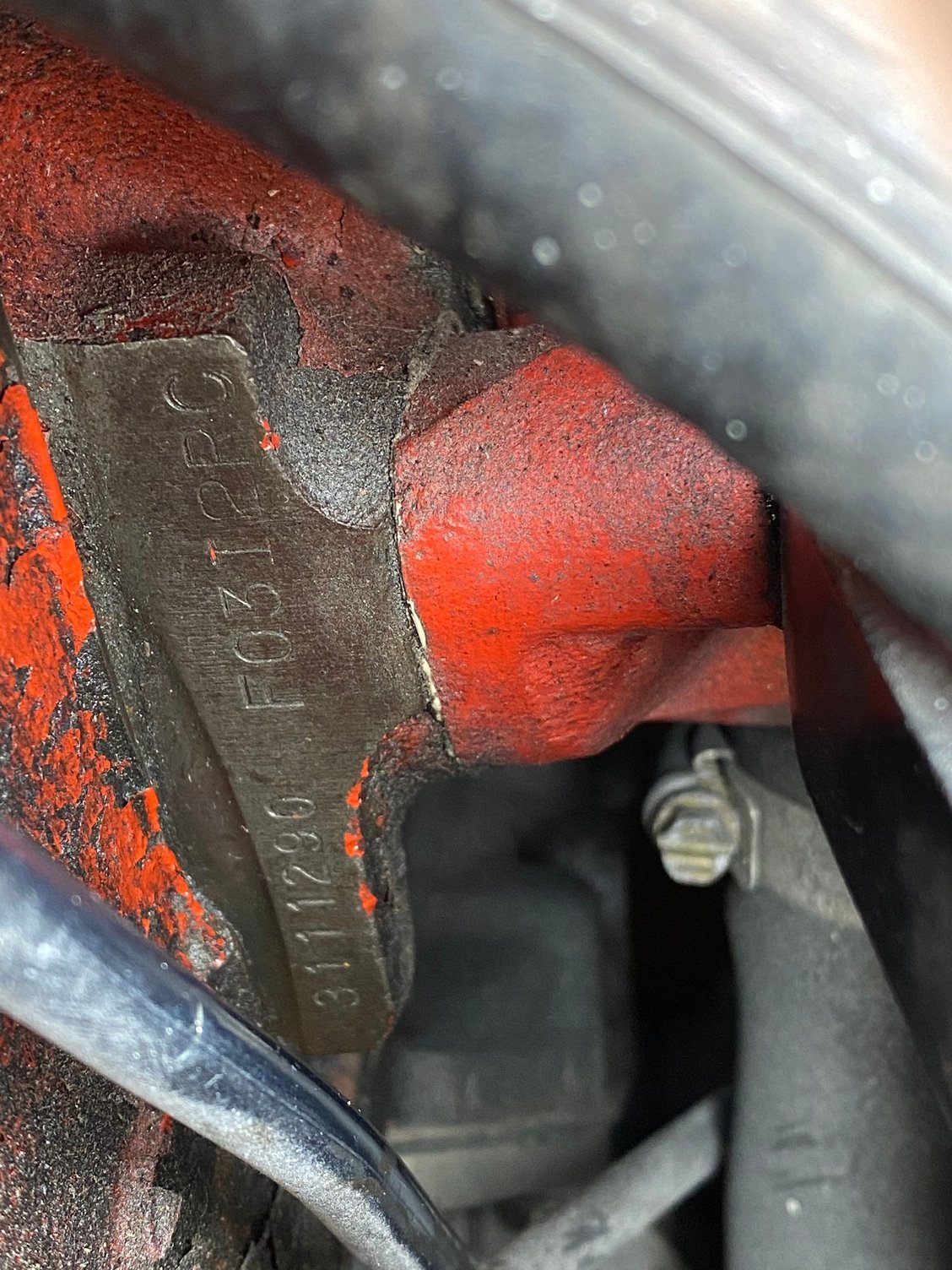

Whoa! I came to this discussion topic to find out if a block can be decked without destroying the original identification numbers stamped on it at the factory.
Two people that know more about rebuilding engines than I do have different opinions on the subject. Care to comment?

I would never do that on a Corvette for that reason. Watch the value go down the drain.

It is possible to deck a block without shaving the stamp pad, but not all machinists can do it, or care to try. Find somebody who gives you an iron-clad guarantee that they can before you let them have at it. Referrals from somebody who's had it done are strongly encouraged.
Here's the stamp pad on the engine that's in my '63. The block has been decked, but the machinist knew what he was doing, and had the proper equipment that allowed him to leave the numbers alone. Examine the photo closely, and you will see where the circular cutter stopped short of the numbers.
Live well,
SJW

The old style mill was a StormVulcan 85B I had one and operated it for years. You could do it but you had to be careful. Many shops now have a CNC machine for block work. It bores the cylinders in precise location and can easily deck the block and not touch the numbers.
