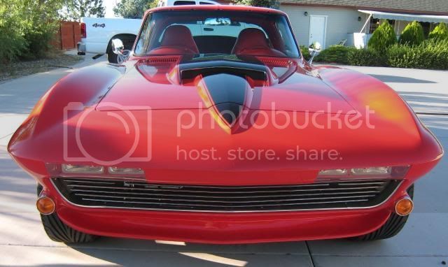

Originally Posted by Factoid
Thanks, Joe, this is exactly what I am looking for! You even have the same hood and painted the same color. Any other pictures of this beauty?
This is a great look I too would love to see more.

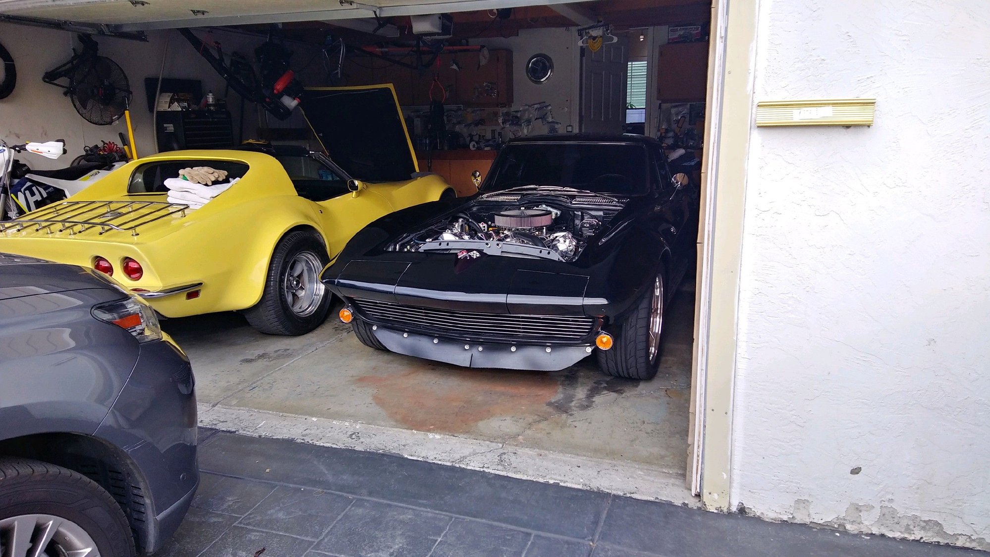

Here are some pics Ecklers

All the cars look great with the front spoilers. Dynamic corvette makes both carbon fiber and regular fiberglass spoilers. Two sizes are available and they fit quite well. Check out their website. Don’t make the task to difficult.

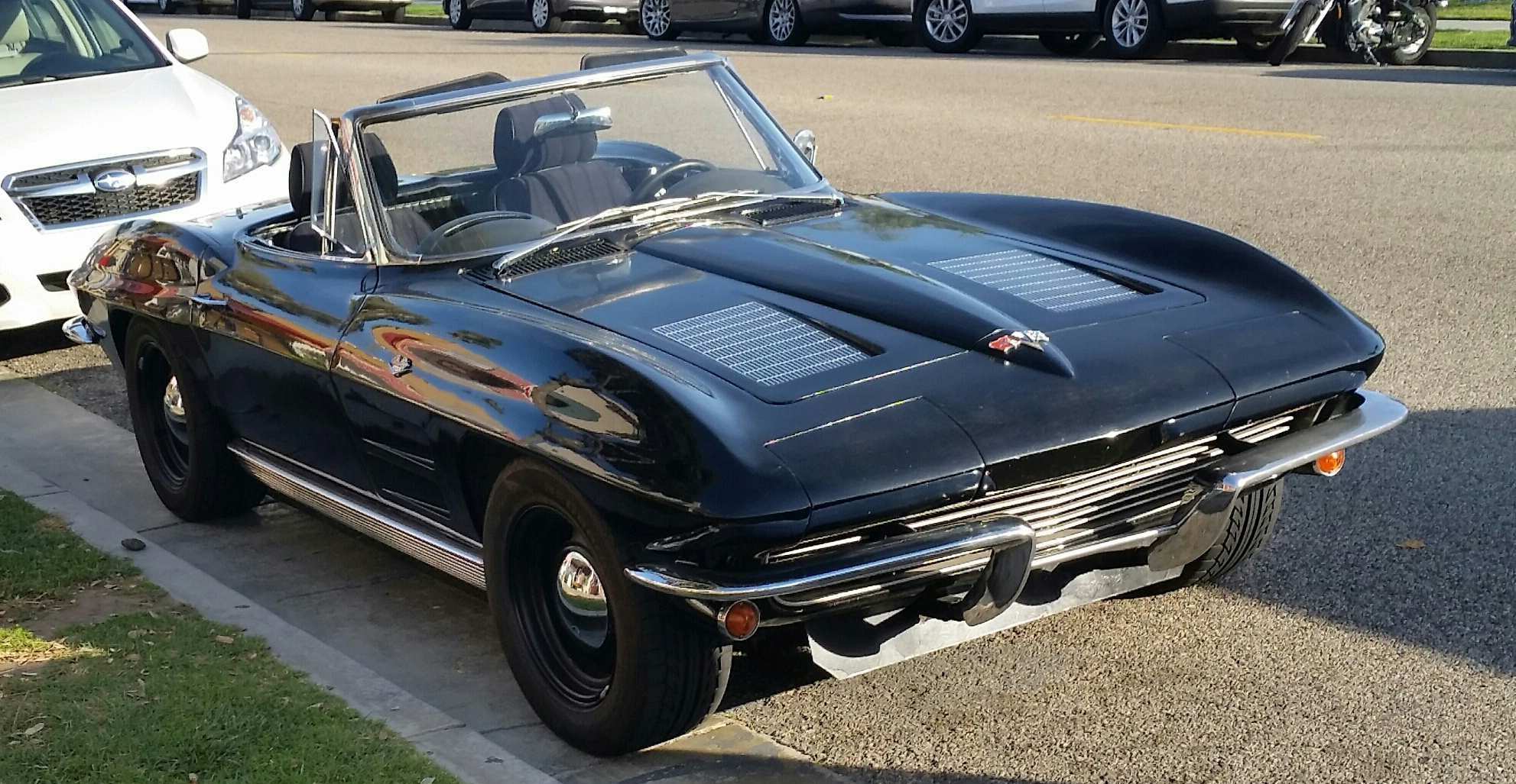

heres a simple one on my restmod from ecklers .
