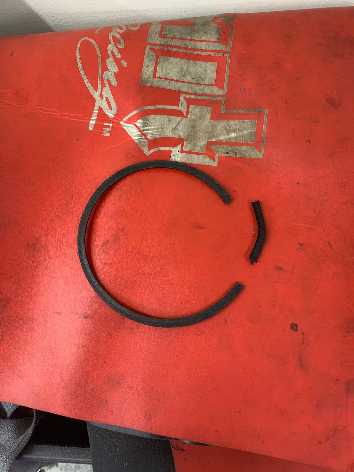

I test drove my car today without the air cleaner after a garage tuning session. I made couple of spirited runs and during WOT my accelerator stayed on he floor. I assumed my linkage had stuck but I had left the cleaner gasket on the carburetor and it was “eaten” by my carb. When I tried to pull it out a piece broke off and fell into the intake. Had to take carb off on side of road and retrieve the piece. Luckily it had caught in the butterfly. I know dumb but fortunately a good lesson and not expensive repair. Jim

When I rebuild my C2 on one of the first test drives the throttle stuck for a moment.
Made for an exhilarating shift to second gear.
Found out I had installed the throttle rod backwards. (Threaded portion to the front)
It goes to the back on the Corvette. The extra rod was hitting the bottom of the air-cleaner at full throttle.
Never made that mistake again.
