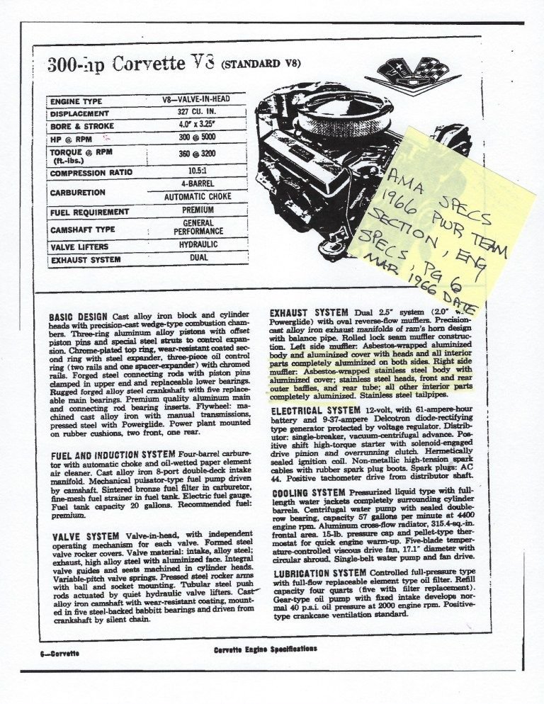

Originally Posted by DansYellow66
I don't ever remember noticing any difference in material or gage thickness on older cars between head pipes and tail pipes. Newer cars with Cats may be another story.
Seems I remember some factory dual exhaust systems from the 60s/early 70s ran a right side muffler with SS innards (not sure about shell) due to moisture collection and corrosion from the heat riser. But I can't remember where I read that or what make(s) it was in reference to.
Old Jan 22, 2021 | 04:09 PM
Armedanddangerous's Avatar
Armedanddangerous
Joined: Jul 2018
Posts: 429
Likes: 85
I'll be dammed. Learn something new every day.
Old Jan 22, 2021 | 06:46 PM
DansYellow66's Avatar
DansYellow66
Joined: Jan 2003
Posts: 17,653
Likes: 3,663
From: Central Arkansas
Thanks vark_wso, that is apparently what I was remembering.
